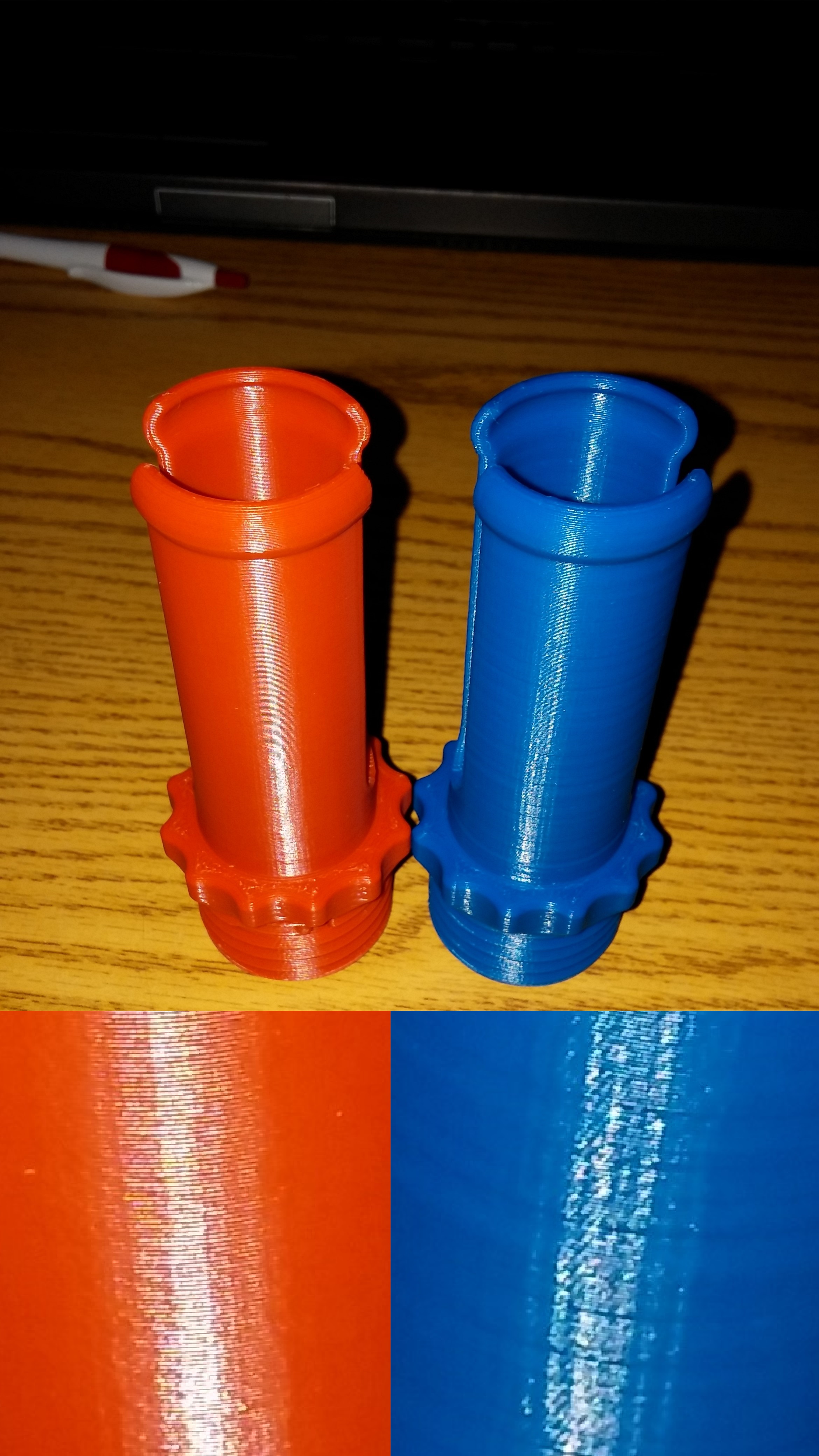

I picked up a few spools of gizmo dorks filament, 1 HIPS, 2 ABS. I haven't started into the black ABS yet but ran through the full spool of blue.
Overall I haven't been very excited about it. it did print ok but for some reason the surface quality is very poor. It has ridges every 10 layers or so where I swapped out to some Matter Hackers ABS on the same program and it turned out beautifully. The GD filament strings quite a bit. I ran it as low as 225 and as high as 235 where I run my other ABS filament and strings and slings goobers.
Its cheap filament but I'm hoping to find another relatively cheap filament that is high quality. I'll happily pay an extra $5 per spool for better quality!
The part in blue is Gizmo dorks and in red is MatterHackers regular ABS. see the pic full size - smooth finish in red, bumpy in blue.

I wouldn't fully discount Gizmodorks filament, its decent for the price. I had 3 spools of the stuff so I threw in the yellow and printed 1.25lbs(large print), now I have black in to print the same thing(another design iteration), the yellow one came out pretty good, less stringing than the blue one, however the nozzle is only hitting 230C for some reason. Color looks pretty awesome - its Lemon Yellow.

Quick update - I cracked open the spool of black GD filament - its pretty gross, printed the same part as I've been printing(got 6 13" tall parts, 17-32 hours a piece depending on settings), blobs and holes moisture holes all over.
I've been printing more of the yellow - I really like the color and it does print nicely.
