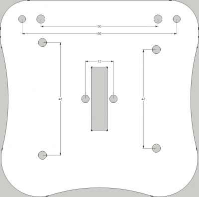

Hi all, I'm trying to create a set of carriage mounts for a custom arm solution for my printer, and I'd like it to mate with the existing cheapskates. The only problem is I can't find the CAD files to esure I get the correct geometry for my MAX V2! I tried importing the Orion files, but they all give me errors in solidworks (apparently importing IGES formats exported by certain CAD programs is problematic). I was wondering if the team made these in Solidworks and could post those CAD files?

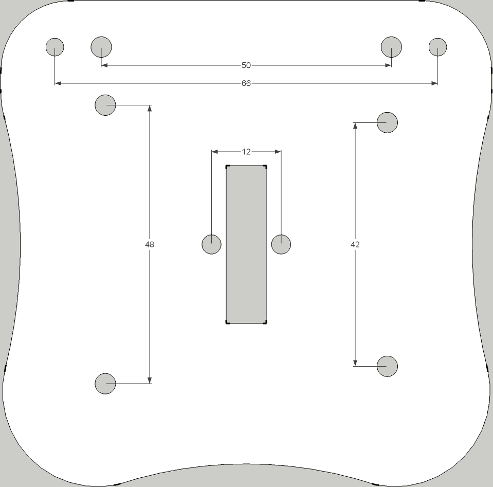

This is from my sketchup version of the RMV2. The pieces are a direct import of the hosted files.

Forgot to mention, if you want to keep the original dimensions, the center of the u-joint axle is approximately 16mm away from the cheapskate face.

Sweet, thanks! I tried eyeballing the distance after a pair of calipers I had wouldnt bend far enough to take the measurement, and got 50 and 65, and had to trim some of the plastic on my effectors away. I'll be using this as a guide from now on, do you have the diameters of the holes btw?

jarek319 wrote:Sweet, thanks! I tried eyeballing the distance after a pair of calipers I had wouldn't bend far enough to take the measurement, and got 50 and 65, and had to trim some of the plastic on my effectors away. I'll be using this as a guide from now on, do you have the diameters of the holes btw?
50 holes are 3.55mm (as are the 4 for bearings)
66 holes are 3.07mm
that's the measurement pulled from the digital file, but the laser kerf obviously makes the holes slightly bigger.
