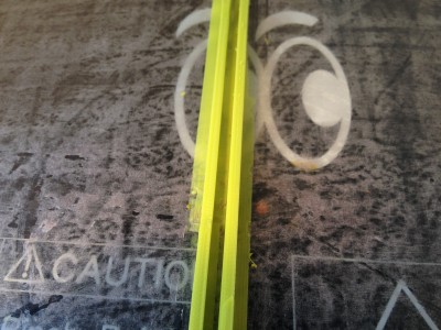

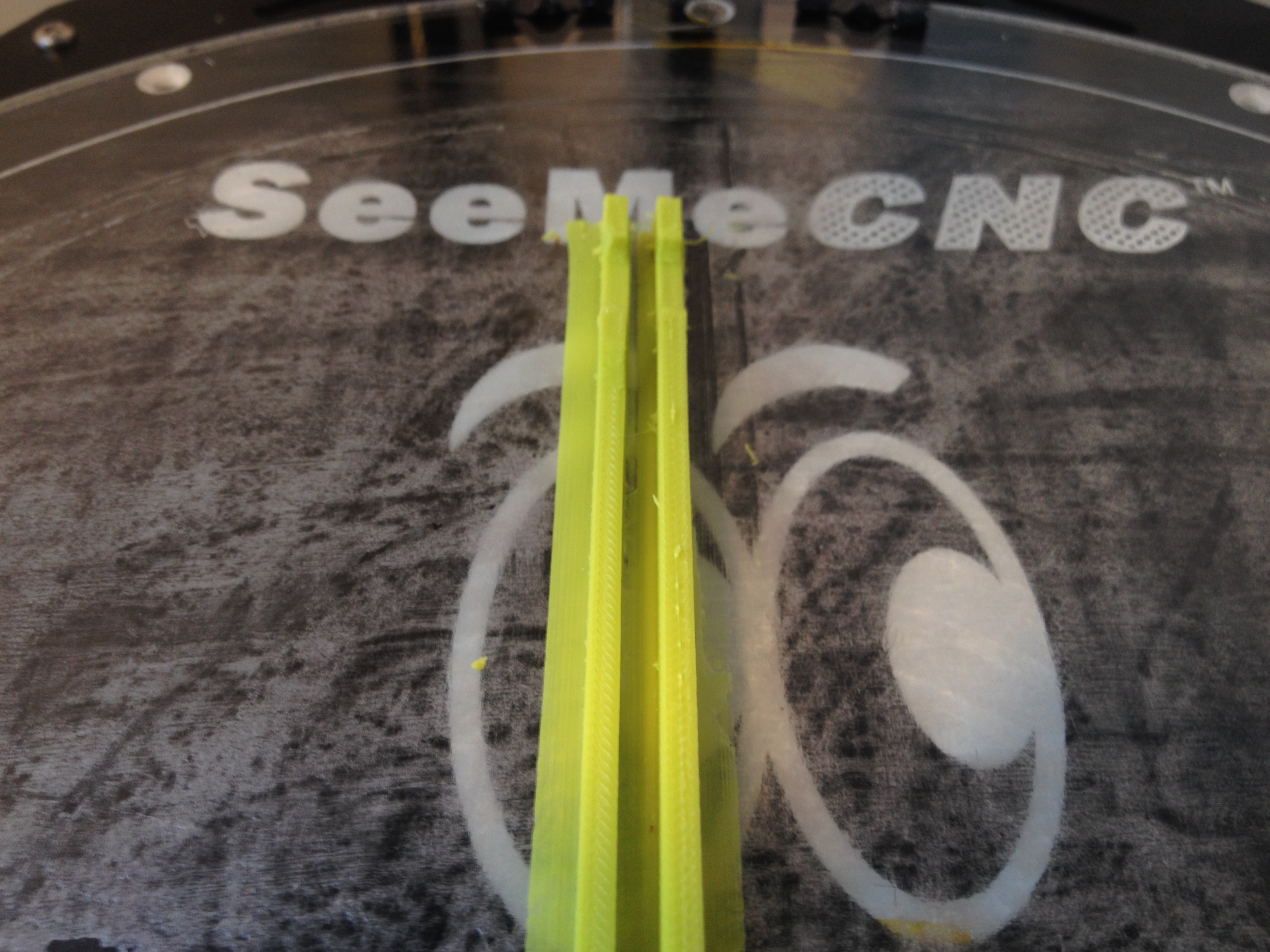

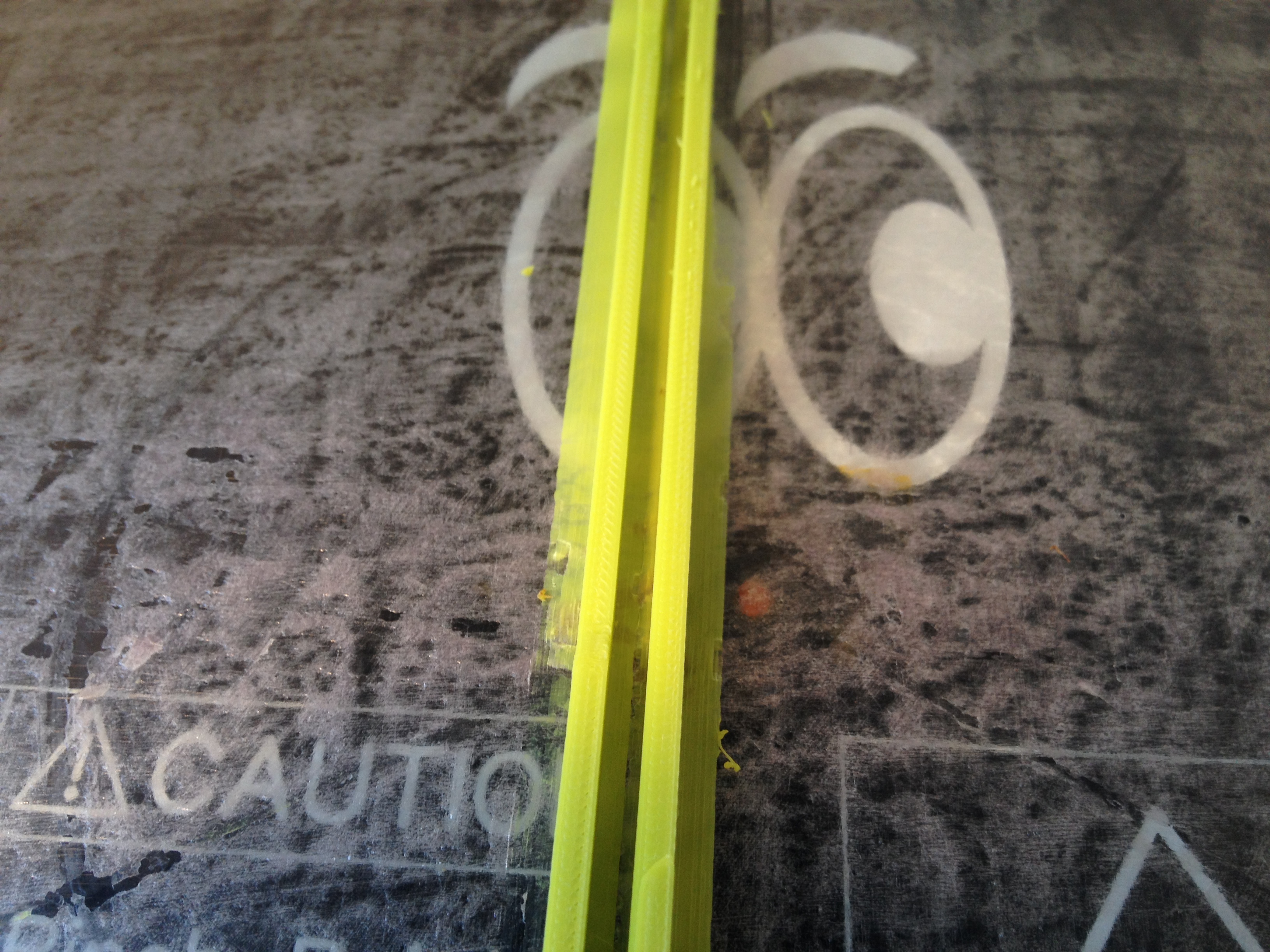

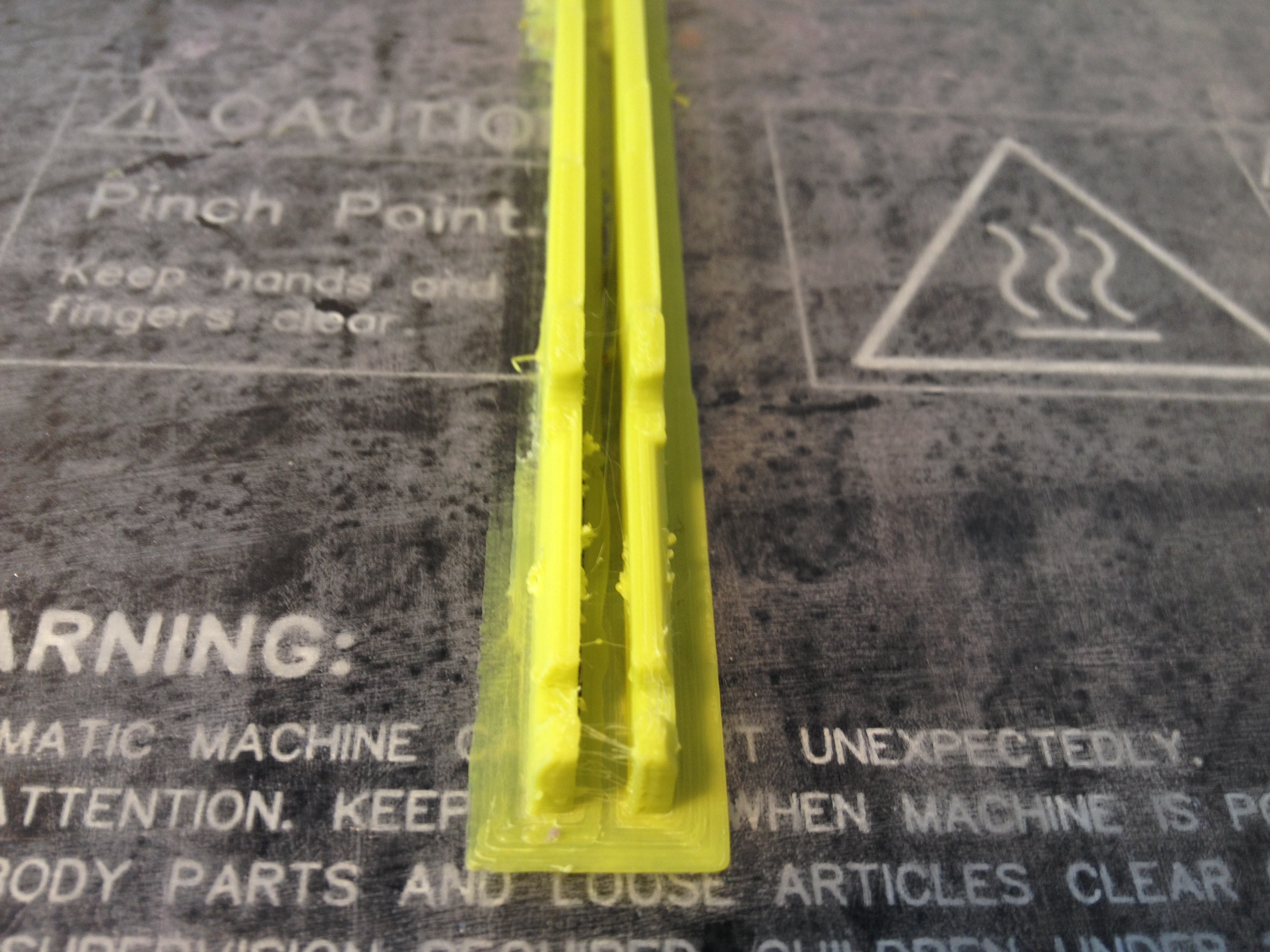

I've noticed that most "low" or "high" spots on the bed are actually produced when a tower (or a combination of towers) changes from moving down to moving up or vice versa.
Here is a a series of pictures that illustrates the results. Look at the brim, how on one part it's too squished into the bed, and how it's exactly related to the direction a tower is moving. Is this a belt tension thing? It's pretty consistent to each tower.

Then you have something "loose" or binding somewhere. It's what backlash looks like on a delta.
I would start by checking the UJoints on the effector all move freely.

The u joints all move easily. They are the acetal variety. I also have tension on the arms. I'm starting to suspect my belt tension is too loose as I previously had thought it was too tight and loosened them all off. I wanted to get some more thoughts before I adjusted anything. I agree that there is "backlash" somewhere, but I'm not sure if it's in the u-joints.

You can usually see backlash in the carriage motion, write some GCODE to just move the effector up and down, watch the carriage and belts, put you finger on the drive pulley and watch them again.

So I checked my stepper pulleys. Rock solid. I removed my arms to adjust the cheapskates...
Hahahaha... oops. Again. It's always oops. They were rattling around they were so loose. (didn't seem so loose with the tension of all the arms on them).
I'm sure this will be it. I'm also tightening the belts a touch.
Thanks for the pointers... should have just checked myself. I was having too much fun printing (it was still doing pretty well).
