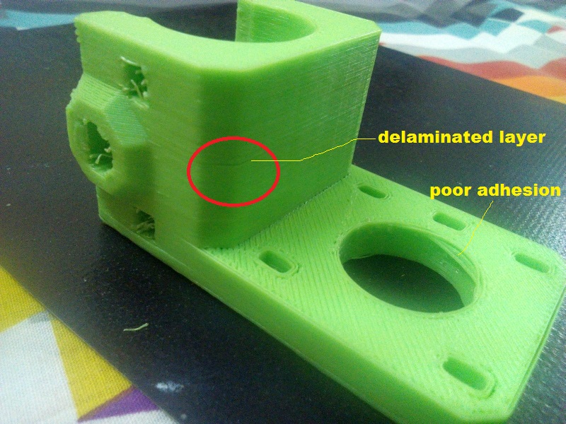

What the hell i was doing for the past couple of week I ordered two roles of PLA filament from two different vendors from China and one role they send me ABS instead of PLA.... I was printing with that at PLA temperature and what i got poor printing quality with cracks in the layer... I just watched the video today that gave me a Lit-miss test of PLA and ABS... You must watch... http://www.youtube.com/watch?v=zqanb6mH-xU

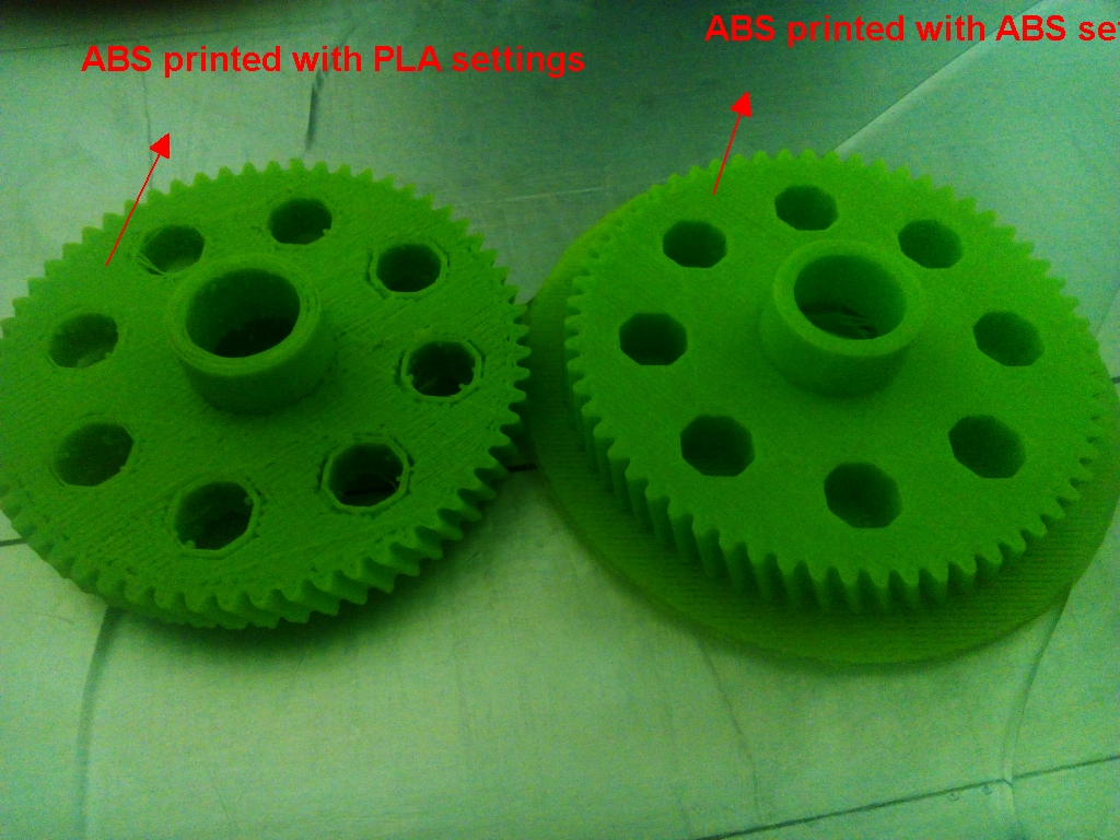

I tested both of the filament and found that the Green filament is actually the ABS ...what a shame....Bumped the bed temperature to 80C - My ordinary glass shattered but still i am getting good prints. Furthermore i used 230C to hotend....
Please always check your filament before start printing.
Been seeing alot of mis labled filament. It even got one of the leaders of the forum about a year ago. I like the simple burn test method, pla burns nice and clean with a blue flame, abs is a black smokey flame.
