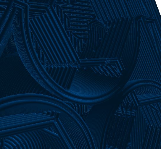

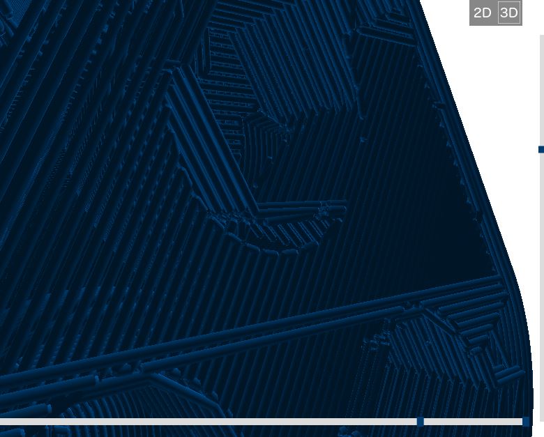

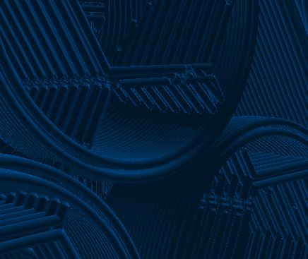

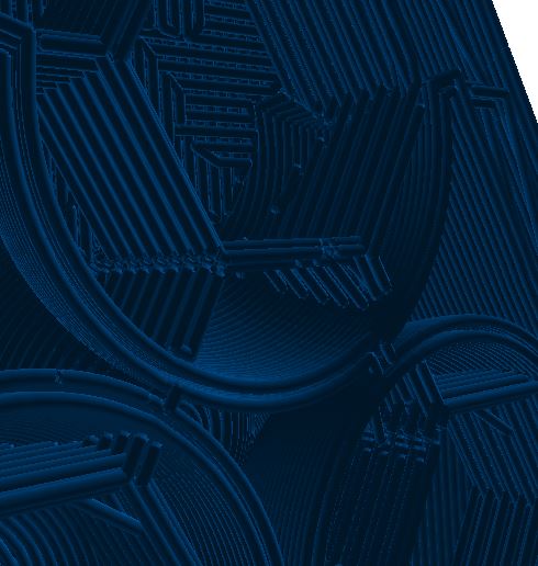

I also sometimes see Matter control telling me my model has many times the number of layers that it actually has (in the thousands), and if you step through the layers with the built-in viewer thing you can see that it is counting the peremeter as layer 1, the left foot as layer 2, the right foot as layer 3, and so on. like the layer number goes up by one after every retract operation.
It still prints fine. I can't remember if that is CURA or matterslice that does that, but I think it is only the one slicer.

I've also seen the same thing regarding the "thousands of layers." I don't know why it does that but it doesn't seem to affect the print, so for now I'd write it off as a cosmetic bug that will probably get fixed sooner or later; after all, all this software is still under active development.
