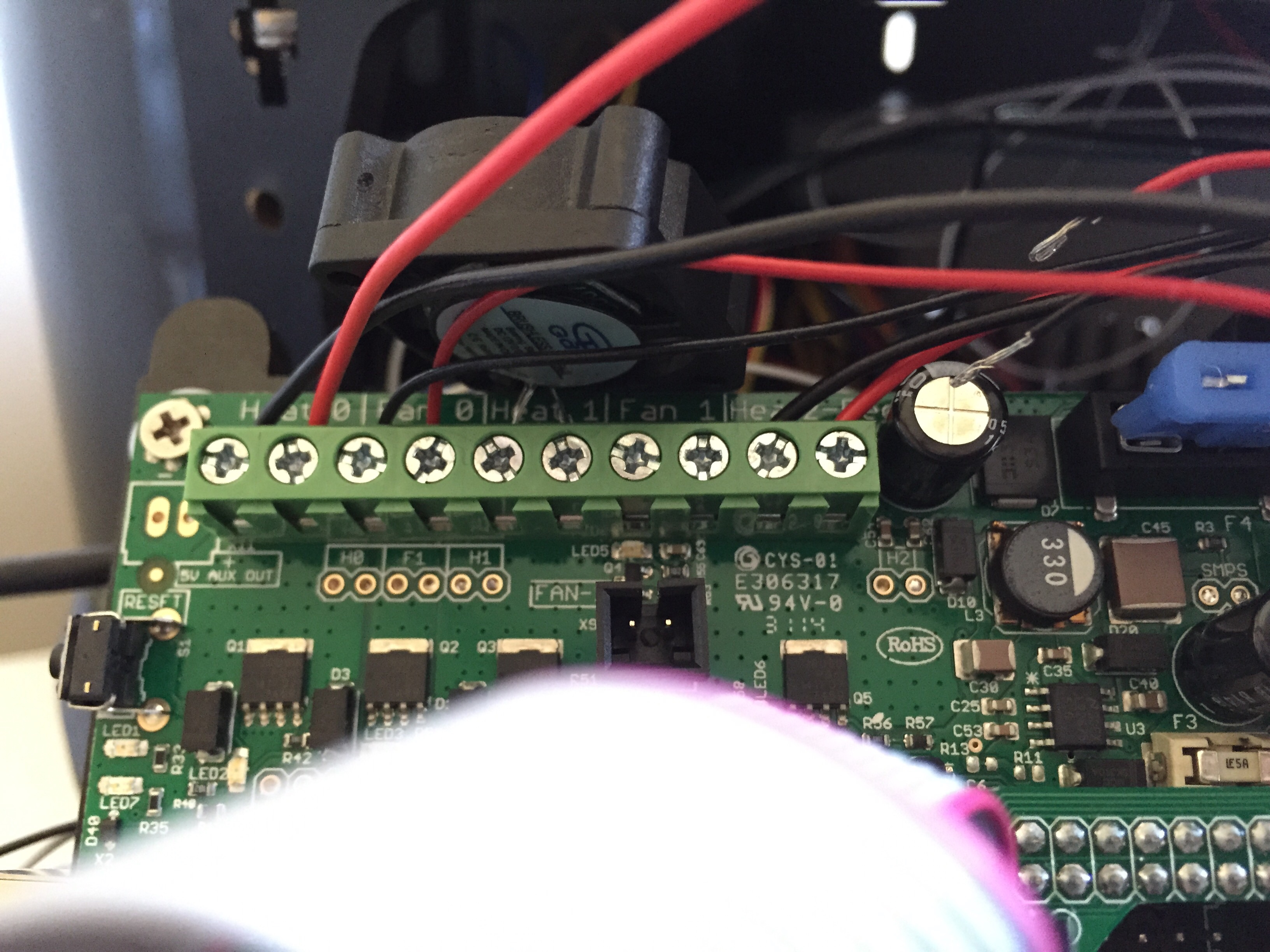

It seems like if it's not one thing, it's another. I spent two hours calibrating the machine and printed the fan shroud and it came out brilliantly! Now, I've hooked up the fan shroud(my nozzle looks crooked which I imagine will be fun to calibrate) and now the fan isn't working. I understand the "coolness" of having a piece printed by your machine for your machine, but I'm going through the hassle of disassembling, undoing work I've done and now it isn't working properly. I hope in the next iteration of this machine, they ship it with all the parts you need, and let the folks who want to customize and add-on mods to the machine, print the pieces they want. I've spent well over 20 hours on this machine and still not ready to print.

Did you figure out what was wrong? What I would have done was run a wire pair along the arms until I felt like actually making it really purty. Right now I have a PVC pipe supporting the water cooling lines and wiring for my Kraken hotend
Re: First Build frustrations grow
check the G code and make sure you see this (m42 s255 p6) this is what turns on the peek fan. and make sure you have it pluged into the right spot

I wouldn't tear the machine apart to troubleshoot a fan issue. First, did you mark the set of wires used for the peek section? if not then you could have them mixed up with the layer fan.
Also, do what was mentioned above in regards to running a temporary set of wires just to make sure you don't have a defective fan or somethings wrong with the crimp/solder job.
As for printing the shroud or having it provided for you, that wouldn't change the fact that your fan doesn't work and you still need to troubleshoot the issue. and believe me, this wont be the last time you tinker with your machine

DavidF wrote:check the G code and make sure you see this (m42 s255 p6) this is what turns on the peek fan. and make sure you have it pluged into the right spot
Where would I look to find this?

All of the fans were marked and I've just double checked the wiring go down. I guess this is why one guy said it's a good idea to test everything and test power before building up the whole machine. I don't know if I have any spare wires to test the fan, but I'm guessing the fan. I've already had a failed power supply.

I have continuity between the wires, so I'm guessing it's a bad fan. Is this a fan I can pick up at RadioShack?

The wire looked pinched due to the tight fit. I stripped the wire and plugged it directly into Rambo and voila. Heading to pick up a fan now. My fan shroud appears to have a slight angle to it. Like gradually as it printed it shifted to the right. Could this be because the horizontal radius is off?
