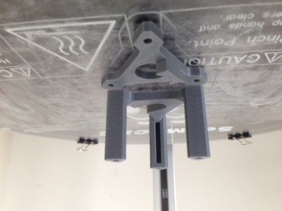

I have made a few changes to suit a standard hotend and ABS and I am impressed with the printer output now :)
E3D Mounting
E3D Mounting
Hmmmmm, Upside down.... Click the piccy to see it right side up :)

Well, you are Down Under! I just assumed that is how you print down there :)
Looks great!
