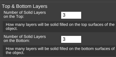

I have got the machine running and it's been printing ABS great. I have noticed if I power it off, I have to go through the whole calibration with the Tower Adjustments, my X Axis screw is as high up as it can go now. That's one weird issue, am I not saving something right?
Missing the Top Layer on prints. I don't know what could have changed(pretty sure I didn't request to leave the top layer off) but every print now is missing the top layer of the print. Any clues on what setting these things could be? Thanks for the help before with the failed power supply and failed fan! Thanks to Kevin for printing me a Peek shroud fan that worked brilliantly.

What slicer are you using? and what do you have the top layers set too?

Using Matter Control and have it set to 3 layers on the top.
