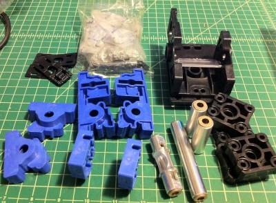

Hey all,
I received the plastic parts and brass bushings (Thanks John!), but I can't even begin to imagine how they go together.
Anyone have instructions or maybe know where to start me in the assembly/upgrade process?

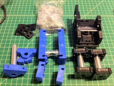

Here are a couple photos of the items I received today. The bag is full of bolts, nuts, bearings, etc.
The rest is pretty self-explanatory, I just need what part goes where, I believe that the parts here are for both X and Y axis upgrades plus the extruder upgrade (glass fiber reinforced plastic).

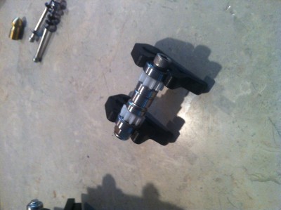

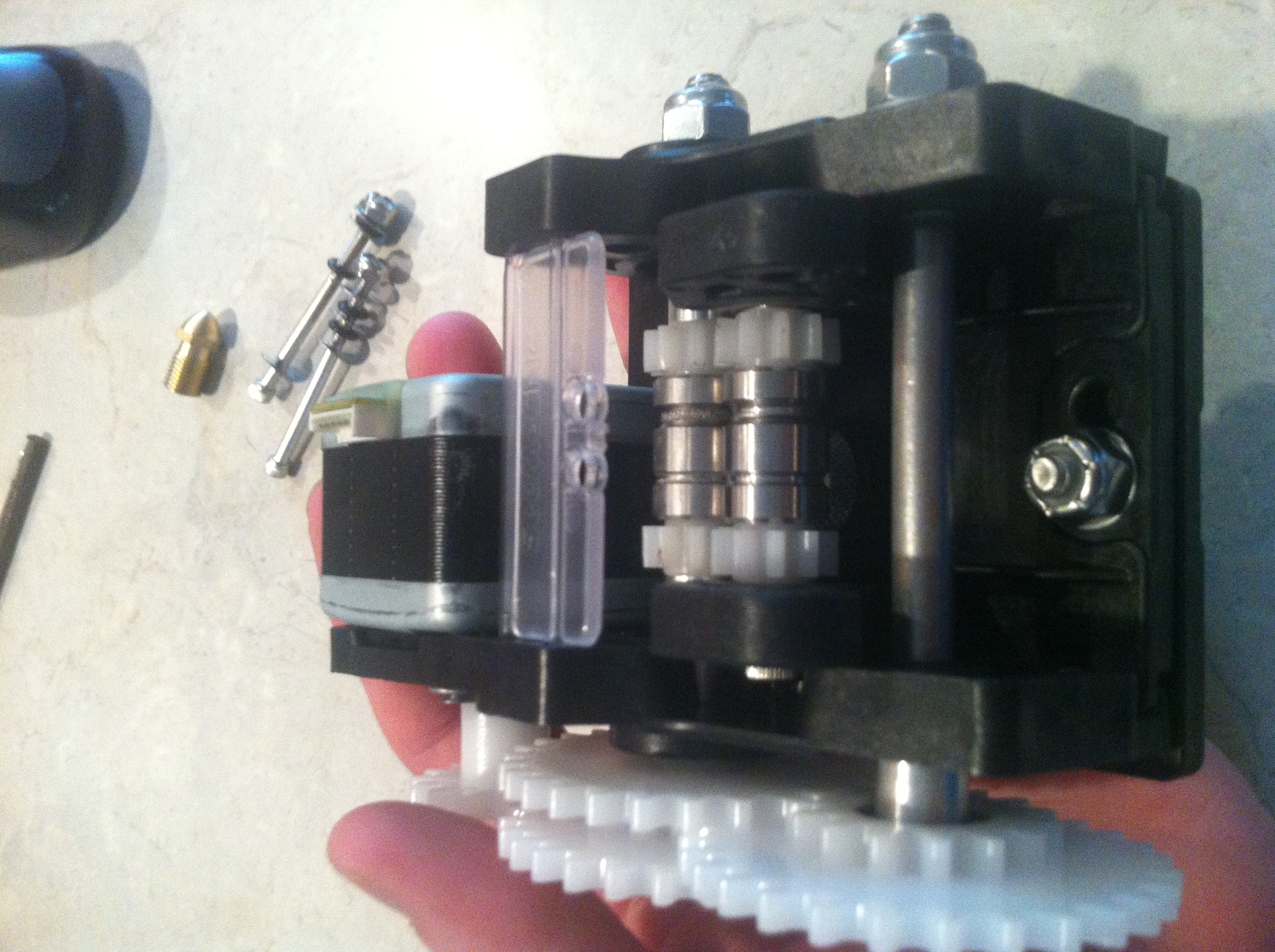

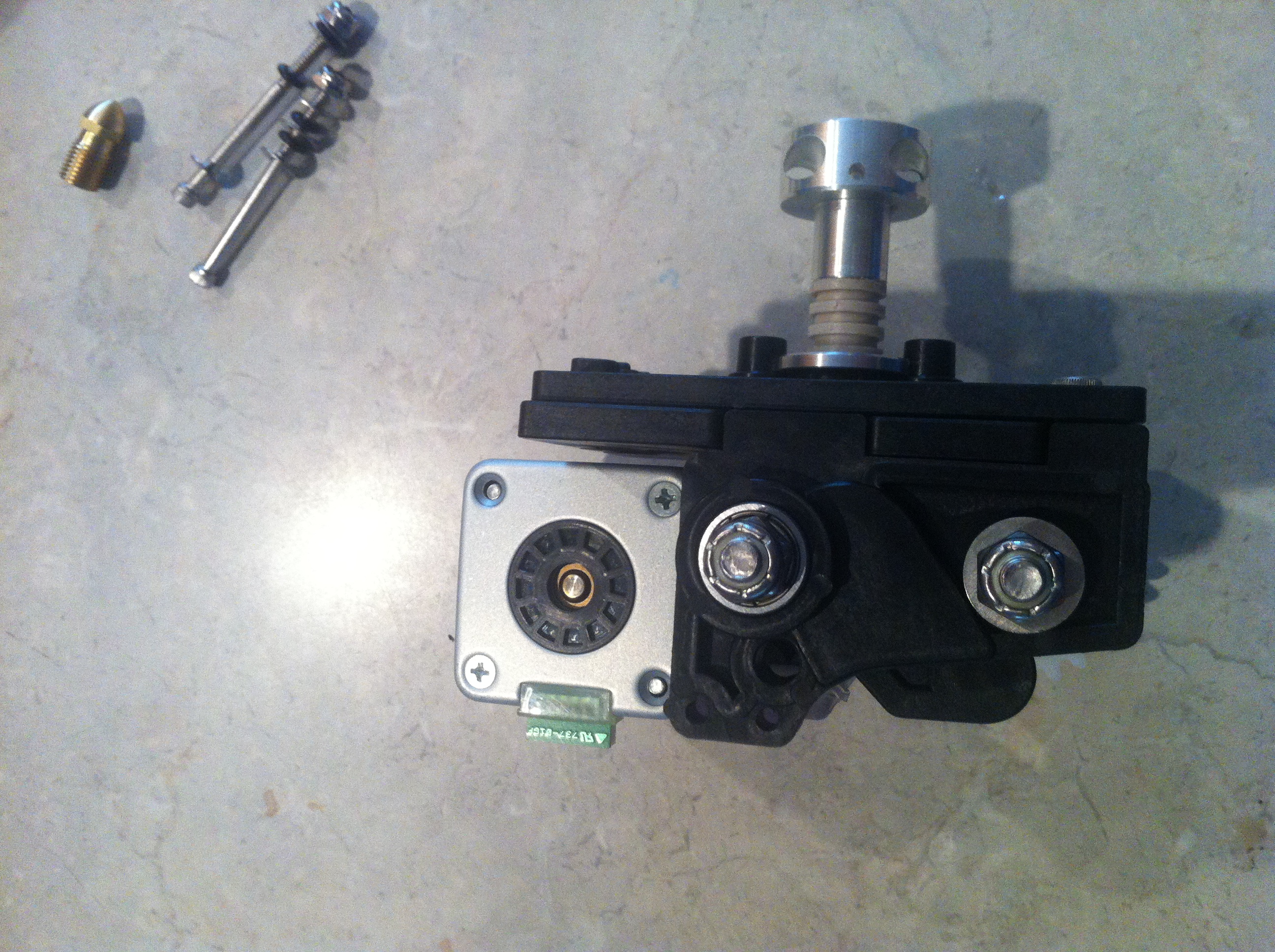

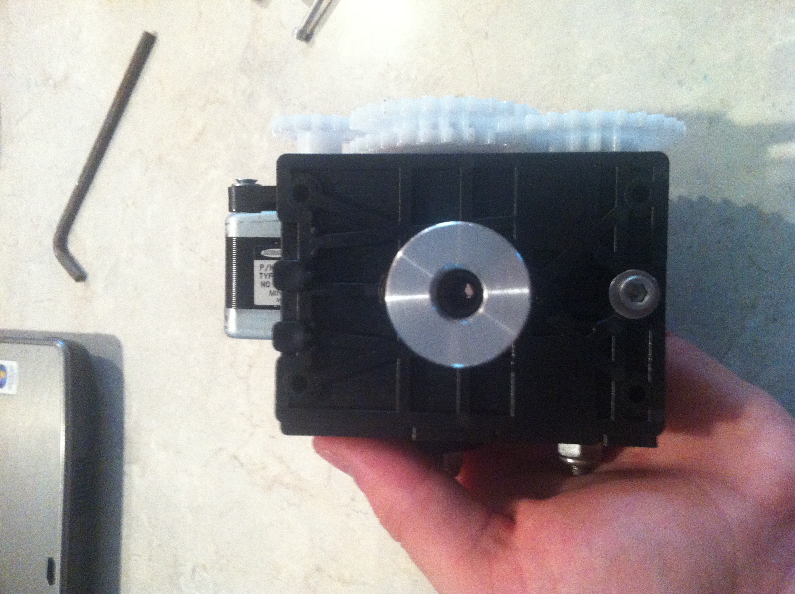

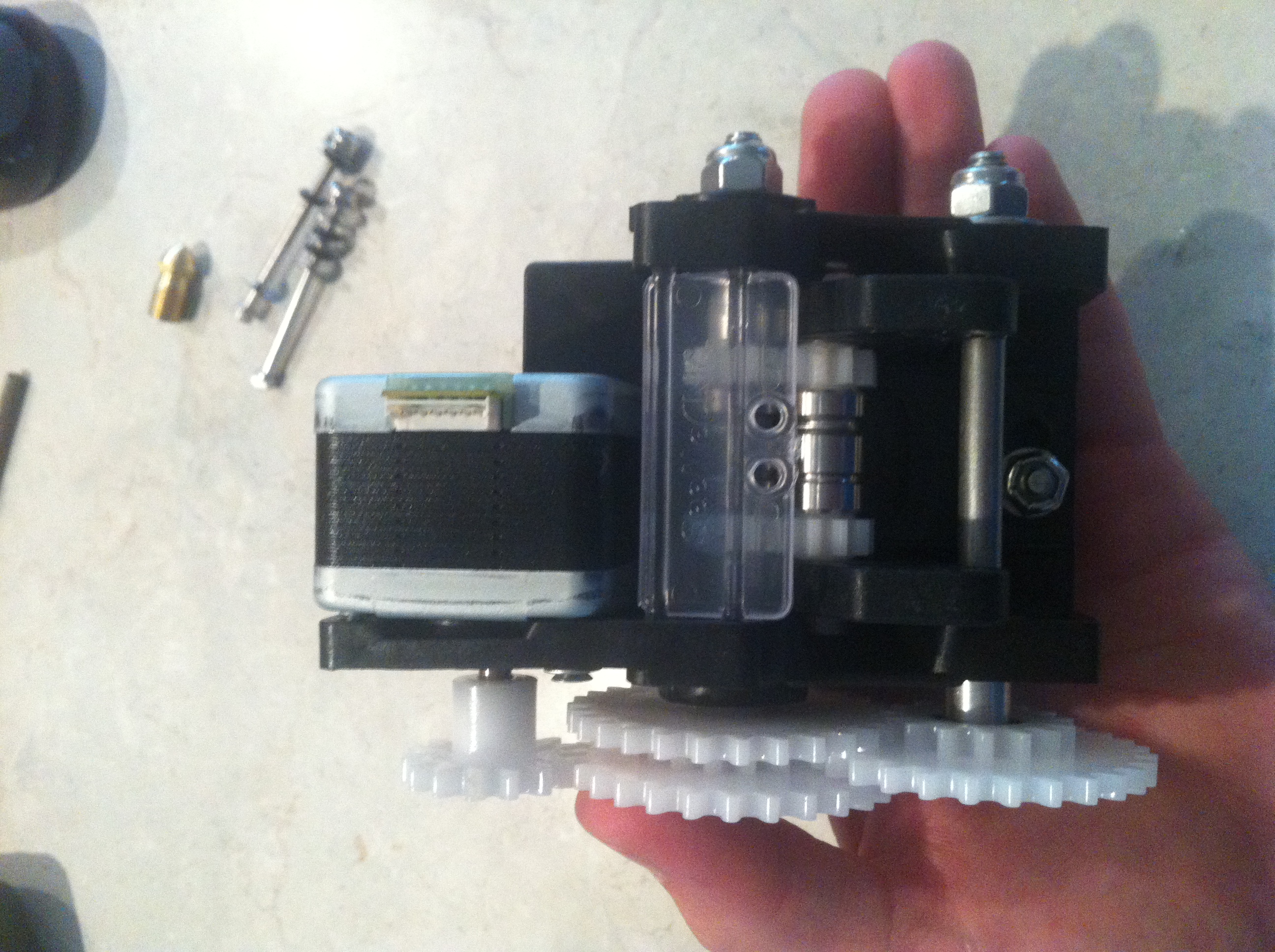

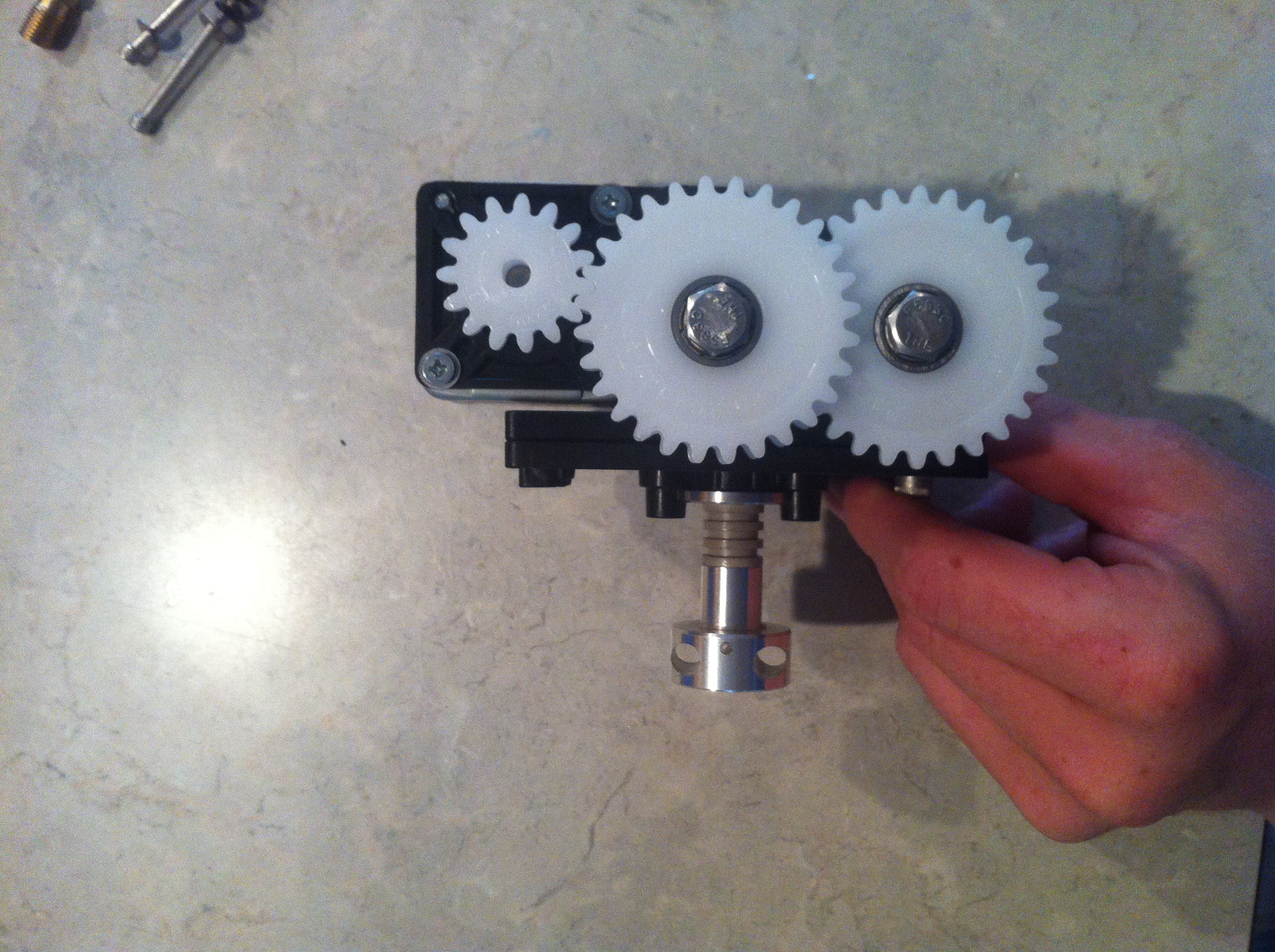

I went ahead and put my extruder together using the instructions from the H-1 as reference. I seem to be missing two parts, the Tensioner(#17) and the Tension Bar(#19). If any one else is missing these parts please post it so I don't feel like the only one.

Also here are some pictures of the extruder for Mike. Sorry i forgot to take step by step pictures but those will prolly give you a pretty good idea of how to put it together. You might be able to see where the parts I'm missing go if you compare it to the old extruder.

You have to remove the two socket head cap screws and one of the side pannels to get the missing parts in. I don't have an H-1 but i looked at the extruder diagrams and they use almost all the same parts. I havent looked through any of the other parts yet to see whats missing. I hope the instructions get posted soon
