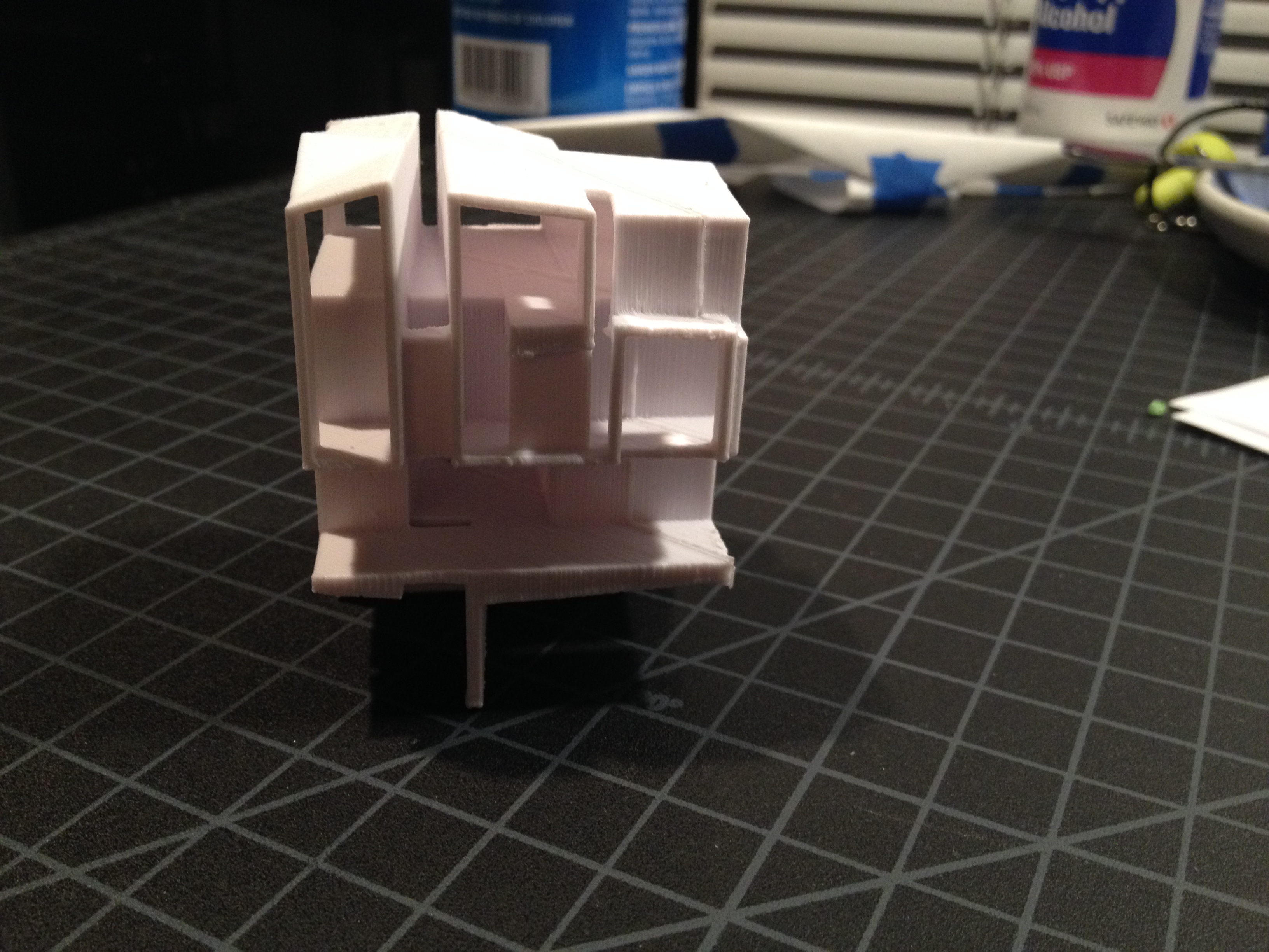

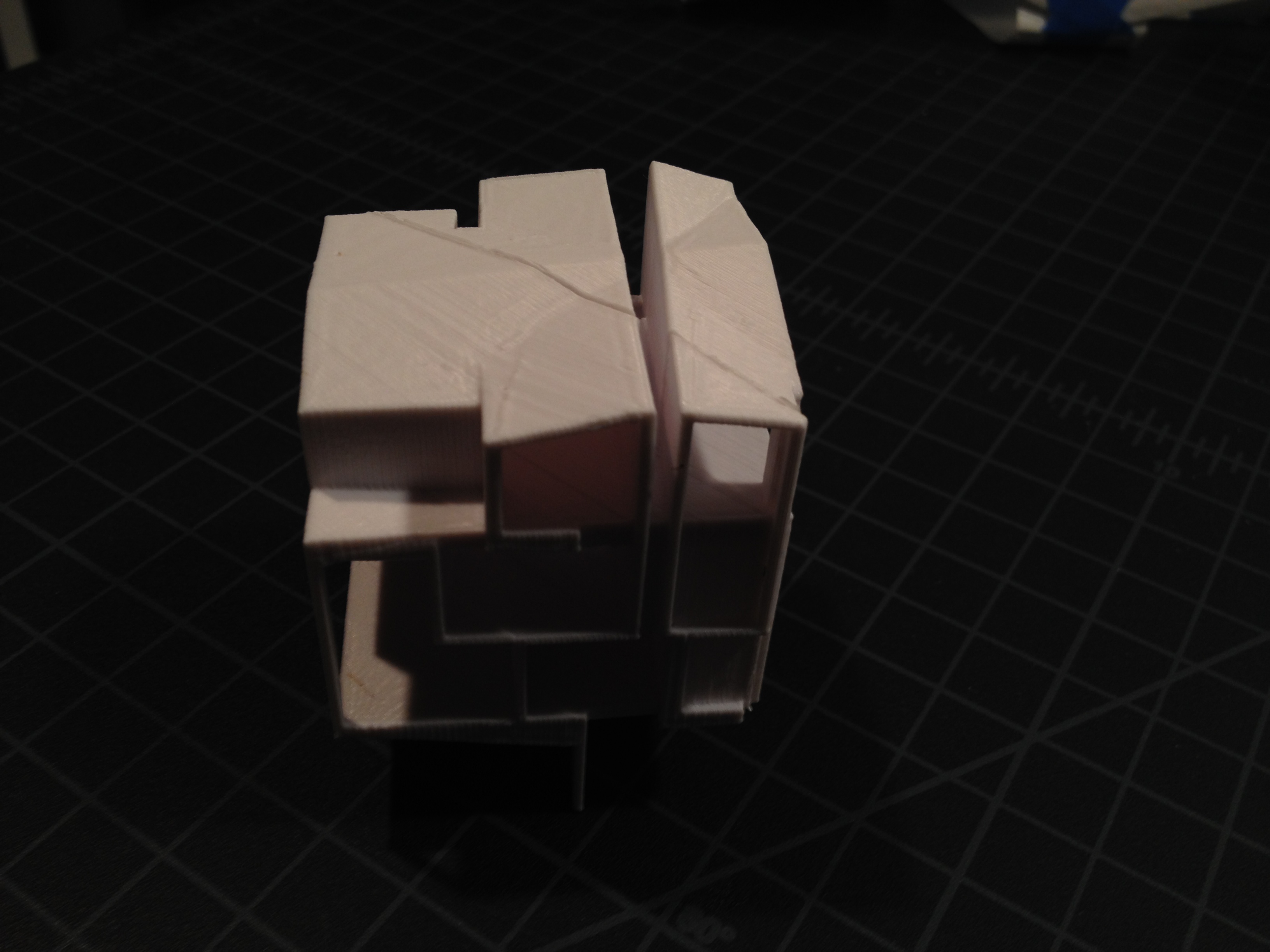

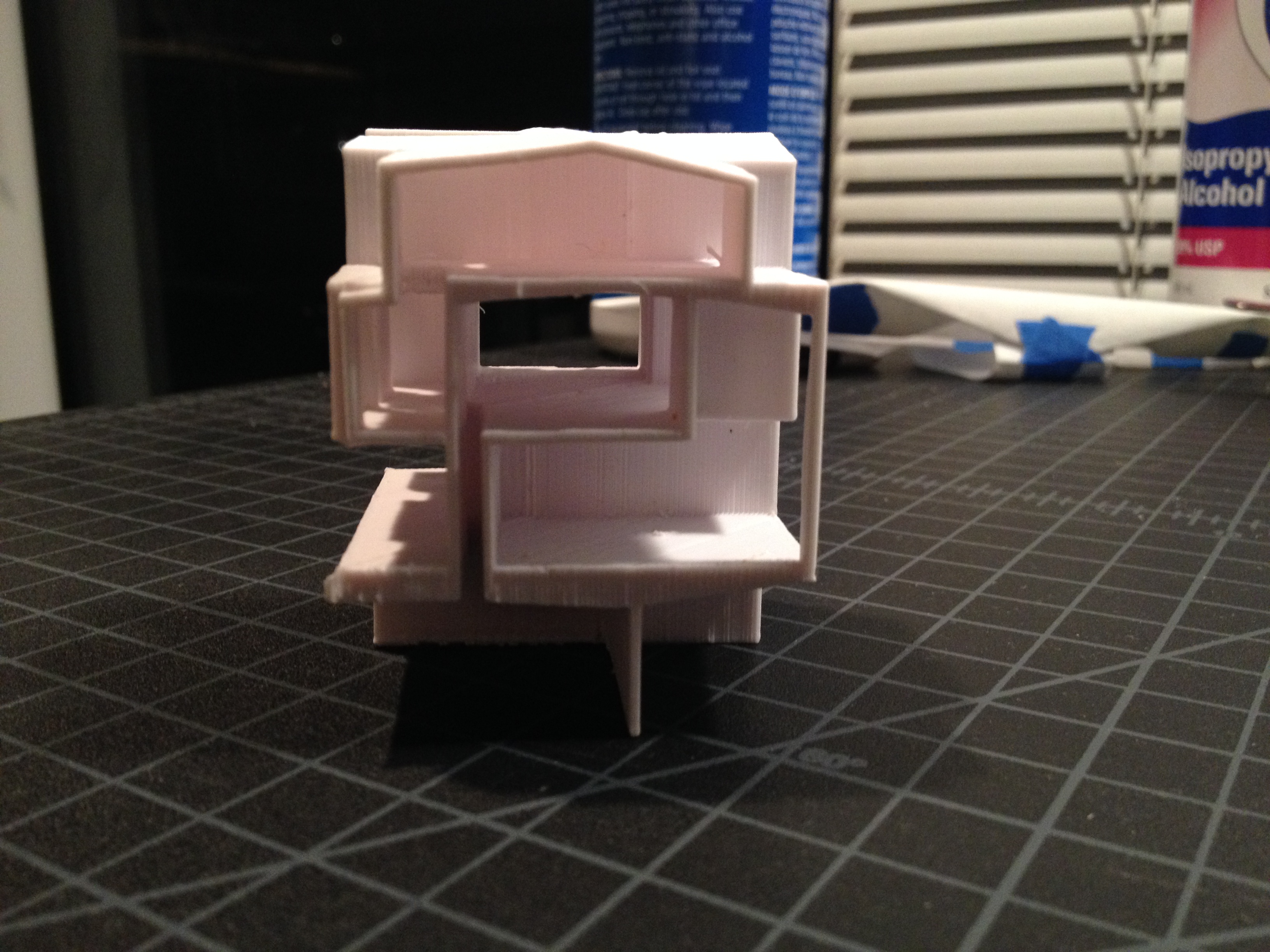

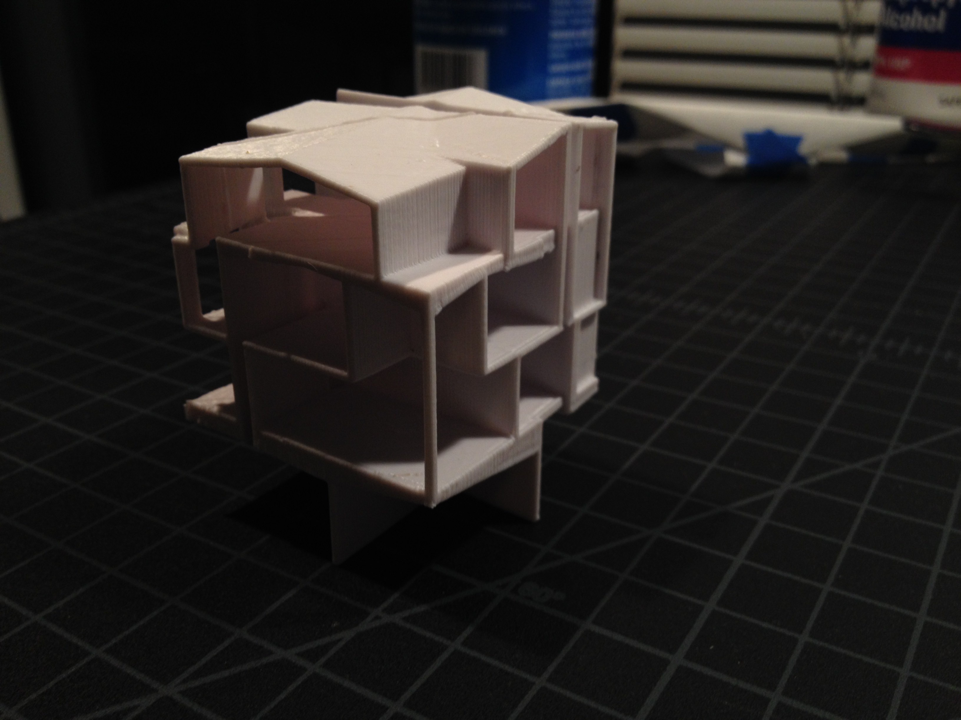

I printed a house.
Post by bot »

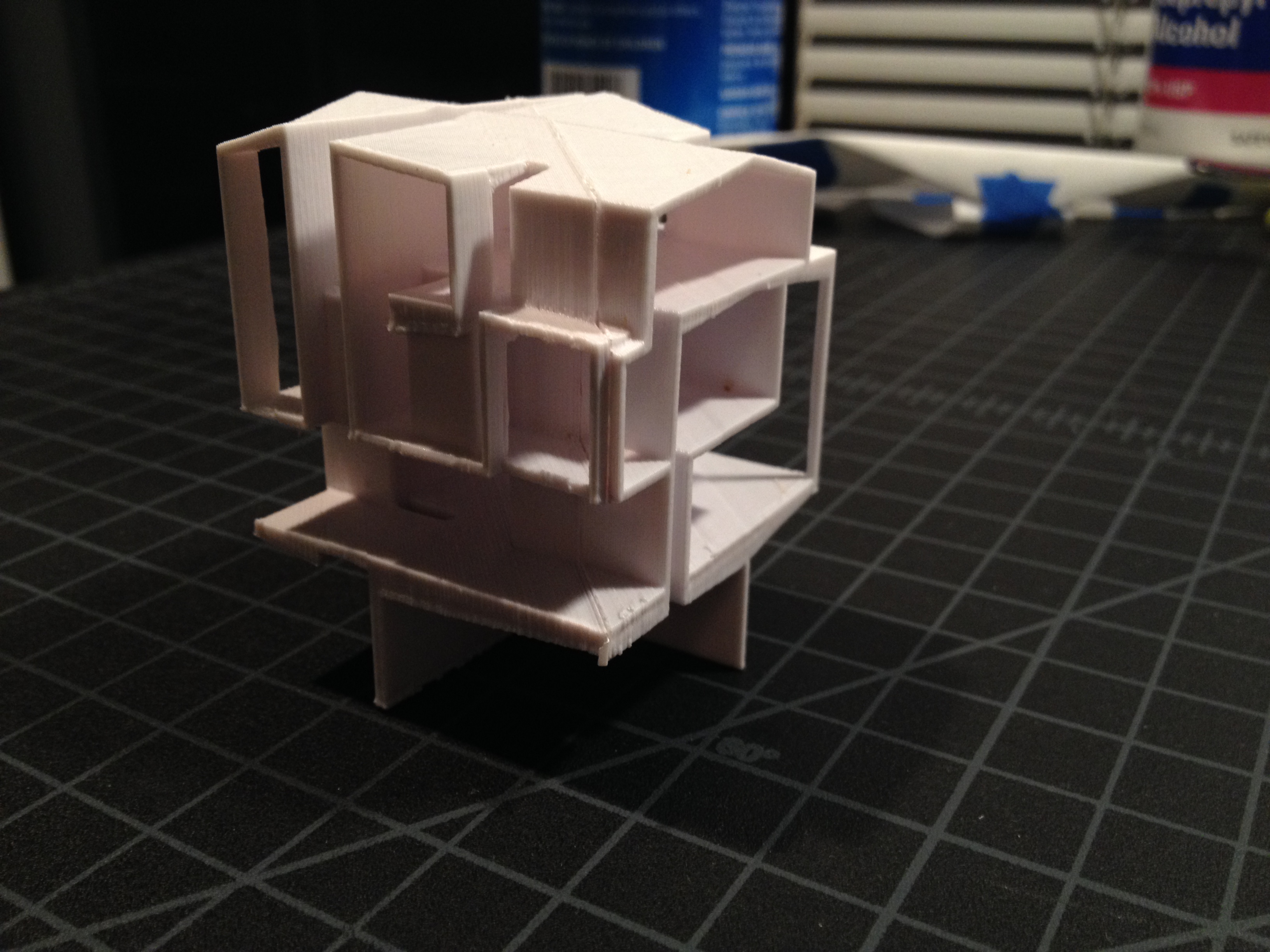

This is what I do on Valentine's Day.
ABS, 200 micron layers, 50mm/s print speed.

That looks pretty amazing.
Did you print it in parts? With support? And what size is it?

Two parts, split diagonally as seen on the last photo. Barely any support at all, just under those long bridges on the corners, which were the last layers to print. Likely wasn't needed. Simplify3d is a boss.
It's pretty tiny! This was part of the challenge. 2.5" tall x 2.5" x 2"
Gonna do about 11 more of similar size and style.

At first i thought it was sitting on some bathroom tiles.
Nice job.
Re: I printed a house.
Very nice design and print.
I think you are the first to post the printing of a house.
Great job!

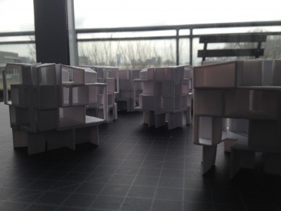

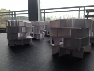

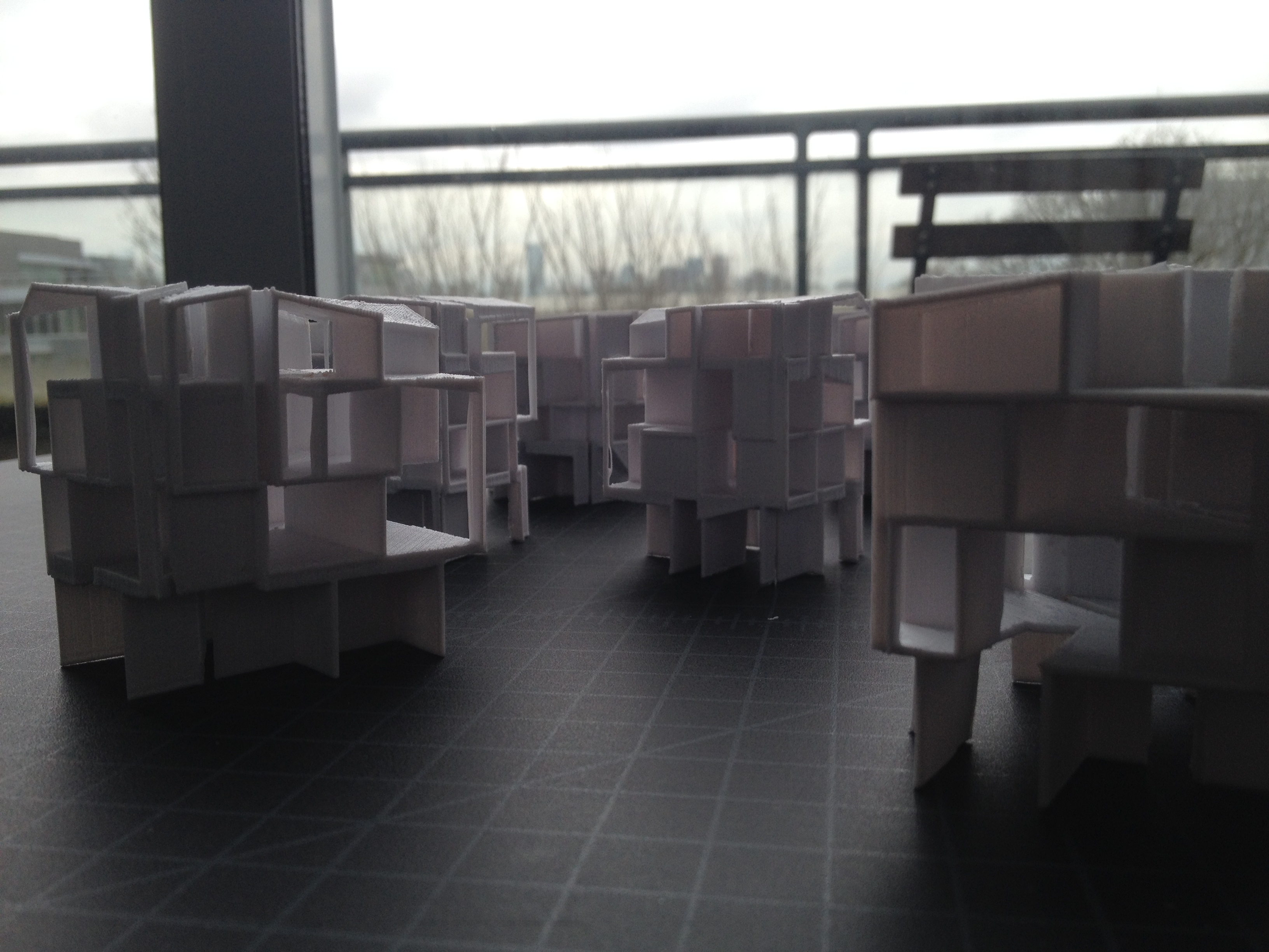

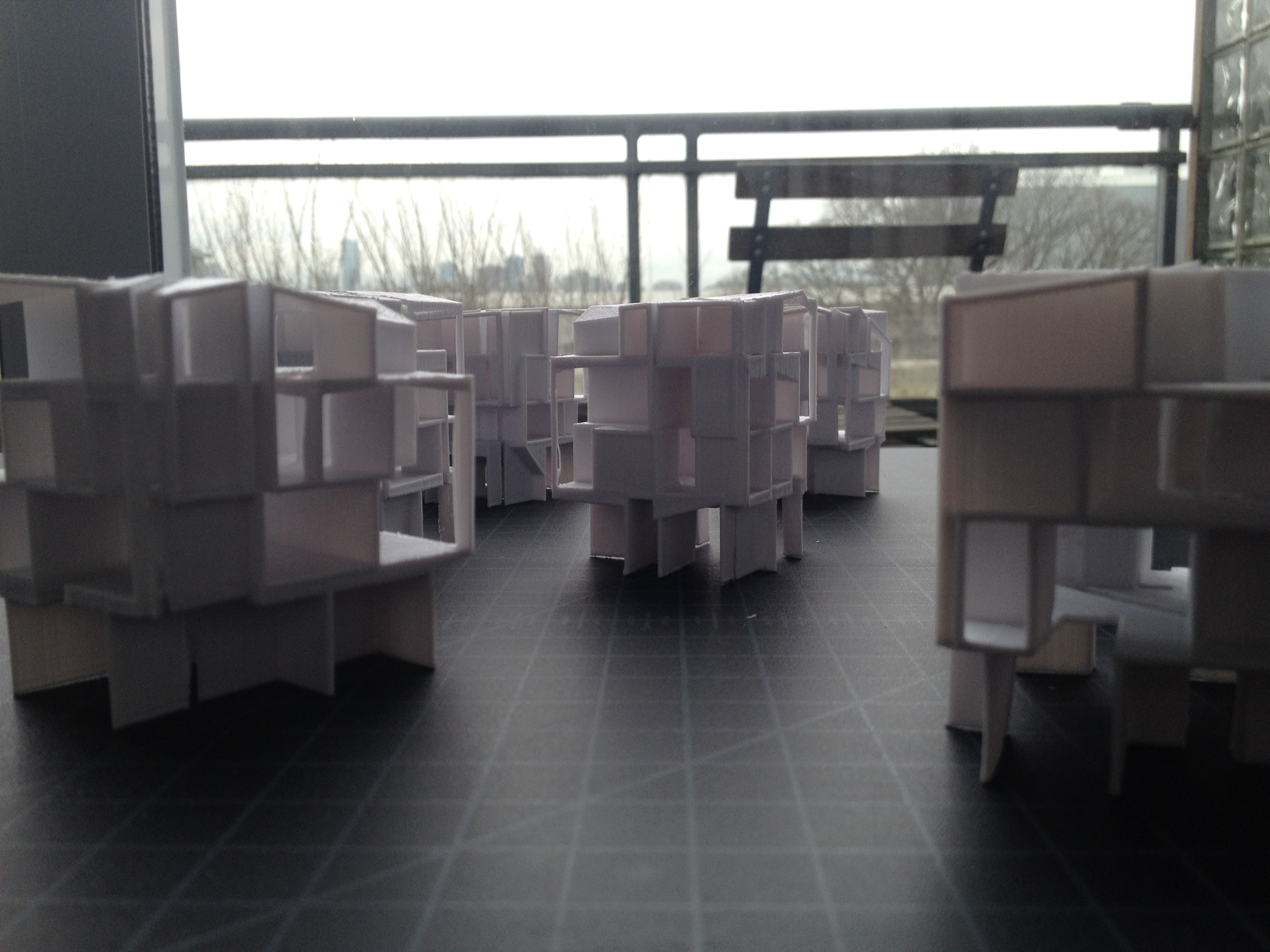

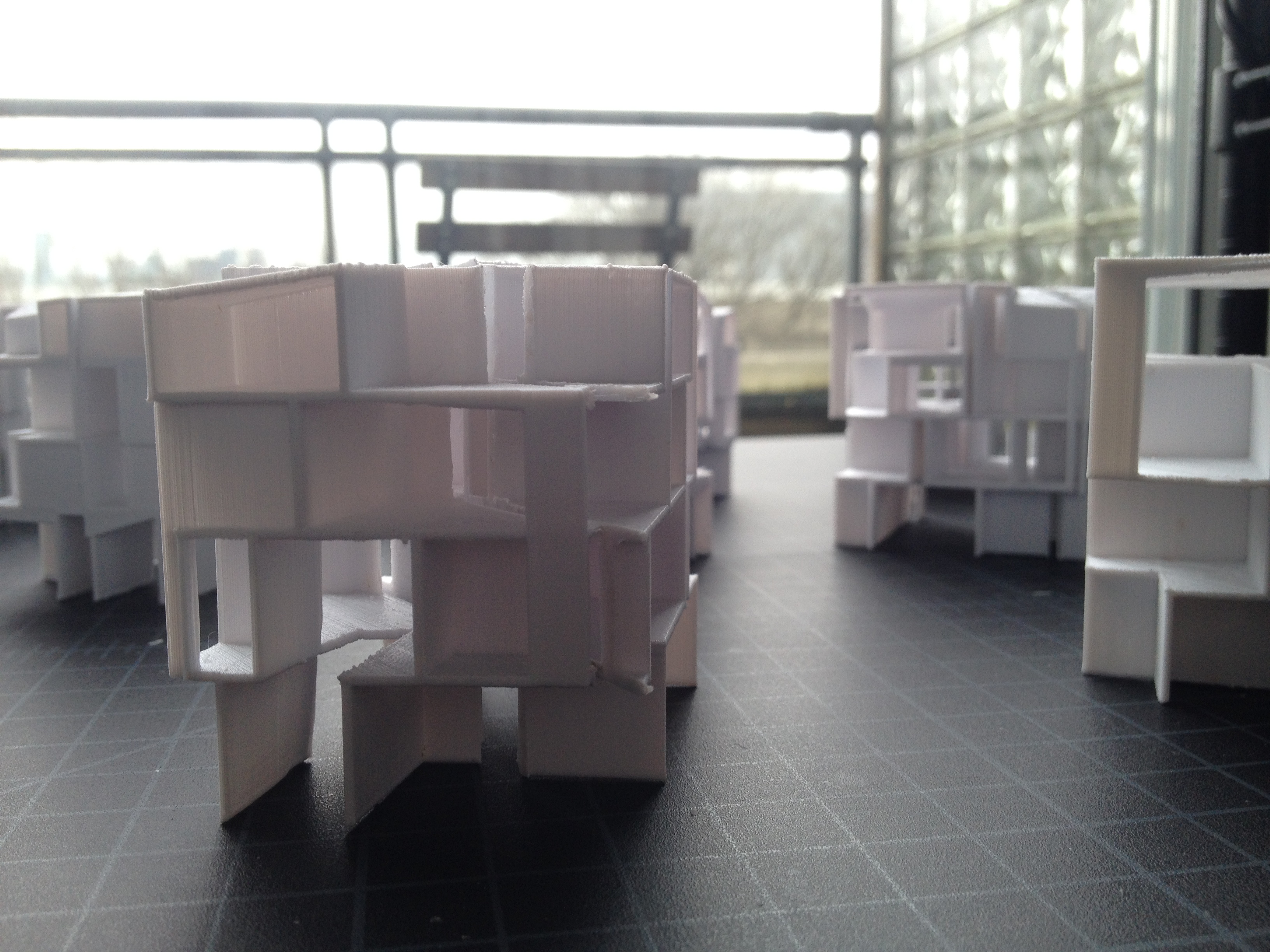

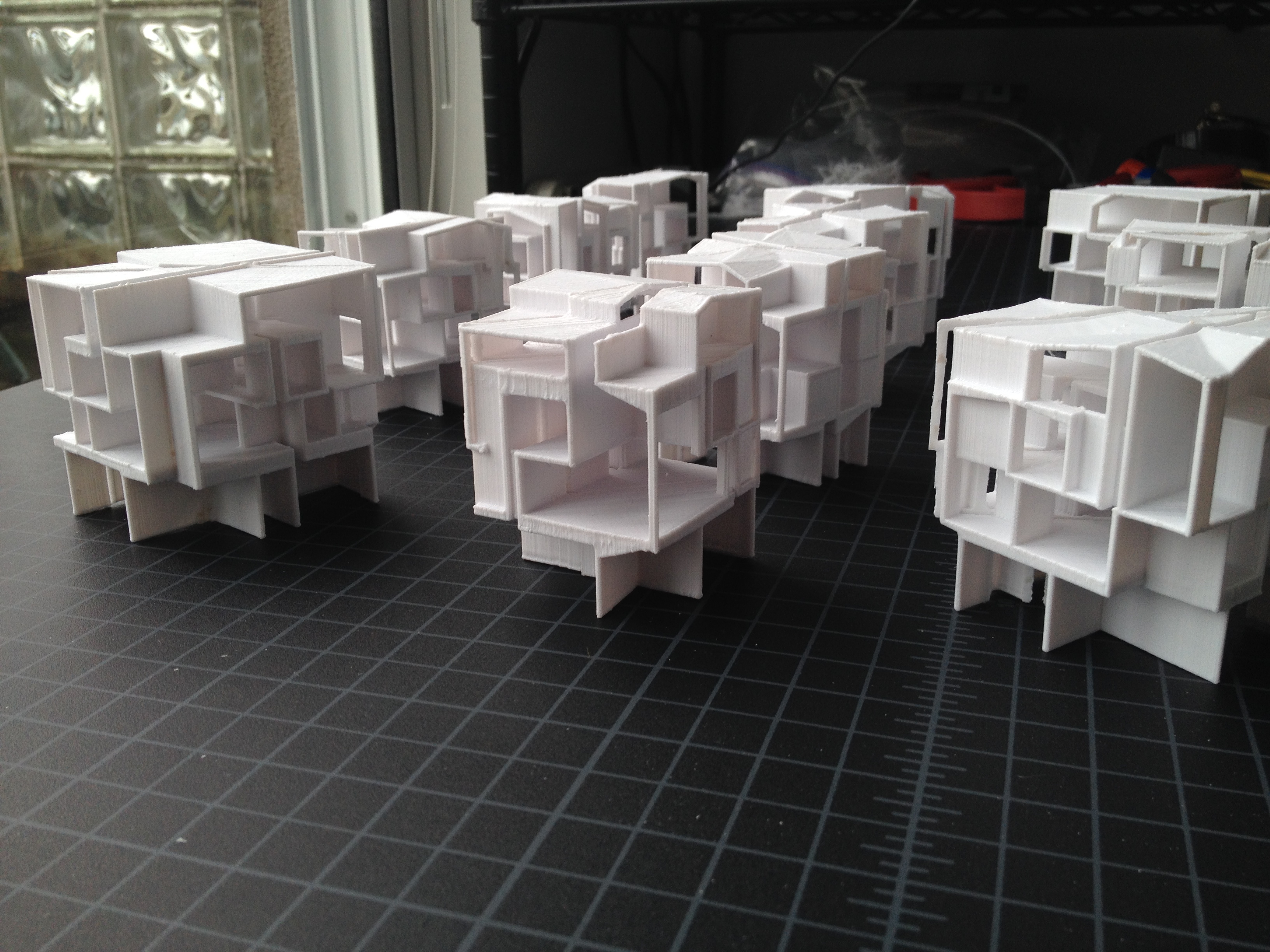

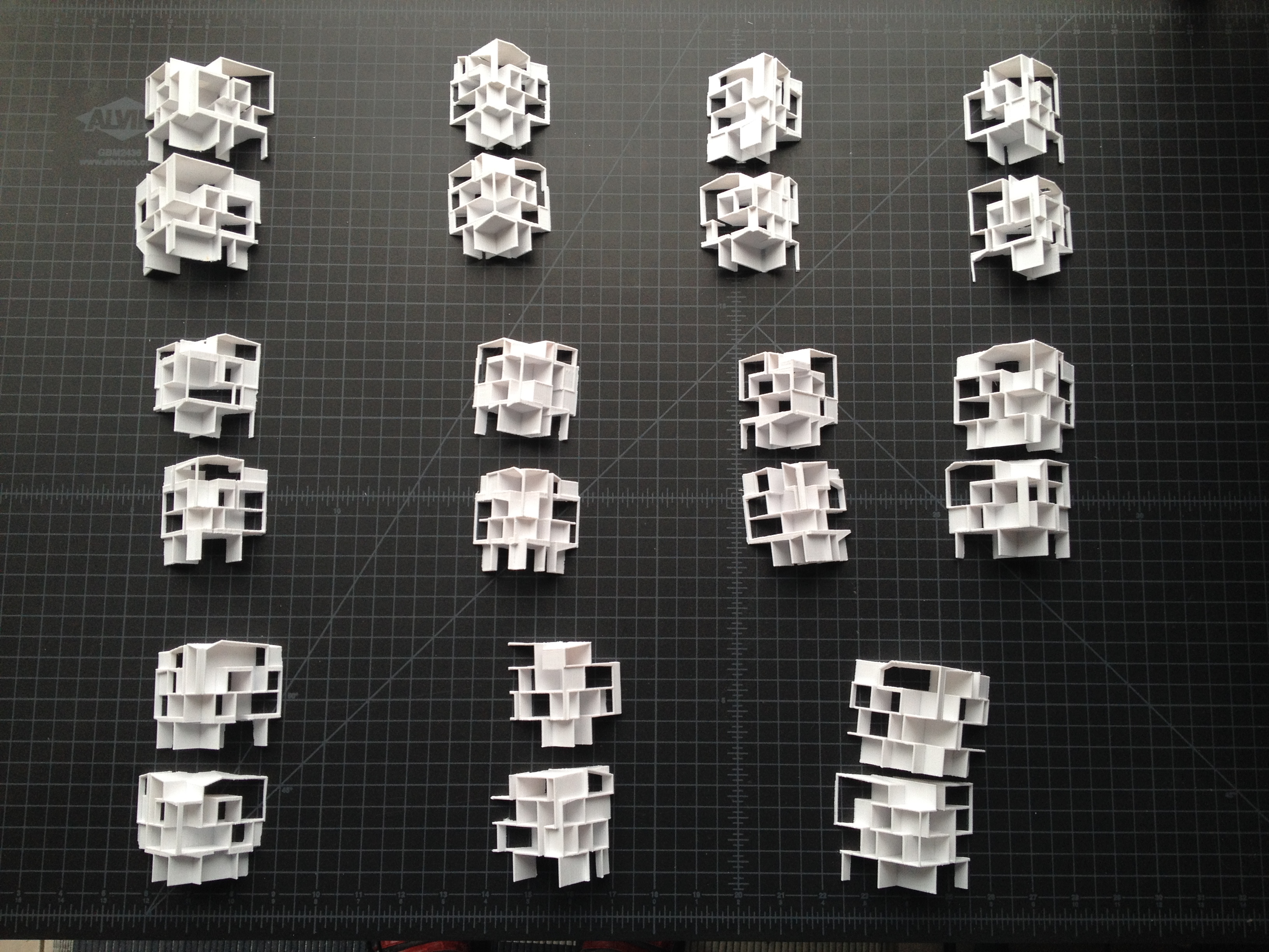

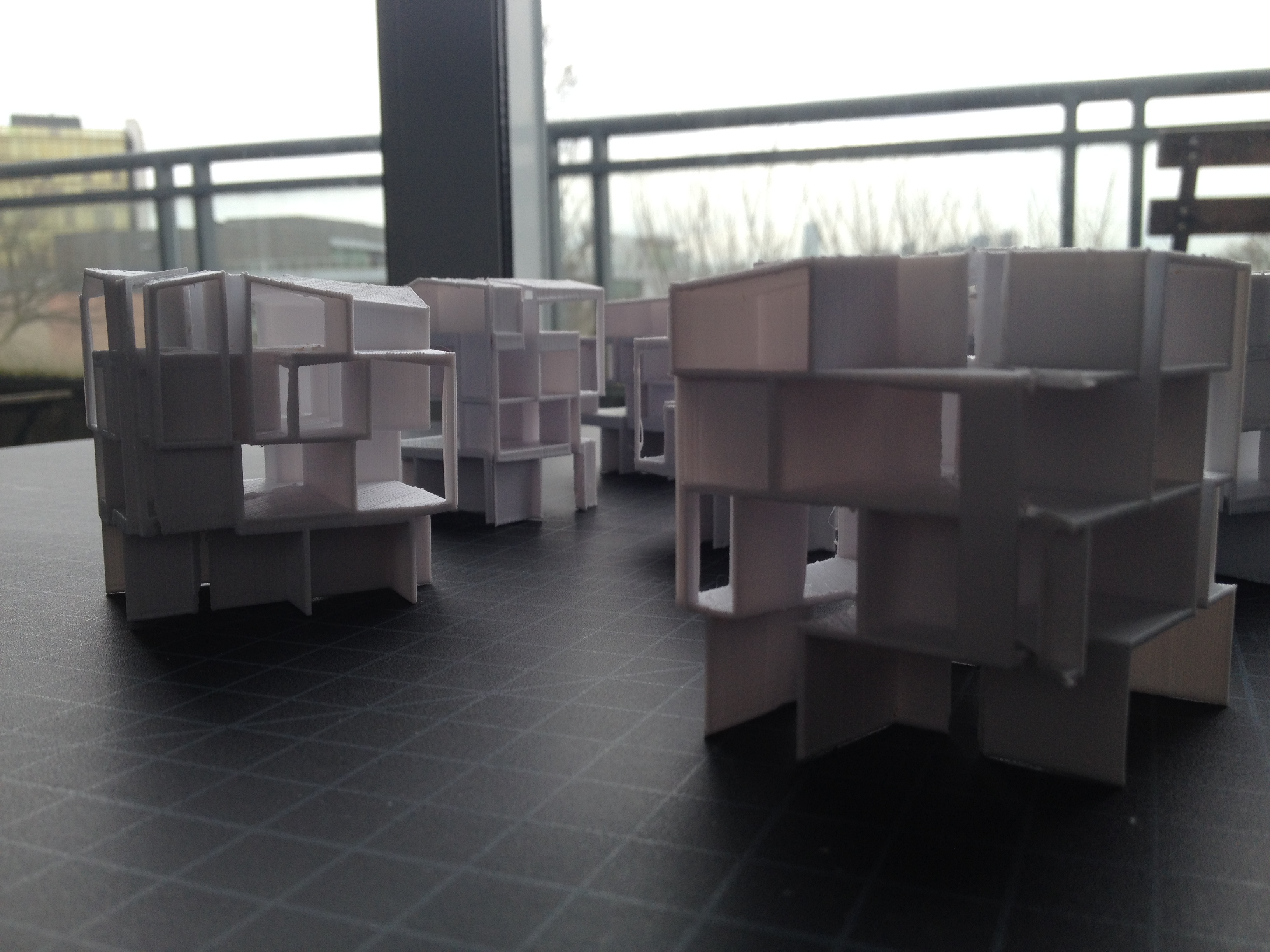

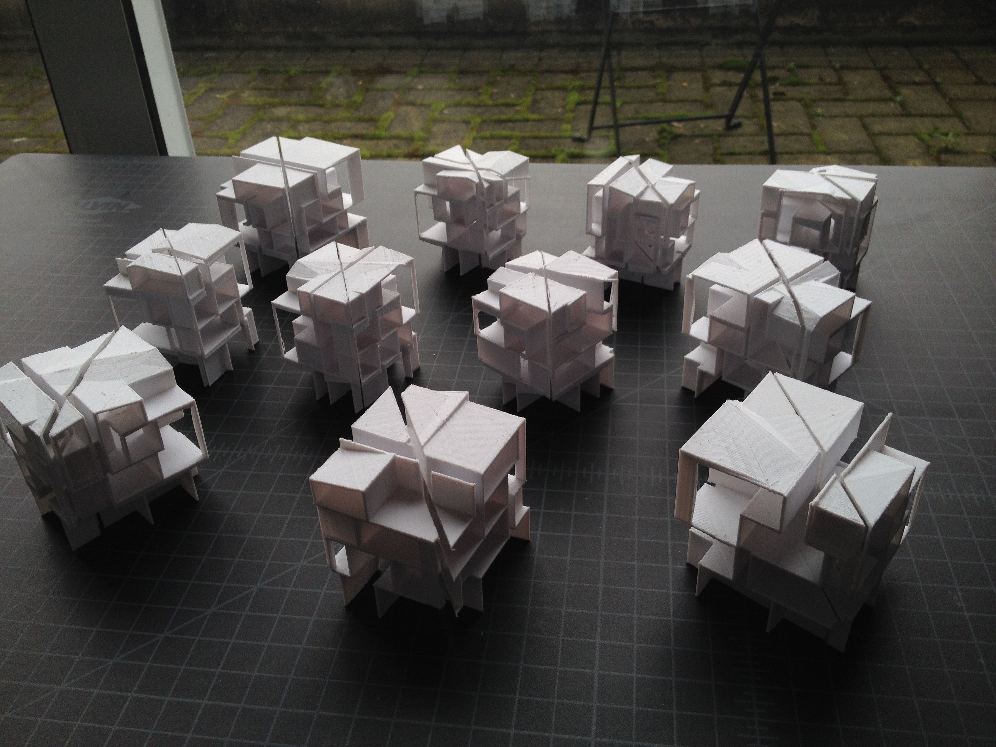

Here are the rest:
The designer's name is Max Hsu, from the University of Pennsylvania.

A very good job!
