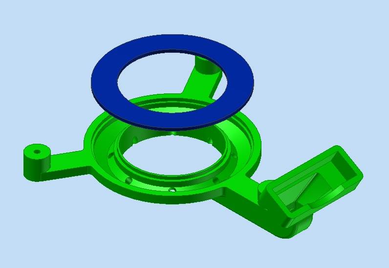

I also had problems with warping, what I call a sag. I believe the problem is the fan only cools the side closest to you, leaving the opposite side hot, !!! SAG. I have designed a radial cooling housing for the MAX 2, look on the gcode page for the files, Hope this helps
Draw-Tech

I'd love to utilize your design, but would it be possible to have the fan holder portion straight up and down, instead of on a slant? The reason I ask is that I have an enclosure, and the current layer fan shroud can bump into it, if printing something rather larger in diameter. I've been trying to develop something similar, but my CAD skills are nil. (Tinkercad is challenging for me.)

Did you have to run longer screws for this?
