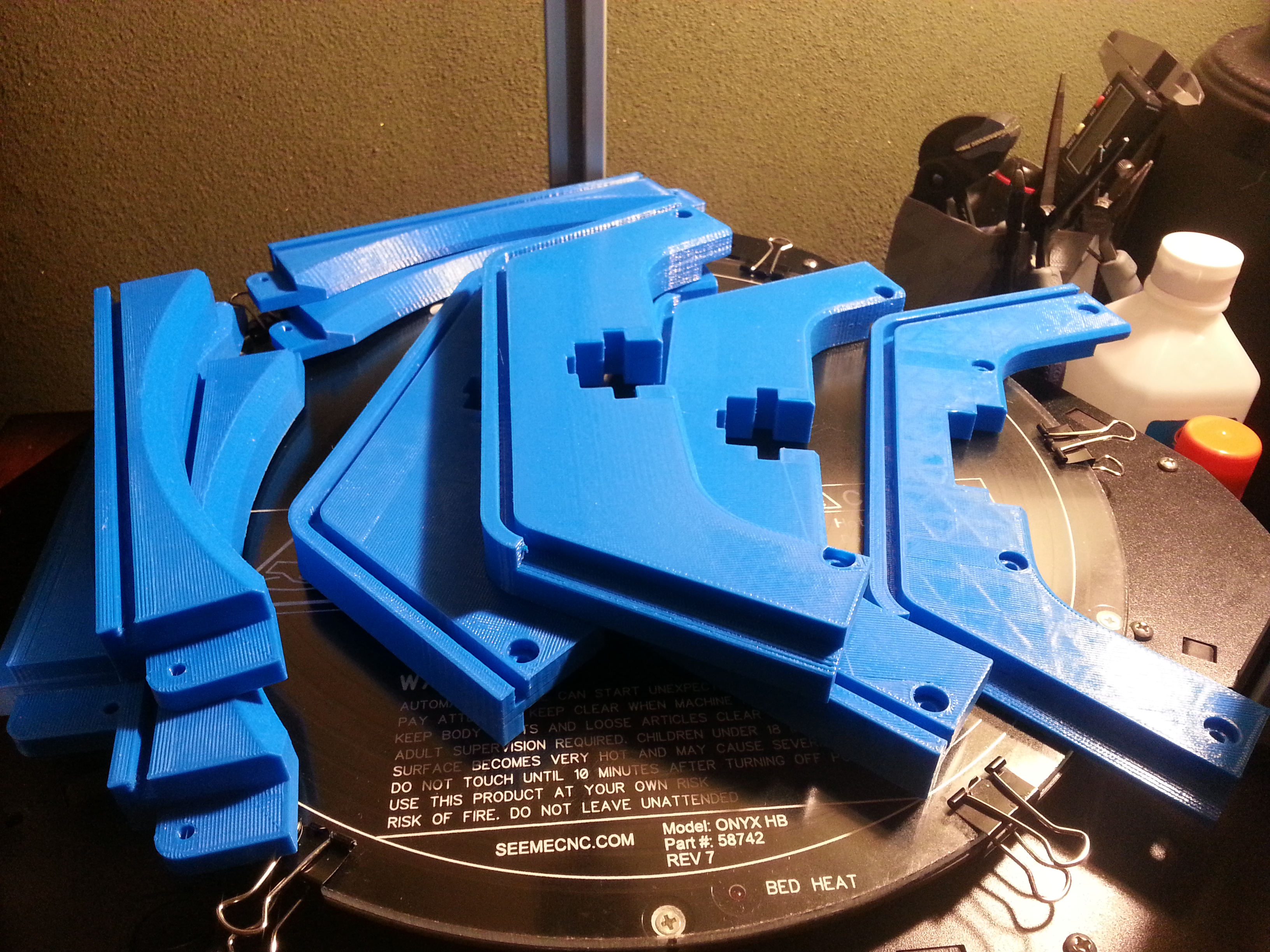

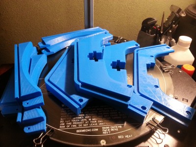

It's very odd, As you can see below I printed a few that appear to be the same size and used the same setting each time. I rotated and printed all the same direction and didn't offset any of them. But this one definitely doesn't like something that the others didn't mind.
Yes, I'm sitting next to the printer every time it's happened. Typical clunking noise right before the nozzle grinds across the print onto the glass bed before I can frantically shut the power off. It has done it 4 times now, and they all look like the same layer although the nozzle has hit the bed different directions depending which way I have the print oriented. So far it's been predictable which way the nozzle will hit the glass and the LCD shows around 19% each time.

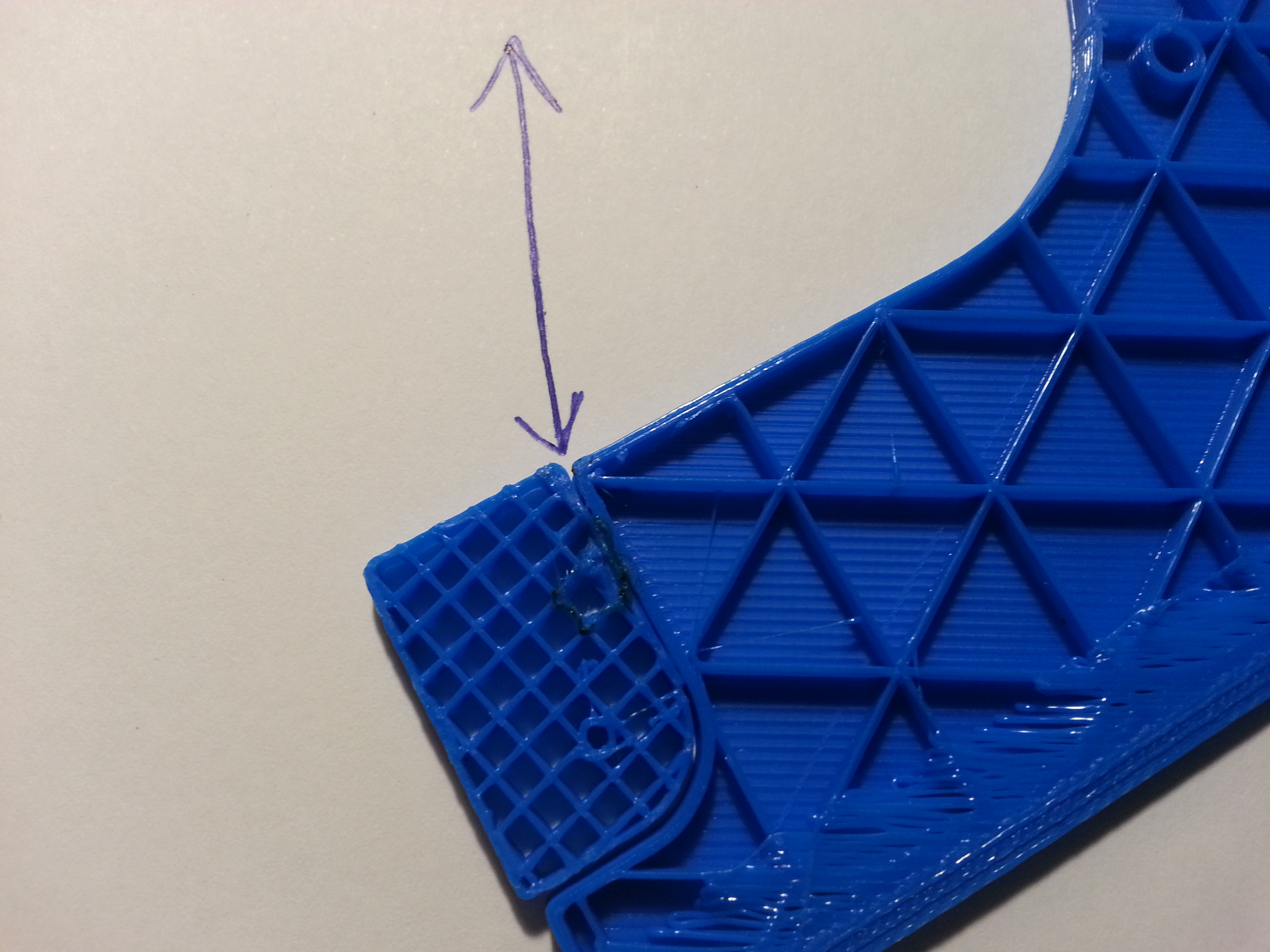

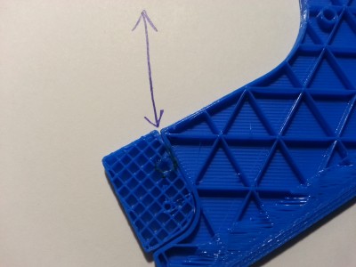

Here you can see where the nozzle punches down into the support then kind of drags out following the line and then it hits the glass.
KAS
Posts: 1157
Re: Best way to check gcode for errors or issues?
Post by KAS »
I believe the issue had something to do with the removal of the Astrosyn dampers. My Z-lift was set to .5 and the flex in the dampers must of allowed a little wiggle room before. I change it to 2mm and ran the same print and it completed just fine and I didn't hear any of the little nozzle drag that I've been accustom too.
