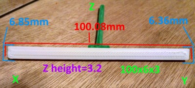

I have been using a 100mm X 6mm X 3mm calibration object made in OpenSCAD. Printed at .2mm layer height, with the first layer at .3mm. Using Slic3r. Using RepetierHost 1.0.6 and current firmware from SeeMeCNC's website.
Top view. Excuse the crude MS paint notes.. As you can see, some of the dimensions are off. Length is correct enough (only after adjusting the diagonal rod length). Z/height is off, but consistent across the entire object. And the width is off, but it varies from one side to the other.
Bottom view. You can see right in the middle of the object where it starts to really change. Looks good on the right side, and gets progressively worse to the left. Even though the right side looks good, it is still .36mm bigger than it should be.

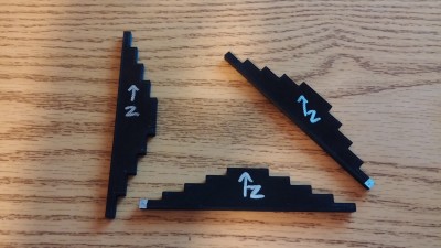

I did a quick test, printed at 0, 90, and 45. The 90 degree print is the same on both ends, and the 45 degree print is large at the opposite end! X positive, Y negative from zero instead of X negative and Y0. Kind of strange in my mind.
Z arrow is pointing towards the z tower.

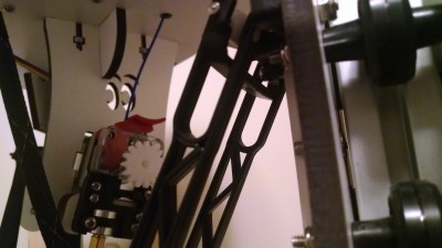

Sorry to resurrect a old thread, but I think I figured out my problem! And boy do I feel stupid...
Can you spot the problem here? (this is on the Y tower)
Yeah.... Built the printer almost a year ago now. Have went over it countless times, and never once did I notice one of the arms was upside down.
Everything opposite of the Y tower prints distorted the further you get away from the center of the printer. This has to be the cause. Going to correct this and re-calibrate.

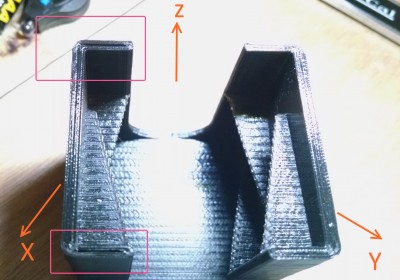

Below is a top down view of another object I printed. A small AAA battery holder from Thingiverse.. Notice the gaps between the walls in the purple boxes? When the object starts these walls meet, but as it gets taller, the gap/distortion also gets bigger. On tall enough objects, some distortion also starts to appear in the bottom right... It is not a slicer issue, I get the same results no matter the slicer used.
