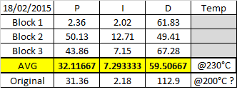

Just had exactly the same issue with my Orion and it was fixed with a PID tune.
Instructions are in the Rostock Max V2 Build manual page 232 to 234 (though if your not used to Matter Control Software some pages prior are needed to see how to use the "terminal" which is used to run the autotune procedure)
http://download.seemecnc.com/rostockmax ... dition.pdf
Essentially it outputs 3 blocks of data and you use the average for each P,I or D value and upload these new values to the Eeprom from either Matter Control or Repetier.
Below are the values I got and how much they changed from the stock original ones(note I did my tune @ 230 DegC as I generally always use ABS).
PID Values.png (5.75 KiB) Viewed 21972 times
So as can be seen above my I & D values were significantly different and changing them to the new calculated averages did fix the issue for me, mine was holding 3 DegC below target.
Turning on the layer fan will depress your nozzle temp a bit but 15 DegC sounds like a lot to me, I usually see about 5 DegC drop at 100% fan. Personally with ABS I only use the Layer fan on bridging and depressing
the Nozzle temp helps a bit also.. hopefully the tune should help...

I don't know if it's the resistors burning in or what, but I redid the PID tune and the numbers are way different than the first time I ran it when the v2 was new. It regulates better with the new numbers.

Might be, but IME running autotune is like running a random number generator, result is heavilly depends on the environment. It also generates values with way to much I and D IMO, which is why you get the I can't reach the temperature I'm requesting issue.

I just had a resistor burn out on my Orion after about 6.5 hours print time, so I replaced both resistors with a single 40w cartridge heater here: http://www.ebay.com/itm/221501592348
Warning - I got quite a bit of smoke from the cartridge when I first cranked it up. Be prepared to ventilate your work area well. After a minute or so the smoke stopped.
The existing EEPROM settings for PID allowed it to oscillate between 195 and 206 degrees, so I ran Autotune per the instructions in the Rostock manual and now it stays +/- 1 degree.
My settings came out to P = 7.91, I = .32, D = 49.
