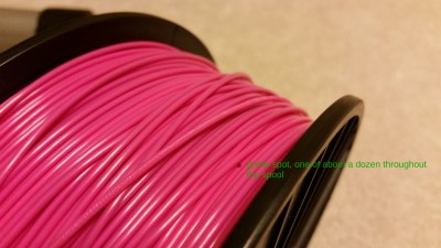

I opened up a spool of ABS from Coex and it's printing now. My first impressions are that the filament feels nice and smoooooth and has a nice gloss to it - I want to like it right away. I measured it 6 times and the diameter was between 1.74 and 1.78. Not the tightest tolerance, but certainly acceptable.
The one downside is that the filament is dirty. It did come in two(!) vacuum-sealed bags along with desiccant, but even just loading the filament into my printer I wound up with around 5 specks of grime on my finger. I probably ought to have set up some kind of filament sponge/filter thingy to wipe the filament prior to entering the extruder, but I wasn't that patient.
EDIT - I went to try and take a picture but my camera won't focus enough to see it. I guess the grime isn't terribly excessive, but I bought a bright color so it really stands out. I'd say just rotating the spool in my hands and giving it a quick eyeball, I can probably find 8 or 9 tiny little spots, some of which seem to be a couple layers deep in the spool. Otherwise, except for those spots the filament is clean. It's not like it was sitting in a pile of dust or someone dropped it in mud before they bagged it. (And when I pointed out the double-bagging thing earlier, my point was that it wasn't the shipper's fault.)

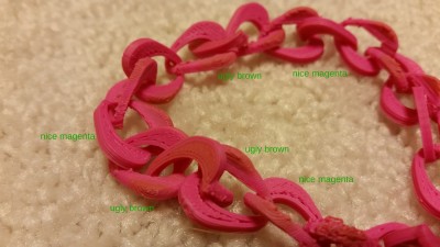

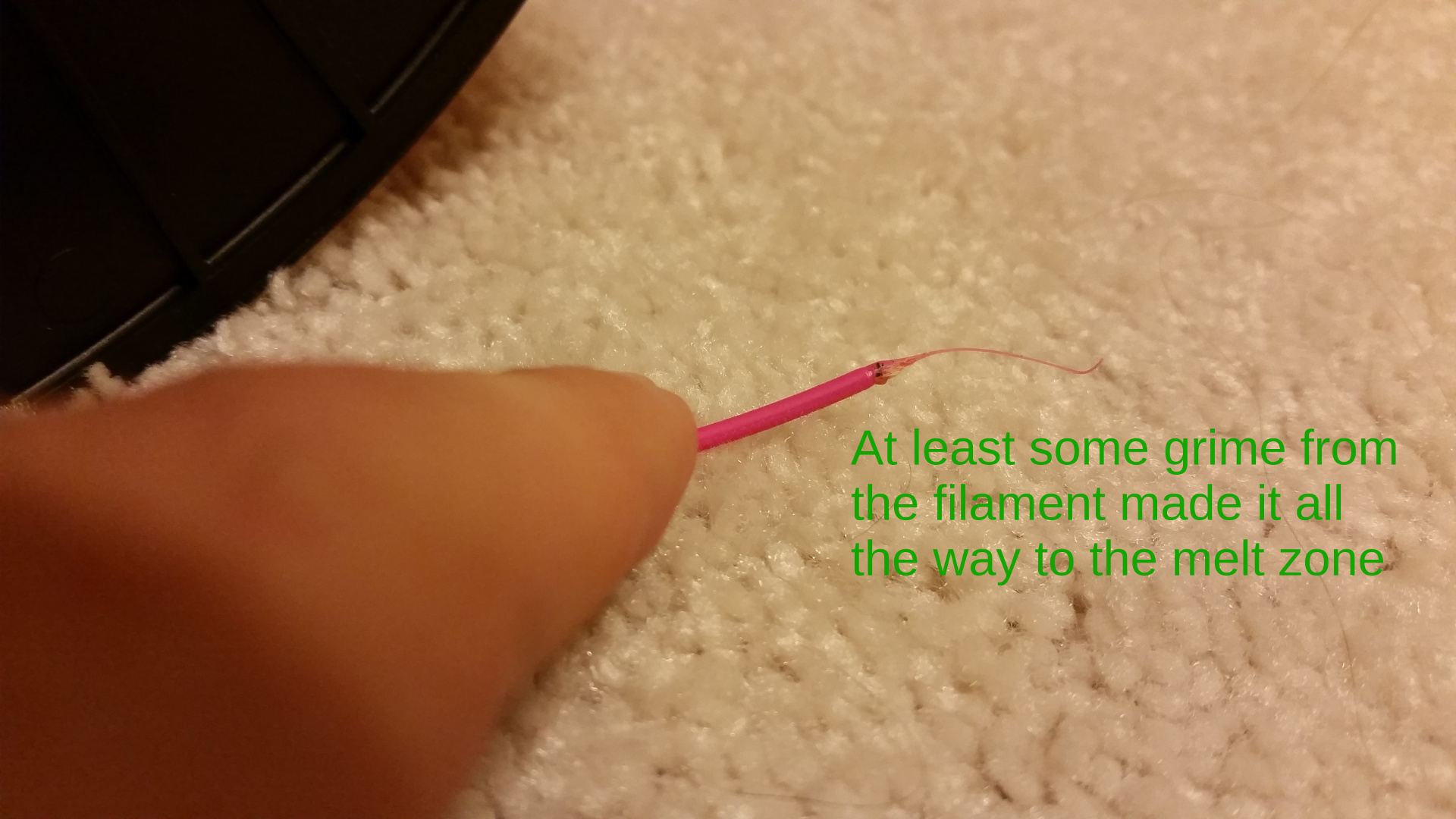

Ok well I have some bad news. After my first print finished, I saw streaks of brown in the layers at various heights in the print. (For reference, I bought the "Fluorescent Magenta" ABS, which is pretty much pink.) My first thought was "hmm, well I printed at 245c, maybe that's just on the high border and maybe I'm burning the filament in the slower parts of the print" so I printed a second at 230c. Got the exact same thing. So now I'm wondering if the grime that came on the filament is being melted in the hotend along with the filament and becoming an ugly brown additive colorant.
I can probably salvage the spool using one of those sponge holder thingies I mentioned earlier but there is no reason I should have to deal with this. Sadly at this point I can't really recommend this stuff. If I open one of the other spools and it's clean then I'll post back here and update, but as they say "you don't get a second chance to make a first impression."

Anyway here's the email I sent to Coex. My camera was feeling more cooperative tonight so I was able to get some photos, but I'm having a hard time uploading them here. I'll try again later, but for now, here's the text:
Hey guys - I received the filament the other day. I've only opened the Magenta ABS so far, but I have to say, I'm disappointed!
Since it's a "made in the US" product I really want to like it, but it came flecked with grime. I've attached some photos to this email. The grime isn't excessive, but it's enough to make its way into the hotend and discolor the print. It's especially disheartening because one of the very first things on your About page is boasting about uniform color: "Tired of inconsistent colors? – Coex uses the most accurate color blending and mixing methods to ensure consistent color and filament quality."
I really want to give the benefit of the doubt, so was this an isolated incident? What happened here?

Well I got a response already! Not sure if Chris from Coex was working late or if it's the east vs. west time difference, but looks like we're going to take another whack at this. Fingers crossed the new spool is a good one!
Also I want to point out that I ordered 2 other spools from these guys (both PLA - the dirty Magenta is ABS) and those were pretty clean. Haven't printed with them yet but I took a really close look and didn't find any grime spots, so I'm really hoping this is an isolated issue.
Ben-
We will get you a new spool out tomorrow AM. This must have been some carbons in the filament. Can you tell me if you can rub the “grime” off the surface or if it is embedded.
I really apologize we have shipped 1000s of spool and had 2 returns so it is unusual but we will get it fixed for you

Looks like you were right Neptune, I resized the images and they uploaded fine this time around.
I heard back from Chris again and he thinks some kind of tape or grease found its way onto an idler bearing where it didn't belong, and is sending out a replacement spool today.

I run every spool through a sponge now. I just poke a hole through a fresh piece for every reel. I get an amazing amount of ...err... stuff off brand new spools fresh out of the vacuum bag.
