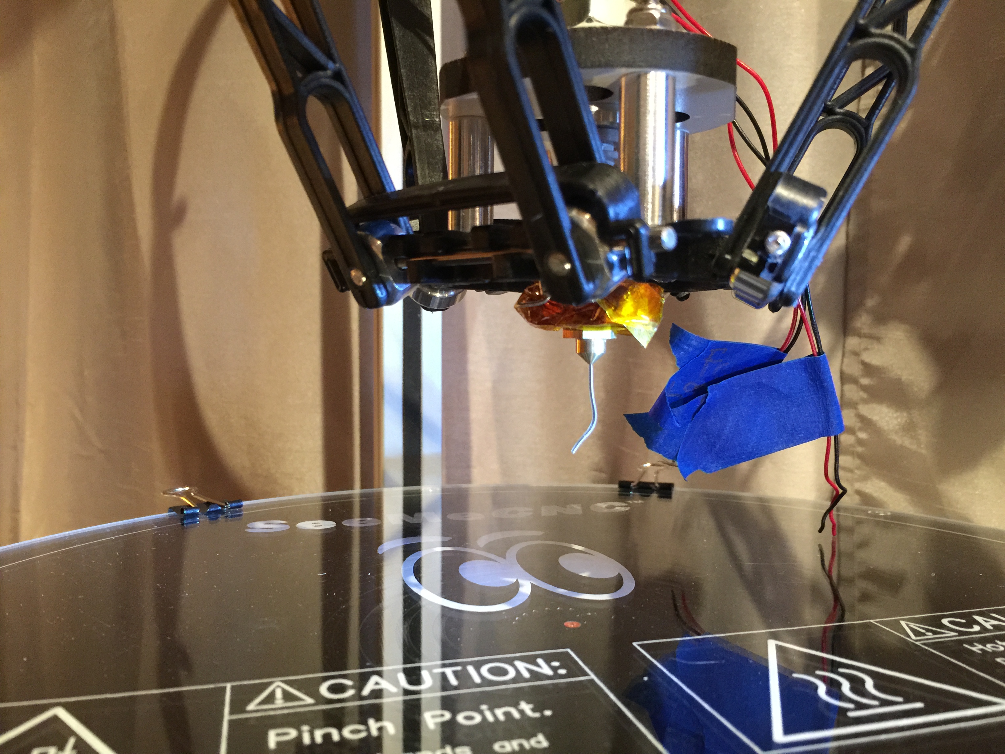

There's nothing super special about my build really, but here's a shot of it extruding what looks like goldfish poop.
Just the first little fish turd!
