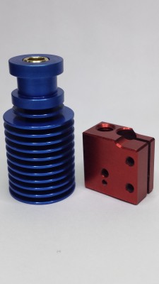

Today I tested how well heatsinks and heater blocks from E3D would anodize. As you can see from the results it works great! I will now be able to anodize them to match the aluminum and carbon fiber mounts I make. If anyone is interested in an anodized heatsink or heater block, just shoot me a note.

Nylocke wrote:Could you do this with a Kraken water cooling block without changing the tolerances on the M3 threads and the heat break holes? I don't know much about anodization, but I think it'd be cool to further establish my color theme I have going.
I would have to touch base with E3D on what alloy they used for those. Also have to make sure there is no other metals in that cooling block already when it is anodized. If both things check out it should be fine. The E3d V6 heatsinks are sourced from them without the brass fitting pressed in already so they anodize fine. The anodize layer is not a super thick layer over all and it should be fine. Everything still fits great on the E3d V6 I tested with. I will email them tonight and check on the metal alloy and also to make sure there is no other metal fittings I need to know about before it can be anodized.

E3d V6 heatsink and Volcano heater block
Thanks guys!
The Volcano heater block seems to also have done very well.
The heatsink is heading out to one of my beta testers and the Volcano will get a matching heatsink shortly and be my personal hotend for bigger projects.

Having been down this path - anodized heater blocks will discolor with use. It is not a good candidate to anodize. The heatsink is fine though. And yes, the Kraken exterior can be anodized, you simply plug the holes and anodize the exterior. The brass fitting in the Kraken can be covered with nail polish to protect it and then the hole plugged with silicone seal or putty and away you go.
Nice anodizing though! I anodize a lot of aluminum for my fly reels and appreciate a nice job.

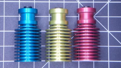

These guys are headed out the door to RUSSIA! Excited to see more international customers enjoying our services. We have a few more heatsinks in stock for anodizing if anyone else is interested. You can hit us up here or at [email protected].
