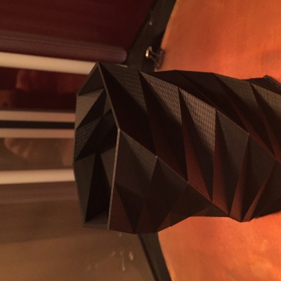

So as my tricklaser arms arrive today so I can hopefully remedy some banding issues etc. I thought id print one last item with the stock setup (minus the 3 layer fans).
So here is a clear PLA vase , default size which is pretty big. It printed very consistently all the way to the top (which i know at height some folks have issues).
I cant tell if the banding in this one is normal or not, it is SOOOO consistent.
let me know what you think. Ill print another after new arms :)
EDIT - THis was done at 210 degrees, 60 degree bed on PEI (perfect) w/ .15mm layer height.
[img]http://i1132.photobucket.com/albums/m562/dunginhawk/3CB831B9-D767-48D0-A7A3-8E63A31661CB_zpspvp3tsea.jpg[/img]

Looks awesome! The real test, will it hold water? Mine leaks little droplets out of a few seams and the inside feels like a torture device if you shove your arm in it.

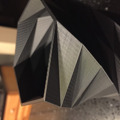

why would the inside look jagged? its just a single walled vase right? did you not use vase mode and had travel across the opening?
Either way, i just filled it, and NO leaks. In fact i was surprised because it only did 2 layers on the bottom.
the bubbles you see are inside, clinging to the plastic
[img]http://i1132.photobucket.com/albums/m562/dunginhawk/DFC117E9-1952-45D3-8F72-C7CC07E7A89E_zpsvfyyke0z.jpg[/img]

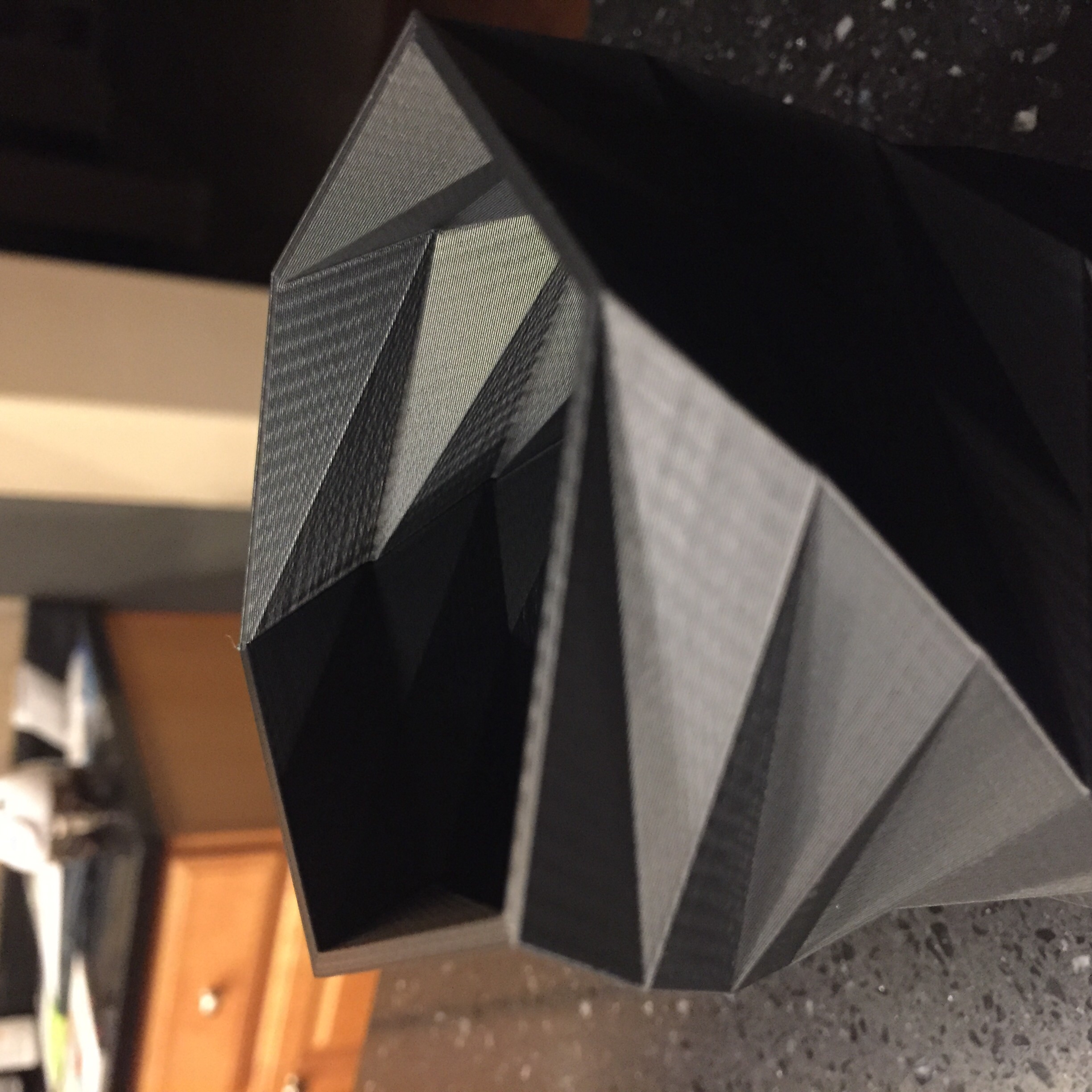

look at the inside. no jaggies
[img]http://i1132.photobucket.com/albums/m562/dunginhawk/7754DC25-3F29-4177-B275-91F0B0164EF5_zpset1bq3rg.jpg[/img]

so the banding in yours is visible too...
does anyone who does not suffer from banding have a pic of the vase they printed? im guessing with the angles its likely most would see some banding.

I think the banding you are seeing is aliasing from the low resolution of the stepper axis.
