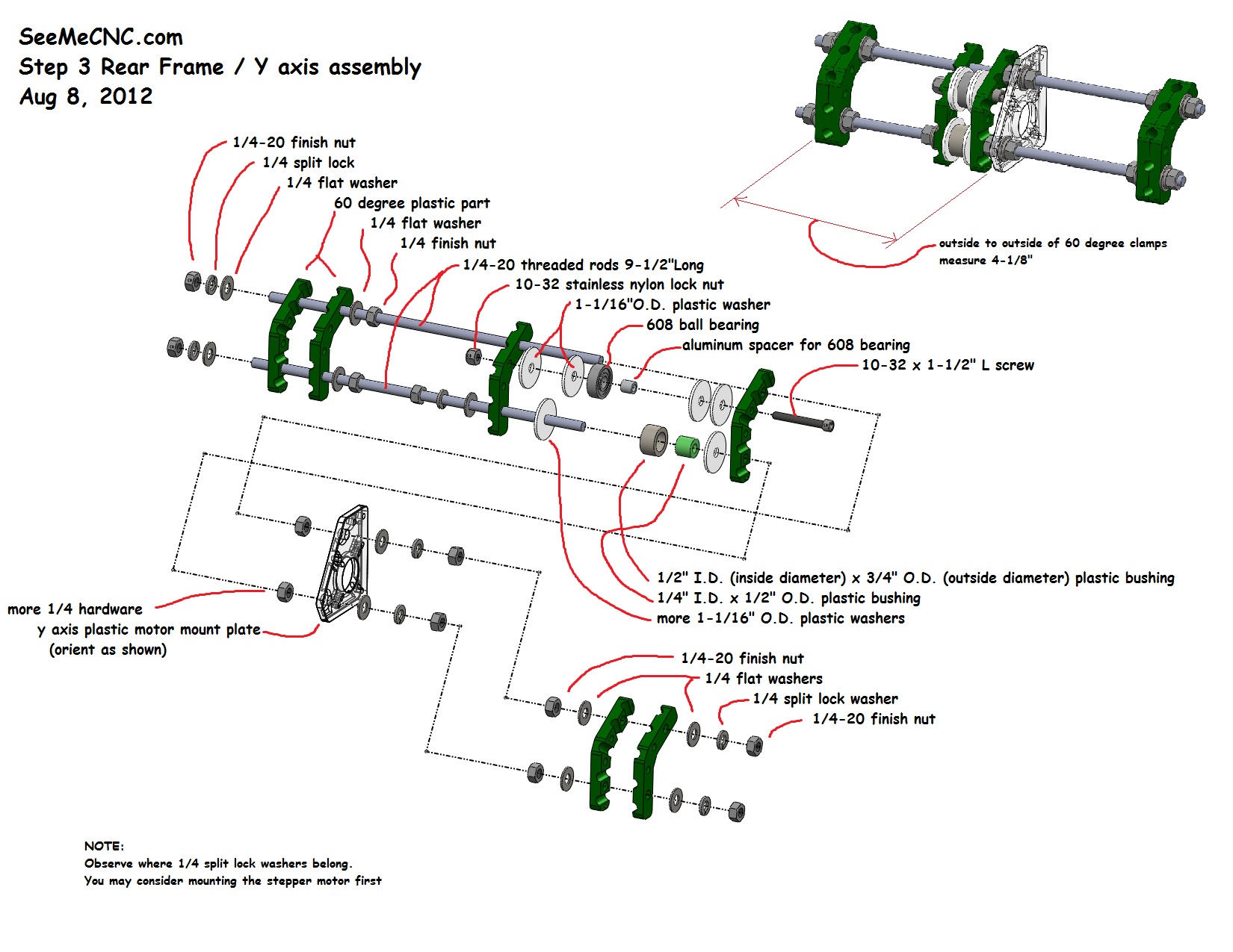

Machine Assembly:
Starting with the base of the machine. Orient parts as shown. The #6 x 1 sheet metal screws hold together cross bar clamps. All threaded rods are 1/4-20 x 12"L. R4ZZ ball bearing held in by #6 x 1/2" sheet metal screws and will require one drop of super glue from the bottom side to secure them.

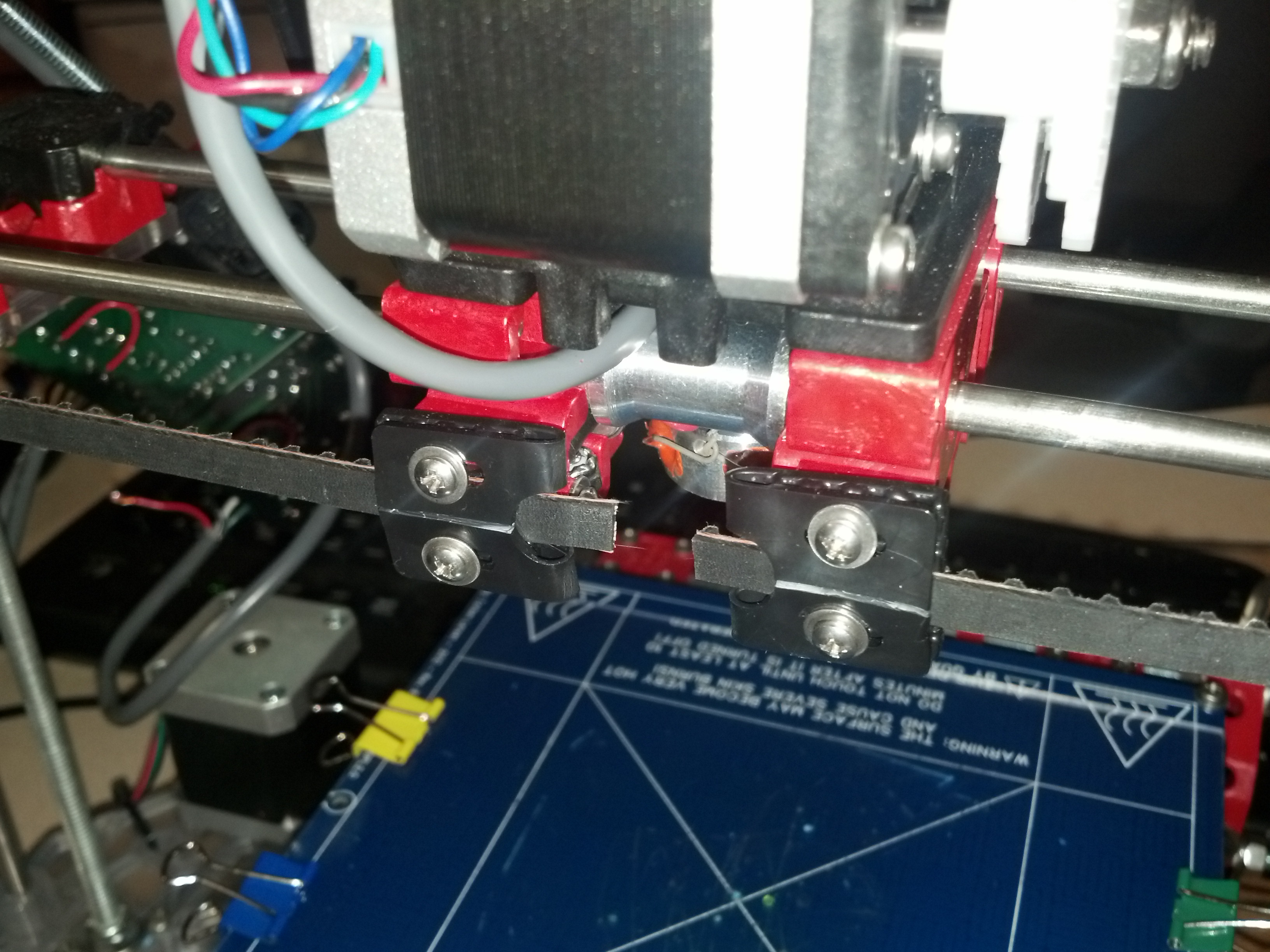

does anyone know how the belt clamps work?
Re: Couple Questions
Posted: Tue Aug 07, 2012 6:20 pm
by jasco13
They fold in half with two screws through them and belt in between. Toothed side of belt goes against toothed side of clamp

jasco13 wrote:They fold in half with two screws through them and belt in between. Toothed side of belt goes against toothed side of clamp
that works for the y axis belts but not for the x axis belts. There is no holes for the x axis belt clamps to be screwed to. do we have to drill those holes ourselves?
Posted: Tue Aug 07, 2012 6:46 pm
by jasco13
That is the only way I can see to do it. I looked at that for about 15 minutes last night trying to figure out another way and looking at the pics posted on the SeeMeCNC storefront site it looks like we will have to drill. Just hope I get it right the first time.

Doug we both mean drill 4 holes for the clamps to screw to instead of just the belts screwed to it. that way you dont have to worry about stretching out a hole in the belt

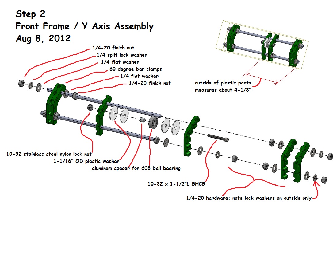

All hardware 1/4" size is 1/4-20.
It is possible for the stainless steel to gull. So a small drop of lube is recommended. If you turn the nut or bolt slow, it usually won't gull. (Gull, get a burr, seize, or lock up when threading together).

H1.1 Step 2

Here's a picture of the belt clamps of my own invention.
I recommend pre-drilling a 3/32 hole. 1/16 hole will work too.
The #4 x 1/2" sheet metal screws are for belt clamps (the length of screw is measured under the head of the screw, and as a side note, flat-head screw lengths are measured over-all length)
No1 screwdriver
do not over tighten
