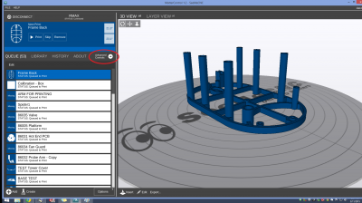

Adjust the EEPROM values from MatterControl (edit: What Gene said)
1. Get MatterControl through our download page http://seemecnc.com/pages/downloads
2. After installing MatterControl, setup your printer
3. Choose the COM port & make sure the baud settings are 250,000
4. Make sure the printer is selected, plugged into your computer, and click CONNECT
5. Once connected, click 'advanced controls' (see below)
6. Select configuration then EEProm settings
7. scroll down to horizontal radius and enter a new value & click save to eeprom
8. home the printer and run the calibration scripts again to check results.
Usually it takes a couple of trys to get it right.

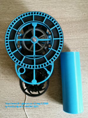

Looks like somebody is making a clock..... but the question is will they print the planetary gears or opt for the easy way out?
- Posts: 1407
Re: Fudged Up!
I'm going the easy way first,, Clear pla for the mechanicals, red abs for the frame.KAS wrote:Looks like somebody is making a clock..... but the question is will they print the planetary gears or opt for the easy way out?
Re: Fudged Up!
I did the same, well I printed everything one color the easy way. I'm going back to reprint certain parts for accent and tryout the harder gear set.
I still have to source the metal parts and build it.
Re: Fudged Up!
Sorry Prozac, didn't mean to hi-jack your post (hehe)
I'm taking the easy way out first. Then the mechanical engineer in me will print the planetary gear set once everything runs smooth. The MAX behind my desk was buzzing through these files in December while I was working on Eris molds. Sorry, I don't have the hands on it in this photo. I used steel pins lying around the shop for axles. Right now, it runs 30 seconds and hangs because of some first layer squishing on a few gears. We've been super busy at the shop, so it's been an on-off project with my son in the evenings.
