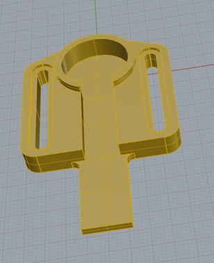

Take a look at the STL file I posted about an hour ago in your HA thread. It will screw to the top melamine plate with 2 screws - 1 in each slot. This allows the FSR position to be tweaked so they do not bind. This worked well on the kossel mount I made and this new mount can be used on kossels, rostocks or any printer really.

Not sure what you mean by screw holes? I am going to be drilling new holes to attach these to the top melamine plate with some self-tapping screws.
I'm happy to send source files if you'd like. These are Rhino but I could export in most anything.

I don't want to drill through lexan. :) If you can export as STL, that's all I need. Thanks!

Ok, I already uploaded the STL in the other (your) thread.
