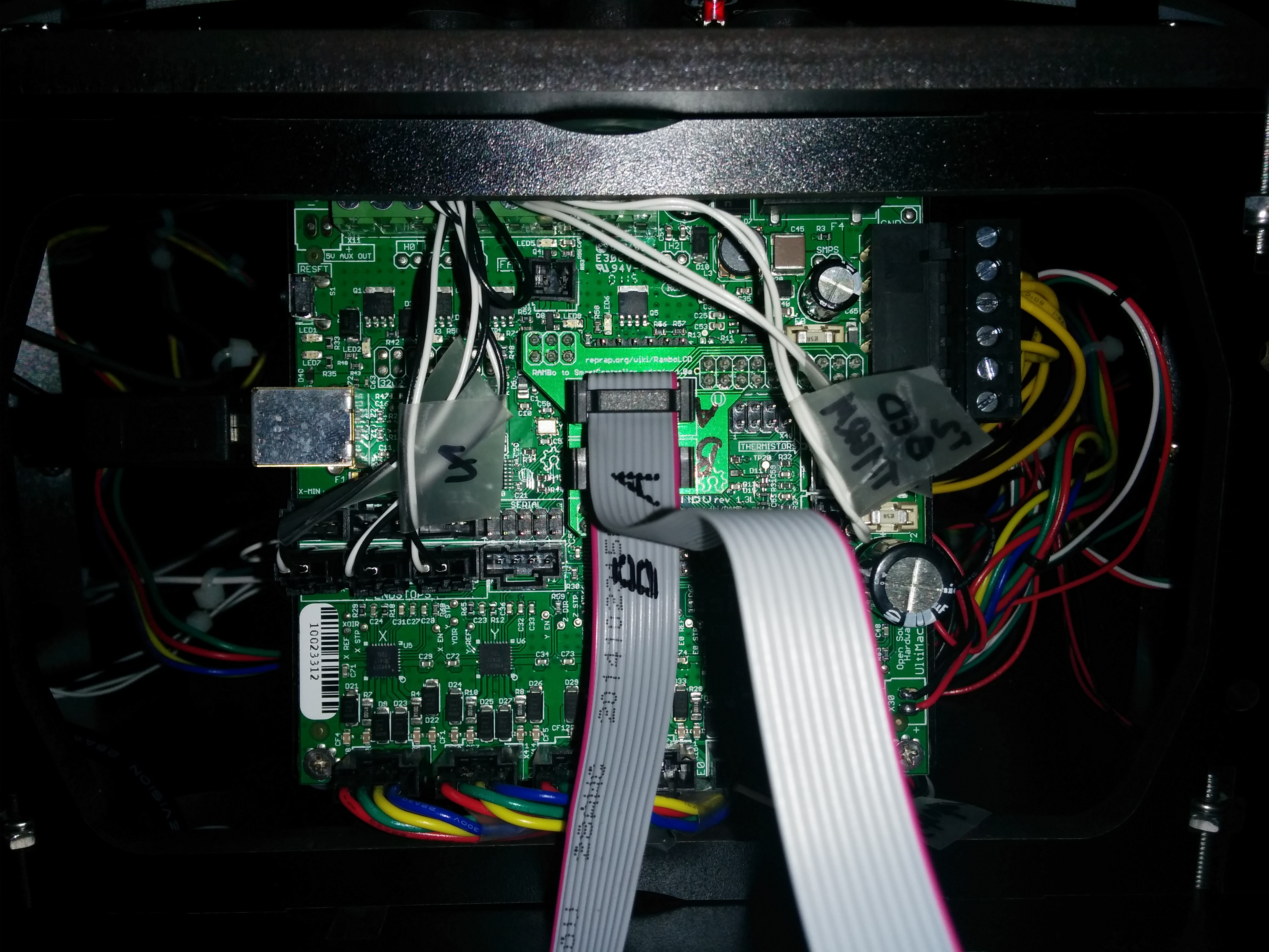

I have just recently finished building the Rostock Max V2 3D printer, but I am having issues since loading the firmware onto the Rambo. When I initially loaded the firmware and turned the printer on the hot end moved to the hot bed and ran into the glass before I could catch it. I realized I had an inverted platform and fixed that part, but the hot end just goes straight to home when I turn the printer on. This may be what is intended, but this leads me to the real problem.

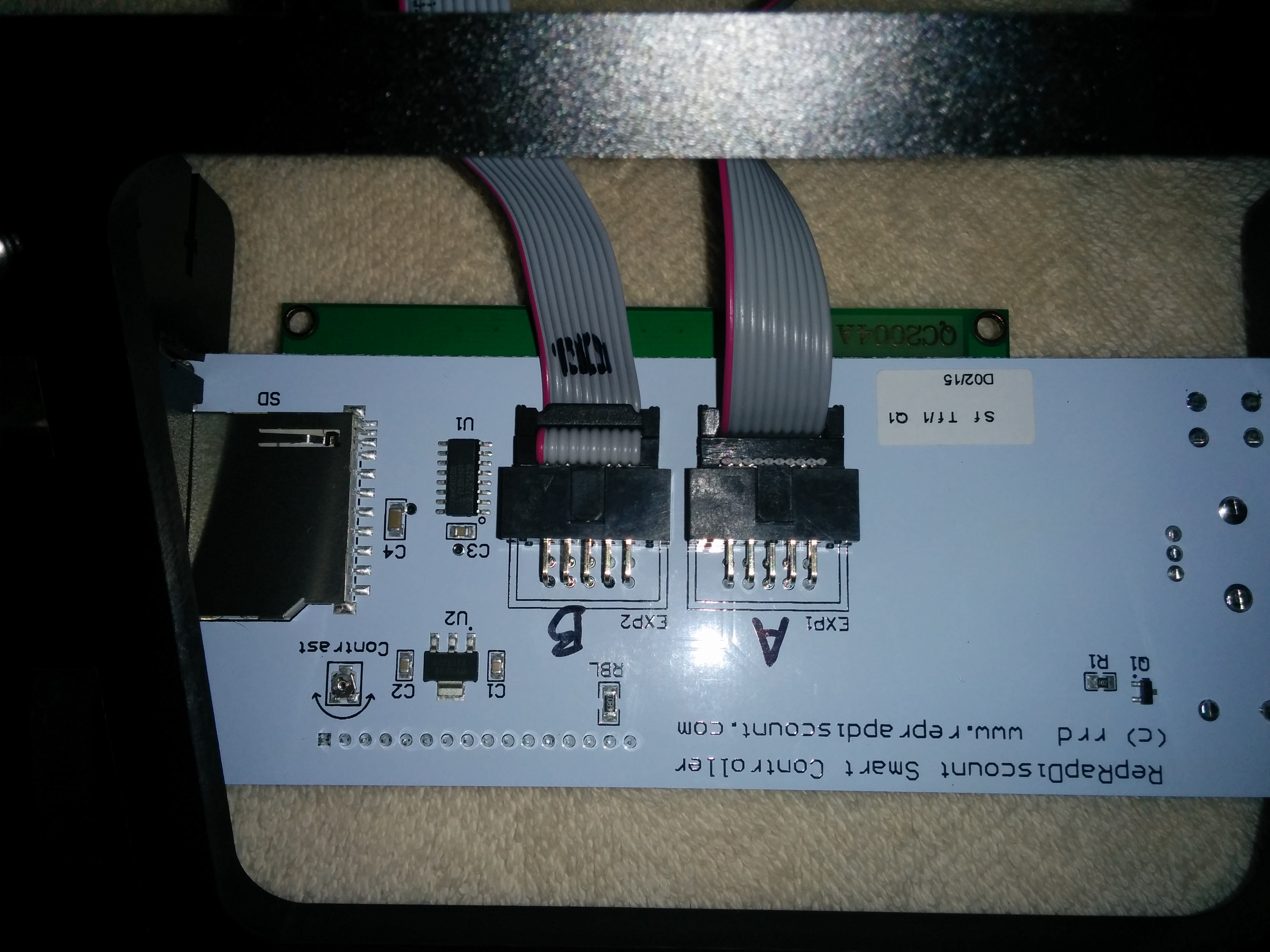

When I turn the printer on one of two things happens. First, it will display the home screen and everything seems to work fine. I was even able to begin calibration. When it came time to use the knob on the LCD panel to toggle through menus the printer would go into repetitive reboots whenever I rotated the knob. I can push the knob in without this happening, but any time I rotate the knob it begins doing this.
The second thing it does is go immediately into this repetitive reboot cycle as soon as I power the printer on.
I have looked for a similar problem throughout the forum, but I have only found something a little similar and that was only fixed by a replacement Rambo, which I hope I don't have to do.
I submitted a help ticket with SeeMeCNC Support Desk, but after almost 2 days of waiting I am getting a little impatient waiting around. Has anyone had a similar problem? I have retraced my steps in the instructions and tried reprogramming the Rambo several times with no luck. I rechecked all my connection on the Rambo, but have found nothing incorrect. Before I begin to disassemble further I would like to get some feedback to what this could possibly be. I have attached images of my LCD to Rambo connection just incase someone notices something wrong. Please help.

Earthbound
Posts: 458
Re: Printer rebooting repetatively
Post by Earthbound »
How about a picture of the backside of the LCD panel, while it is still plugged in. The pic above shows the B cable is flipped at the RAMBo adapter.

Earthbound
Posts: 458
Yep, the B cable needs to be turned around at the RAMBo adapter. Red stripe on the right side for both cables at the adapter. See page 197 in the manual for reference. Actually, if you take the B cable out and swap which end goes to each board, it will fit better (and match the A cable!)
justwhat21
Noob
Posts: 4
Joined: Mon Mar 16, 2015 8:53 pm
Post by justwhat21 »
Awesome!! Looks like that took care of the problem. I was really hoping it was going to be something as easy as this rather than taking stuff apart or getting replacements. Thanks so much!!
