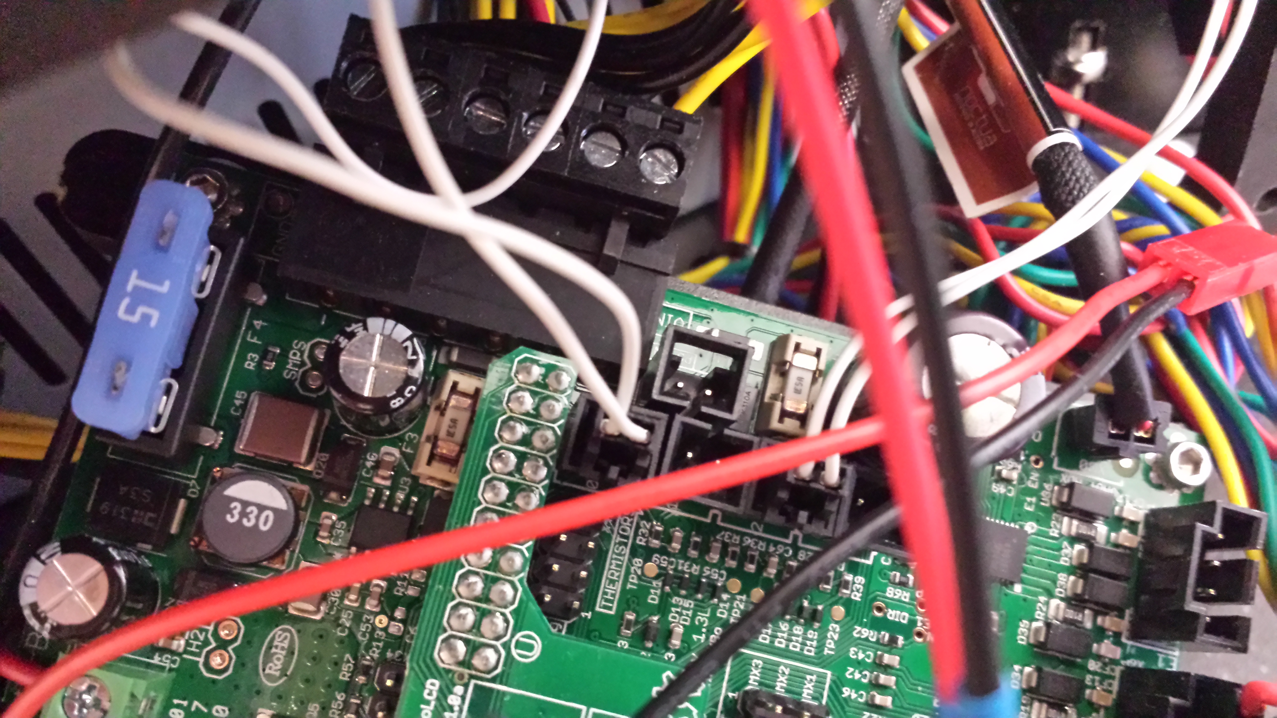

You can check prior to making up the hot end... Just plug your new thermistor directly into your Rambo Nozzle thermistor connector and turn on the Orion.
If your Nozzle temp is the same as your bed temp at room temp then your probably ok.
White wires to black connector to "Thermistor 0" is the Nozzle thermistor connector on my Orion
Just done it on mine and checked my thermistor this way before I made up the hot end with a new thermistor I picked up in the UK... was the same btw on mine.
