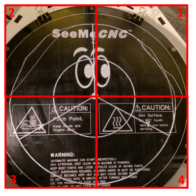

Okay I was very much wrong, I am still having issues. I squared all the towers recalibrated and then I ran the circle test (this one: http://www.thingiverse.com/thing:50505/#instructions)
And I ended up with this:
When looking at the outer circle:
Quadrant 1 and 2 (top right and left) were off the bed with zero adhesion as you can see.
Quadrant 3 (bottom left) was a little high but adheared
Quadrant 4 (bottom right) was too close to the bed
Looking at the inner circle though was pretty much great! The center dot was a little close to the deck but not too bad.
Looking around on the forum I cant seem to pin point the issue. And its messed up every print Ive tried for the past week (for obvious reasons) even after constant calibration. Any ideas? thank you all again

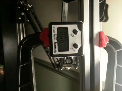

It's honestly still going to come down to mechanical calibration somewhere. Couple things I ran into when building mine. First, none of my framing carpenter squares were not 90 degree square like I expected. You can test this a few ways but draw a sharp line pencil (x-acto line is better) on a piece of paper, flip the square 180 and draw another line beside it. Measure the distance with a set of digital calipers at the base and top to get an idea of squareness.
Next was the left/right tilt of the tower that the manual didn't cover. I ended up purchasing a Wixey WR300 Digital Angle Gauge from Amazon which solved this issue and the one above. It's way easier to zero the gauge to the bed and align each tower while it's clamped to the towers. I'm not sure how you can check/correct without having a digital gauge.
Also, used the depth gauge of the digital caliper to set the heated bed height at each screw to the same distance from the melamine base. This just lowers the chance of any waviness from over/under torquing the screws.

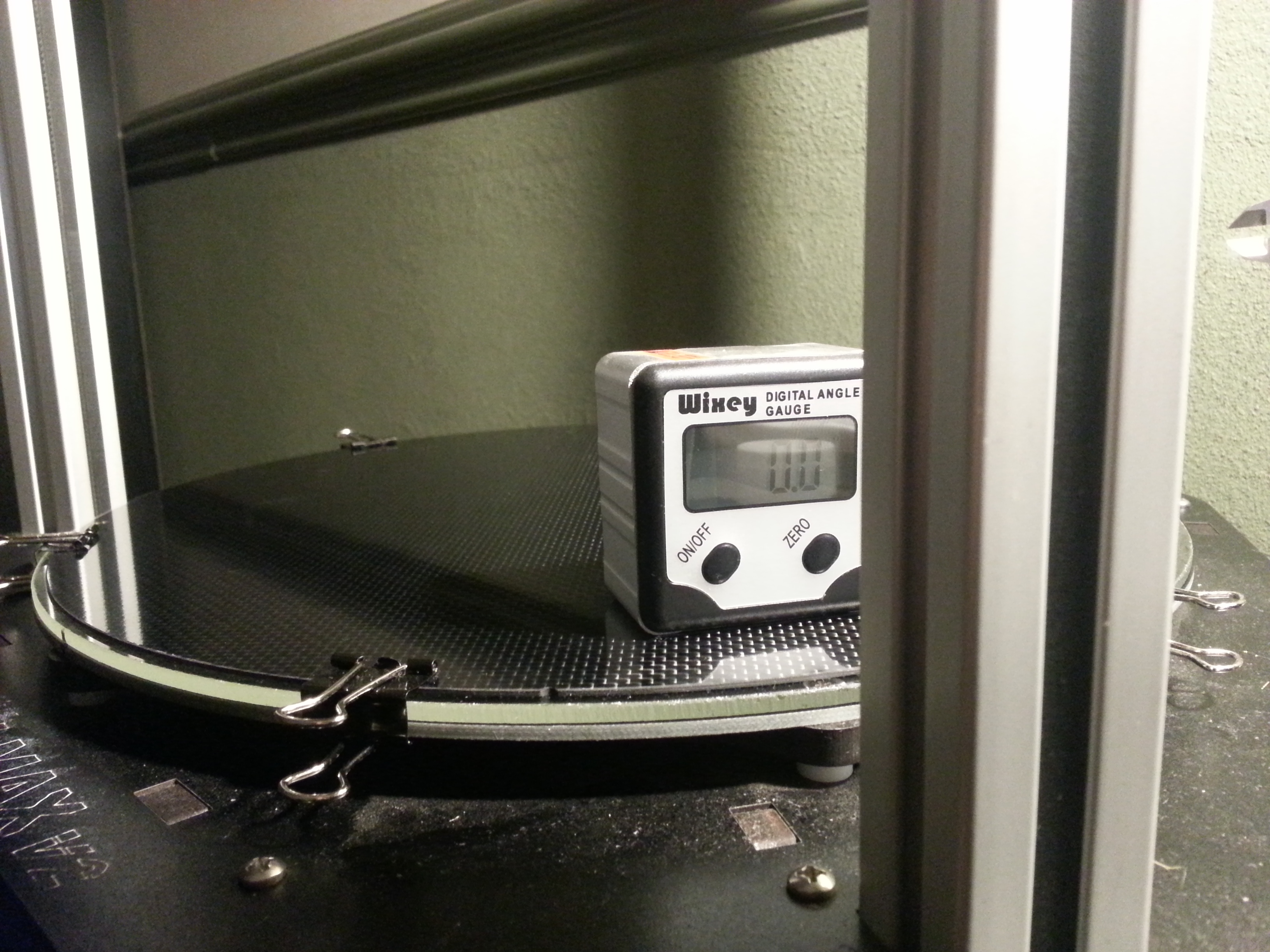

Nope, you had it right the first time. Loosen the top and bottom screws from the towers.
Place the digital gauge parallel to the axis you want to square and zero it out.
Place the gauge on the tower somewhere up high and clamp it.
Curse and get pissed as you perform this same routine over and over while trying not to mess up the 90 degree square in the other direction. Tighten one screw then check the front/back of the tower by re-zeroing the gauge parallel to that axis. Hopefully when it's all said and done, everything will be tight and 90 front/back and left/right to the build plate.
Crappy lighting in this room,
