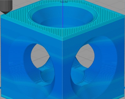

In Simplify3D I get beautiful circles/arcs.
1.00in Cube Test - Simplify3D - 0.2mm

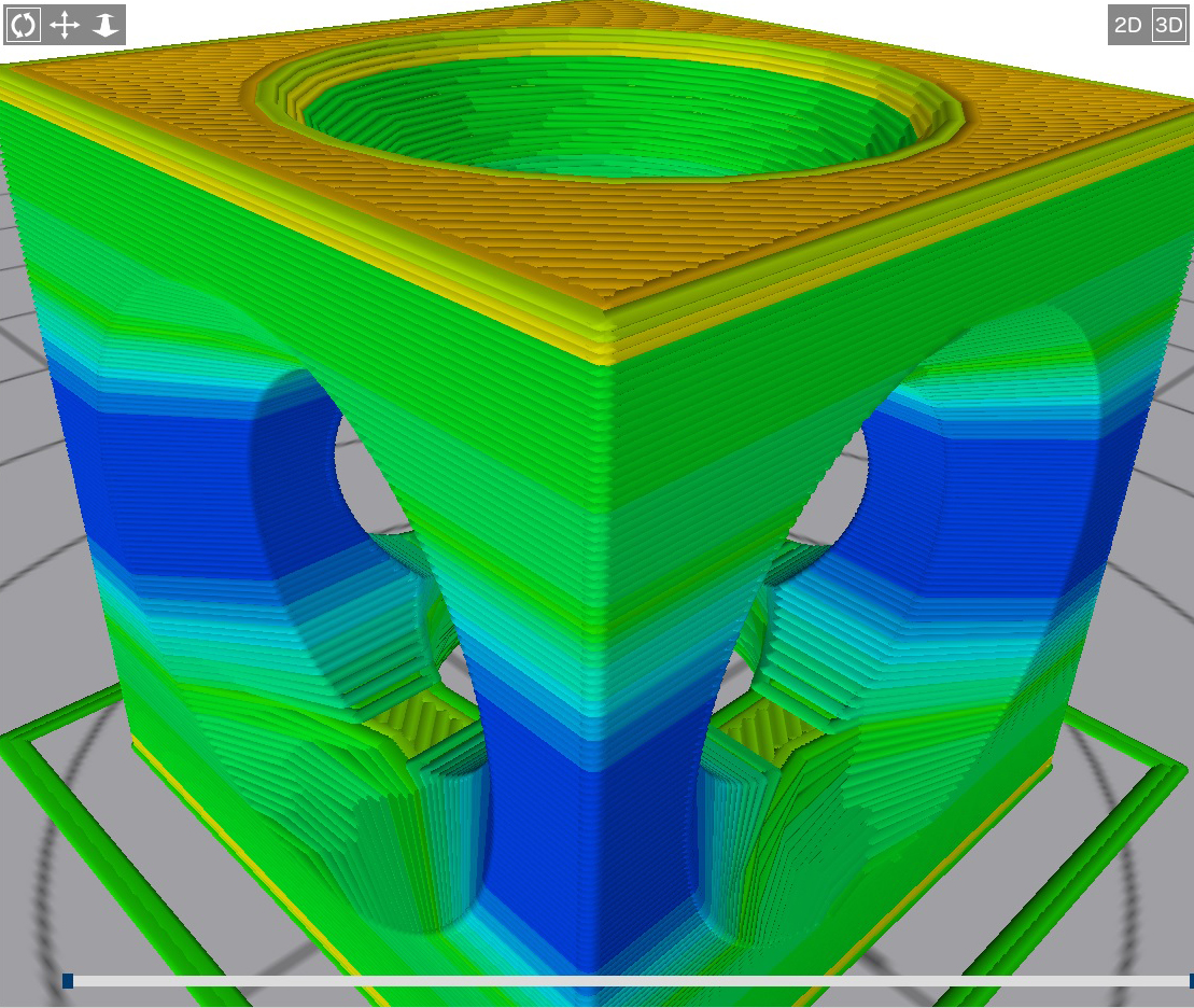

In MatterControl's Slic3r I get beautiful circles/arcs.
1.00in Cube Test - MatterControl - Slic3r - 0.2mm

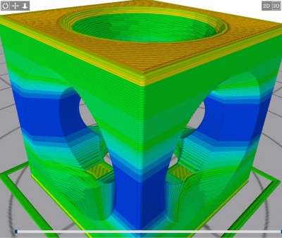

In MatterControl's Cura I get beautiful circles/arcs.

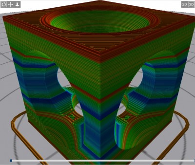

In MatterControl's MatterClice I get very bad circles/arcs!
1.00in Cube Test - MatterControl - MatterSlice - 0.2mm

Attached see screenshots of the top countersink and side countersinks using Matterslice, Slic3r and Simplify3D.

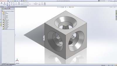

A friend of mine drew up this test cube to test squareness at 1.000", holes at 0.500" with a countersink at 0.750" using SolidWorks.

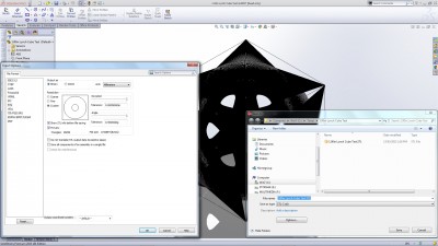

Here are the screenshots of the part and the export settings to .STL from within SolidWorks.
SolidWorks File:
1.00in Cube Test - SolidWorks
SolidWorks Settings for File:
1.00in Cube Test - SolidWorks Settings
I've noticed before on other "round holes" come to think of it from downloaded things from Thingiverse, that there was this "basket weaving" action taking place only using MatterSlice withing MatterControl.
Is there a fix for this? Export at a much lower resolution??

Given your images of the export I'd say it's a MatterSlice issue, it's probably re-samplng the geometry, I don't use it so I can't comment on if there is a setting to fix it.

Quick Update - This issue have been identified and addressed in MatterSlice. The fix will be included in the next MatterControl update.
More info on the problem here:
https://github.com/MatterHackers/Matter ... issues/204
To quote:
The final analysis of this was that this model was exposing a very subtle bug in clipper. If there were a very large number of edge points on a relatively shallow curve, one can't just merge each as they walk the curve in order or they can collapse curves that have small enough inter point deltas but a large total curve.
Imagine a very tessellated circle. As we walk the edge, each triple we find can be collinear within our error and so we remove the middle point and move on to the next point. The new middle point is very close to the new third point and so we collapse and remove the second point. We can remove and create a large flat on the edge of the circle.
