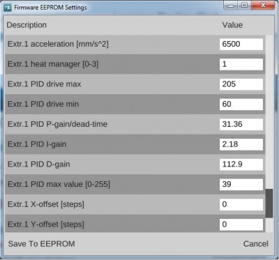

After searching through the bowels of the internet, I can't seem to find any relevant information regarding the PID autotune timing out. I installed my E3D V6 on my rostock this afternoon and it can't seem to go above 100~ C.
The only modification to it is that I also installed a screw-on thermistor at the same time. I changed thermistor type to 8 per the e3d installation guide, then found some info on the forums that it should be 1 instead. Tried both but had the same outcome, temp slows to a crawl and all but stops around 100C. Finally, i removed the thermistor, and when i hold it between my fingers it registers the temperature change. Assuming its not a problem with the thermistor.
Has anyone encountered this before? Would you guess that I have something configured wrong in the software, or possibly a faulty heating cartridge?
After reading trough these forums for a few hours I have come up with nothing, but I could just be doing something incredibly stupid. Thank you for all your help.

What does the thermistor read at room temp? What are your EEPROM settings for heating and PID? The P, I, D, max and min, and other settings?

NOZ reads 23.6C at room temperature.
Went ahead and took a screen shot of the PID portion of EEPROM settings

Your PID Max value is really low. Should be at 255. Probably is your problem.

Well that did the trick. I was looking in all of the wrong directions for a solution. Thank you so much.
