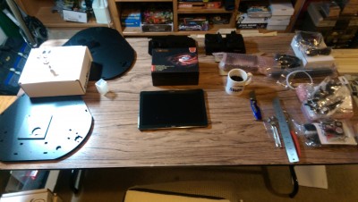

Howdy All,
So it begins.....
Parts all setup and ready to go...
All the parts are un-taped; not nearly as bad as all the posts made it sound :)

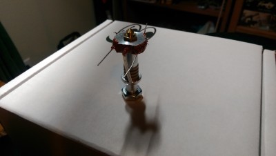

Got the hot-end assembled. Here in San Antonio, the Permatex Ultra-Copper High Temp RTV was available from Advance Auto, AutoZone shows it discontinued. Want a bunch of blank stares? Go to Home Depot or Lowes and ask for Kapton tape. Ultimately, ordered it from Amazon. Hot end is now sitting, as recommended, curing.
Hotend curing
Hotend curing

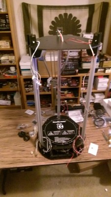

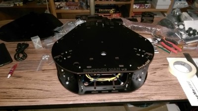

Day #2 -
Got the stepper motors, upright supports installed and to top of the base completed.
The only part about the instructions here was the orientation of the wires from the stepper motors. I had to take one apart and rotate the stepper motor 180 degrees to get the wires where I wanted them. I suspect it doesn't actually impact anything other than some OCD.
Next up to the get the Onyx bed pieces attached and then install it on the base.

Day #3 - So, not the fastest builder in the world, but only getting about 1.5 to 2 hours per day to work on it.
Got the Onyx bed wired up and installed on the base. Getting the components soldered to the Onyx was surprising painless and everything took the on the first try. Helps to have a good soldering iron.

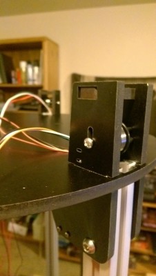

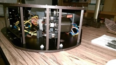

Day #4 - Got the uprights wired and assembled to the base and then the top base installed. It's actually beginning to look like a printer :)
Only minor issues for this day:
- The #4 3/8" Sheet Metal screws that came in the kit don't seem to be the correct type. The supplied screws can't actually bite into the 'hole' (slot) in the top support. So, I picked up a few from Lowes. The picture in the instructions show the correct type of sheet metal screw, but what was in the screw bag was different.
- When putting together to top supports the instructions say that the support with block screw goes to the left, but I couldn't find anywhere it said which side was up on the top base. A couple pages later there was a picture of fully assembled top base.
So far this has been a fairly relaxing build; well, I'm moving at a relaxing pace at least. The instructions are actually quite good and easy to follow.
Beginning to look like a printer
Top support, w/ the sheet metal screw in the bottom slot.

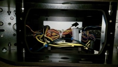

Day #6 - Finished getting everything wired up and connected, and put the finishing parts on the printer.
Went to do the 'smoke test' and no power. ATX power supply fan isn't turning on when the switch is turned on. I checked the switch to make sure it was working and it checks out good. I disconnected the power supply from the RAMbo to check to see if maybe there was a short, but looks and continuity checks good.
Possibly a bad power supply from the start; that would be really really unusual, but not unheard of.
Now I need to try to figure out how far apart I need to take it to change out the power supply.
Re: Alamo-Bot Build
Posted: Sun Mar 29, 2015 9:54 am
by Mac The Knife
Power supply should drop out through the opening in the bottom.

Re: Alamo-Bot Build
Posted: Sun Mar 29, 2015 4:05 pm
by kellyds
It....... Lives.......
Installed a Corsair CX750M power supply
It has a modular cables, meaning, fewer wires behind the PSU. Downside? All the wires are black, so trying to find 6 yellow and 6 black is REALLY challenging and you have to be very careful.

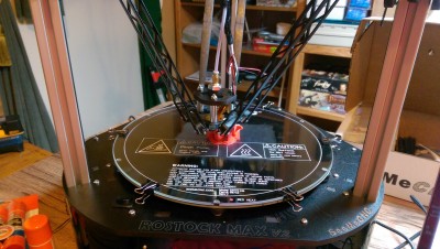

Day #7 - Build completed and first print came out incredible!
It is really quite amazing to see this printer go to work and start printing. While building it was a challenge, it wasn't a frustrating challenge. It was a great deal of fun. Even better is when the first print 'just works'.
Kudos to the SeeMeCNC team for creating such a wonderfully engineered kit!
Big thanks to the word of encouragement from the forums here; this is really a great community!
Printing in progress; PEEK fan shroud
