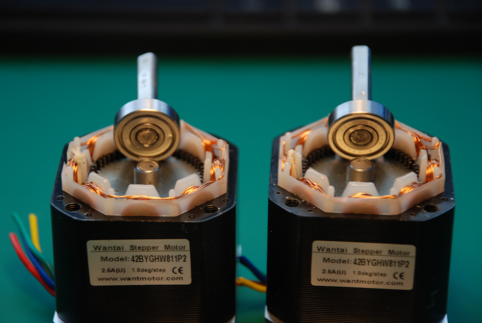

For 2 weeks, I lost two motors one by one (at first have the X-axis and then along the axis Y). they cracked shafts !!! pictured seen this Wantai motors:
Now I need to replace them.
I know that later RM2 versions are supplied with motors Kysan.
Question: Which is better motors, Wantai or Kysan ???
Now I can not trust Wantai? Is it worth it to replace all the Kysan?
Say what?
Thank U

I personally prefer the Kysan motors. They're rated for a higher torque, have longer wires, and they run at a lower current.
I've never broken a stepper motor, Kysan or Wantai, so I can't speak to the difference in their durability. It would take a lot of force to shear the motor shaft, so I'm almost suspicious of a manufacturing defect in China.
I can comment that the Kysan motors are slightly louder, but that's kind of a side point.
Re: Hello from Russia!
I'm not claiming you did this, but the stepper motor bearings are not designed for a lot of lateral force and it's easy to put way too much force in that direction by over tightening the belts.
Having said that I'd expect the bearing to fail before the shaft cracked, so I agree with possible manufacturing defect on this one.

Could the motors have been damaged in shipping. I've gotten a couple of boxes of motors from China and one box had obviously been opened for inspection and repacked...wrong. One of the motors looked perfect but barely turns.
Almost looks like a bubble or hollow section where the shaft broke. Most likely a manufacture defect but that still would of taken a great deal of force from the belt to break a shaft on the other end of the supported bearing. I would of thought the melamine or belt would of gave out before something like this happens.
A manufacturer defect is the only thing I can think of because both types of motors perform well with 3D printers.
Good luck with the new motors.
