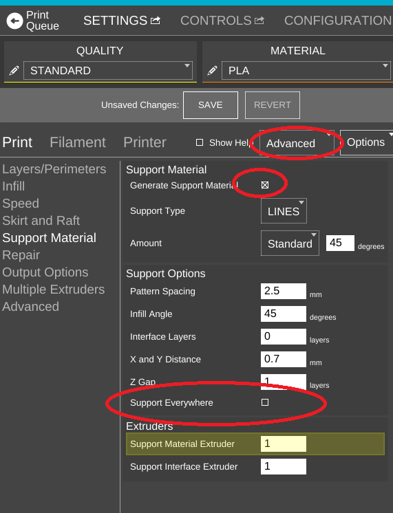

I have a question about something that has been driving me crazy. In the settings for MatterSlicer, you can check a box for Support material. My assumption was that if you checked that box, it would automatically create and print out support material for any overhang greater than 45 degrees (or whatever angle you sent in the preferences).
However, I have never been able to get that to happen. I'm always forced to go to an outside app like Meshmixer or Kisslicer to generate support material.
Is my thinking wrong? Is this not how it works or supposed to work? Any insight would be appreciated.

Without seeing your .stl models its tough to say if this is the fix or not, but there is a checkbox in MatterControl for "Support Everywhere" If left unchecked this will only enable support to be generated when it can start from the bed. If checked it will allow support to be generated anywhere (including internal surfaces) on the print that the meets the threshold.

So this is in addition to the support material check box? If so, where is it located?jjjohnson wrote:Without seeing your .stl models its tough to say if this is the fix or not, but there is a checkbox in MatterControl for "Support Everywhere" If left unchecked this will only enable support to be generated when it can start from the bed. If checked it will allow support to be generated anywhere (including internal surfaces) on the print that the meets the threshold.

Before switching to another app like Simplify3D, I wanted to try everything to get MatterSlicer to work. That screenshot is very helpful and I will try that tonight to see if it makes a difference. I'm also still awaiting response from Matter Hackers to see what they say. I appreciate the help!KAS wrote:I've had several issue with MatterControl myself and after switching to Simplify3d I haven't regretted the decision. Only thing I use MC for is calibration because of the EEPROM interface.mvansomeren wrote:So this is in addition to the support material check box? If so, where is it located?jjjohnson wrote:Without seeing your .stl models its tough to say if this is the fix or not, but there is a checkbox in MatterControl for "Support Everywhere" If left unchecked this will only enable support to be generated when it can start from the bed. If checked it will allow support to be generated anywhere (including internal surfaces) on the print that the meets the threshold.

Thanks to help from Matter Hackers' Christopher Moore, MatterSlice is happily generating support material beautifully. The Key is the field next to the Support Type drop-down that is labeled "degrees" By default that number is Zero. So even if you check the "generate support material" and/or "support material everywhere" box(es), nothing will happen. The number he suggested was 40 and sure enough, support material is generated! Thanks to everyone that provided input. I hope this information is of help to others in the future.
