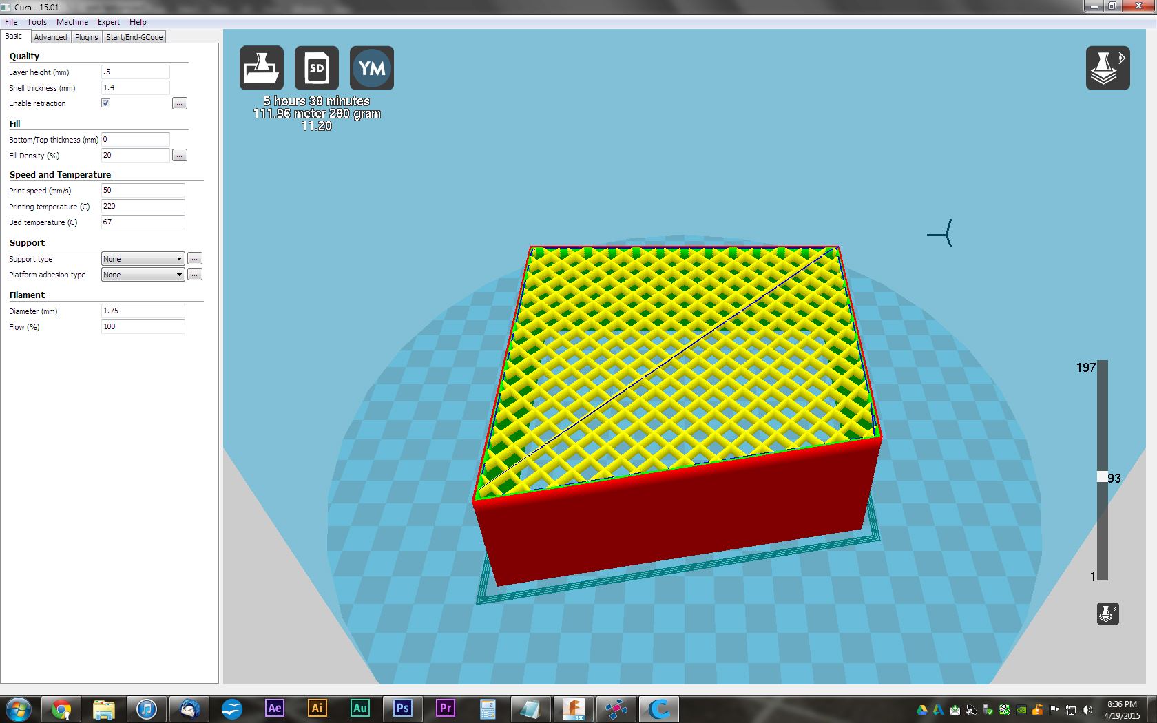

As summer is approaching i have been toying with the idea of 3d printing a motorcycle seat for myself.
The reason is that i want a completely mesh seat. In the summer my arse is soaked by sweat.
The seat is approximately 45cm long. And only secured from both ends.
Obviously it will be a multi part print. I was thinking of first separating the seat design in two parts horizontally. And then printing it in 15-20cm slices. All stuck together with acetone with two threaded rods going through securing everything on the bottom.
Any ideas recommendations?

10cm thick sections with 2.5cm jigsaw style interlocks to lock them together in X/Y and rods to lock Z once assembled should hold together pretty well.

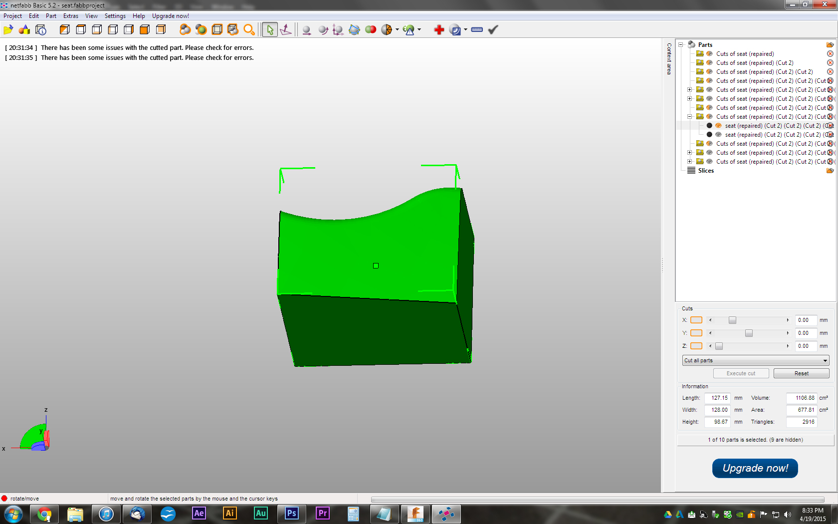

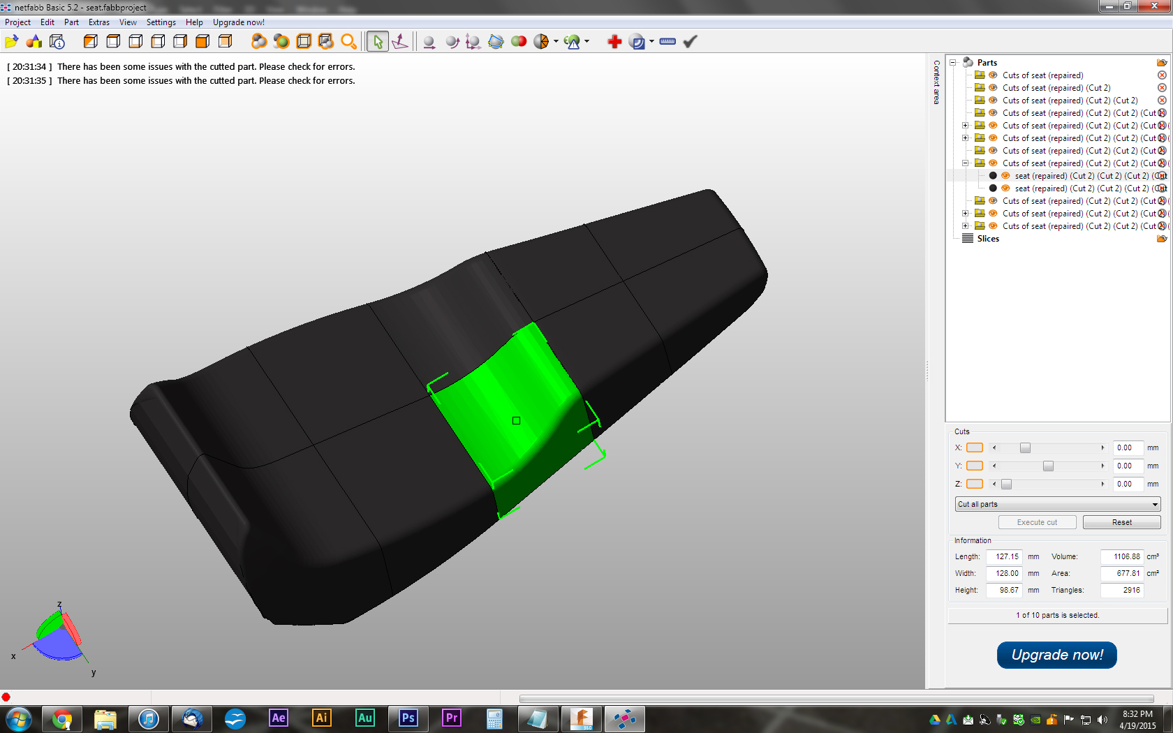

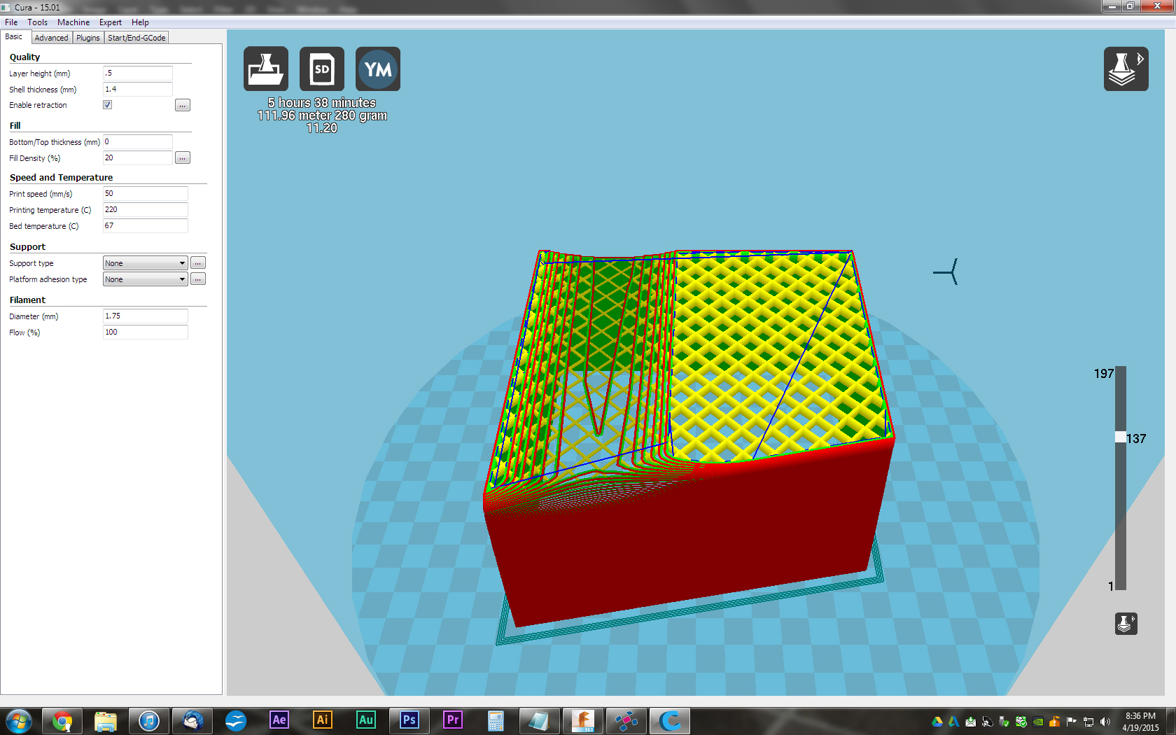

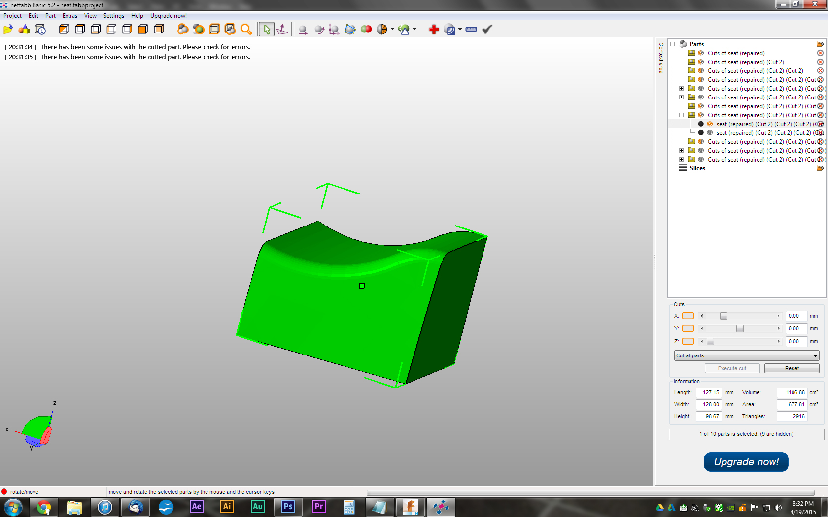

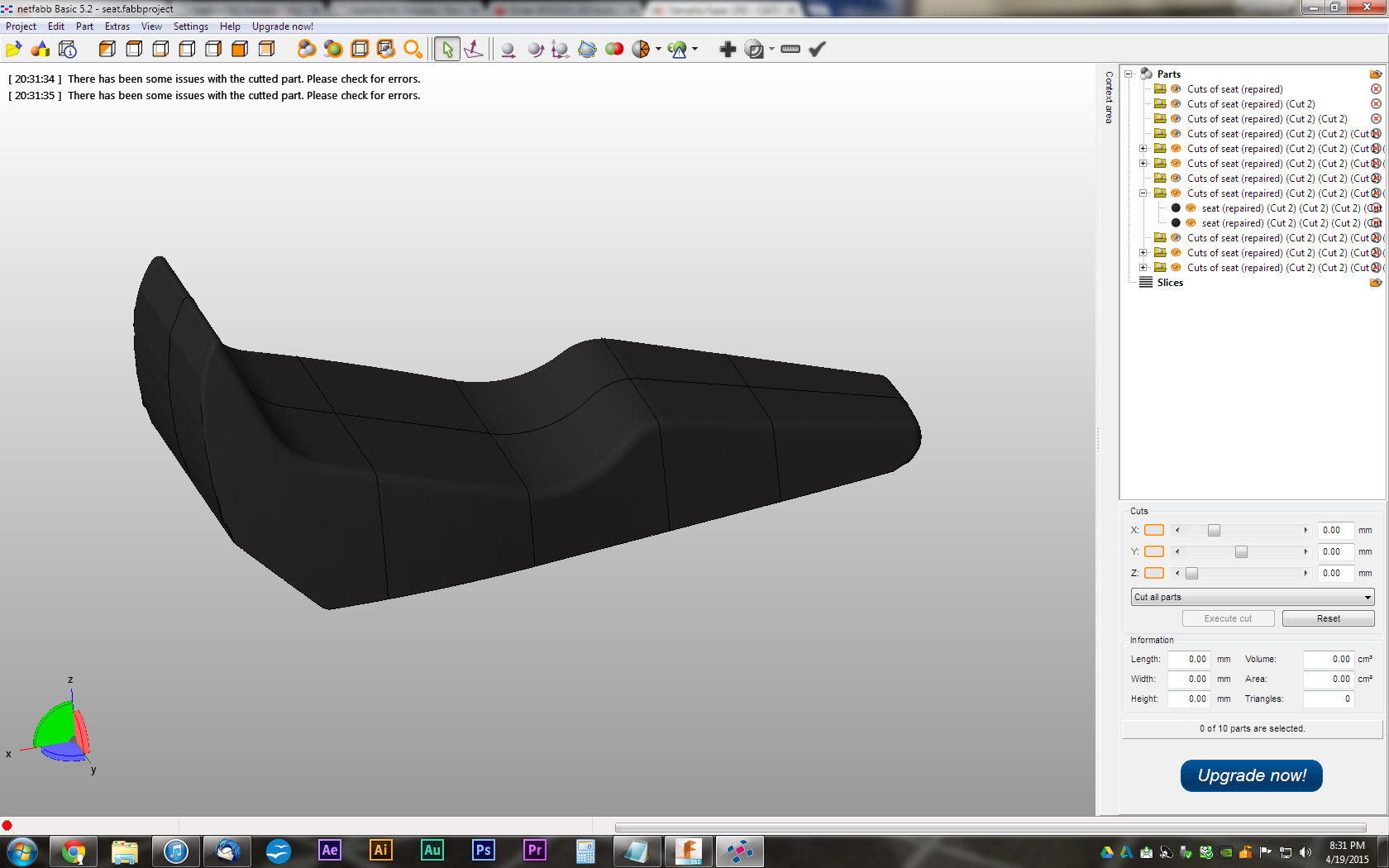

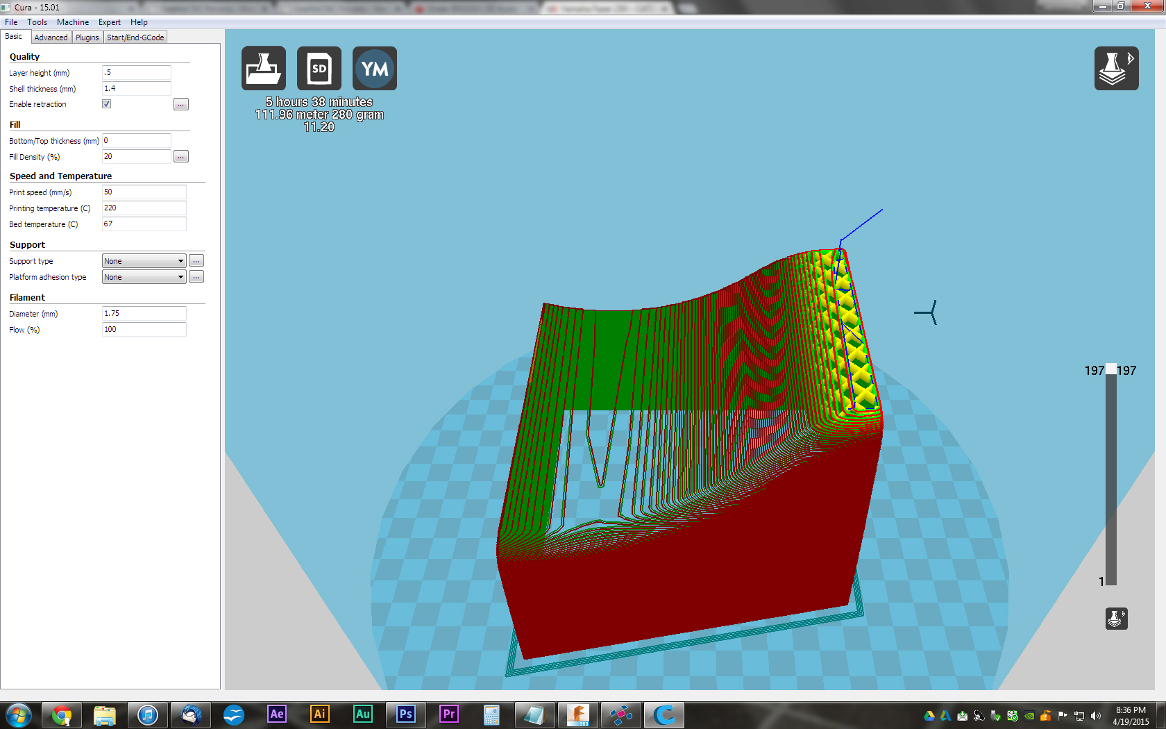

Model the seat, or find a model. Cut it up, print it with the bottom down with no top and bottom layers, and use the infill to make the "mesh" pattern. Glue the pieces together and/or make a bracket to bolt them together.
I made up an example, and discovered a limitation to this technique. If there is too much of a contour, the perimeter lines will completely "fill in" the open mesh, as is seen in the photos.
