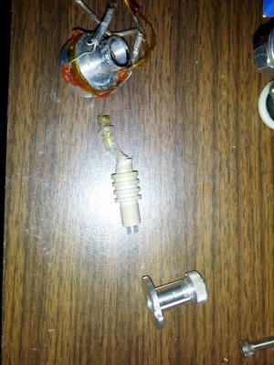

Almost there.. I hope. Was ready to go but had a meltdown. I think the temp was just too hot, I do hear the relay on MK138 so seems to be working. Using multimeter with probe but readings seems to change quite a bit depending on touch location. Any way, have some PEEK and Teflon tube on order. I was thinking of extending the length of PEEK to lower the head away from the carrage some. (Seems very close) Or turning a new top part to do the same. Anyone care to comment? downside?

Experimenting with the design is part of the fun for some people. So try it if you want to! Only minus I can think of is that your max build height will be reduced by however far you extend it.
But I don't think the distance from the carriage had anything to do with this particular meltdown. From the picture, it looks like the hot end just got way too hot, assuming the damaged end of the PEEK came out of the hot head. So you need to figure out why that happened.

Yep, I agree RCA is in order. That is why I tested the setup after meltdown and without changing the pot setting. about 235-240 C, before starting the print I thought I was running about 210. Just too hot or thermistor short when in motion.

Not too worried about reduction of Z by 1/2 inch or even an inch, just seems the clearance should be more than about 3/16" (sorry, brain does not think in metric)
