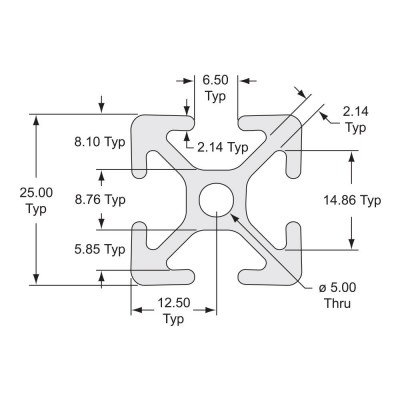

I have recently purchased some long 25mm (not 1 inch) T slots from the overstock at 8020 and I wanted to custom build a large printer using the trick trucks from trick laser. Will the extra .2 MM of play on either side kill the gimmick though?

Here are the dimensions in metric:

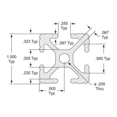

And the dimensions of the 1 inch T Slots seemecnc uses:
.255 inches = 6.477 mm

The difference betwen 6.477mm and 6.50mm is negligible. The slots are essentially the same size for this purpose.
However, the difference between 25mm and 25.4mm is not. That's 0.4mm of extra adjustment inward required to make it work.
The openbuilds cam looks to be able to offset a maximum of 0.79mm from center. (last picture is dimensions: http://openbuildspartstore.com/eccentric-spacer/)
So, it looks like it could work, assuming there is sufficient adjustment remaining in the assembled unit.
Or you could make a special request to purchase an adjusted trick-truck, with holes moved slightly. Worst they can do is say no.

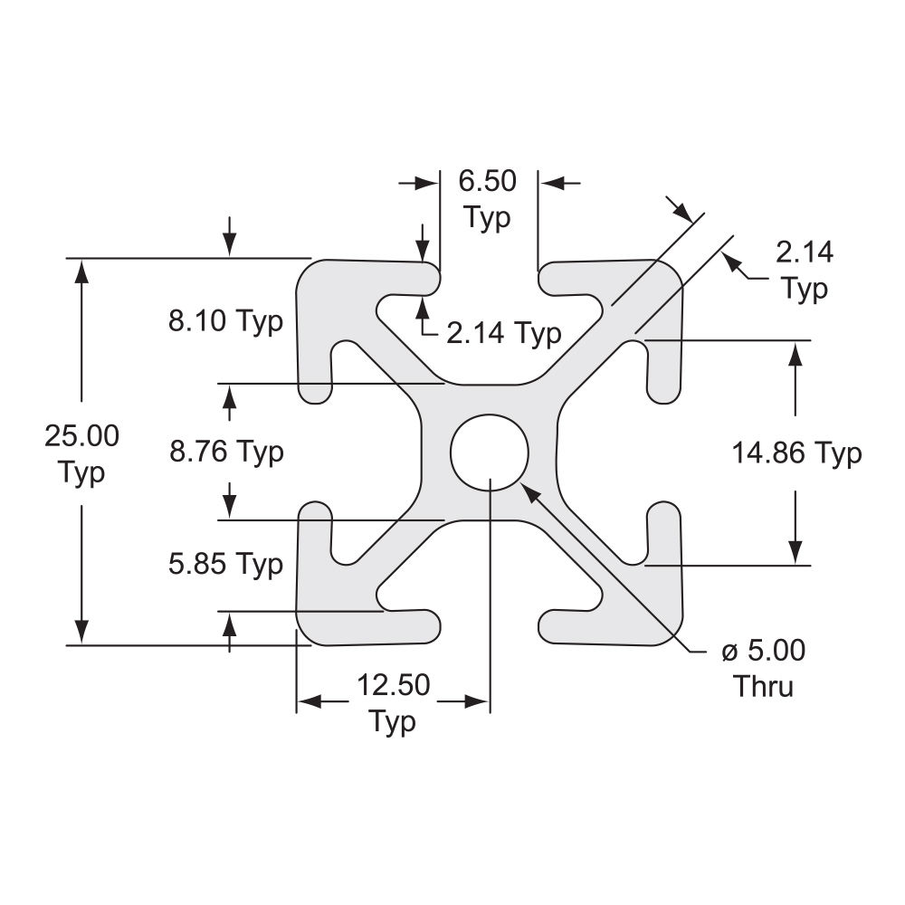

25.4 - 20.0 = .4mm = .016". The trick truck has a center line based on the 1" extrusion. Cut the difference in half and you get a center line shift of .008". This creates a lateral skew and not an equal rotational change. End result is shifted delta geometry unless you compensate.Eric wrote:I've no idea where you got .008", that's too small a number.ccavanaugh wrote:It will shift the truck off center by .008". Depending on how accurate you want to be on your prints, this essentially skews the rotation.

So I got a response back from them saying they wouldn't work, I'm not quite sure why since the eccentric spacers look to have enough movement in them to account for the .2 mm difference on either side. I asked for a custom copy with the holes moved slightly. Waitin to hear back.

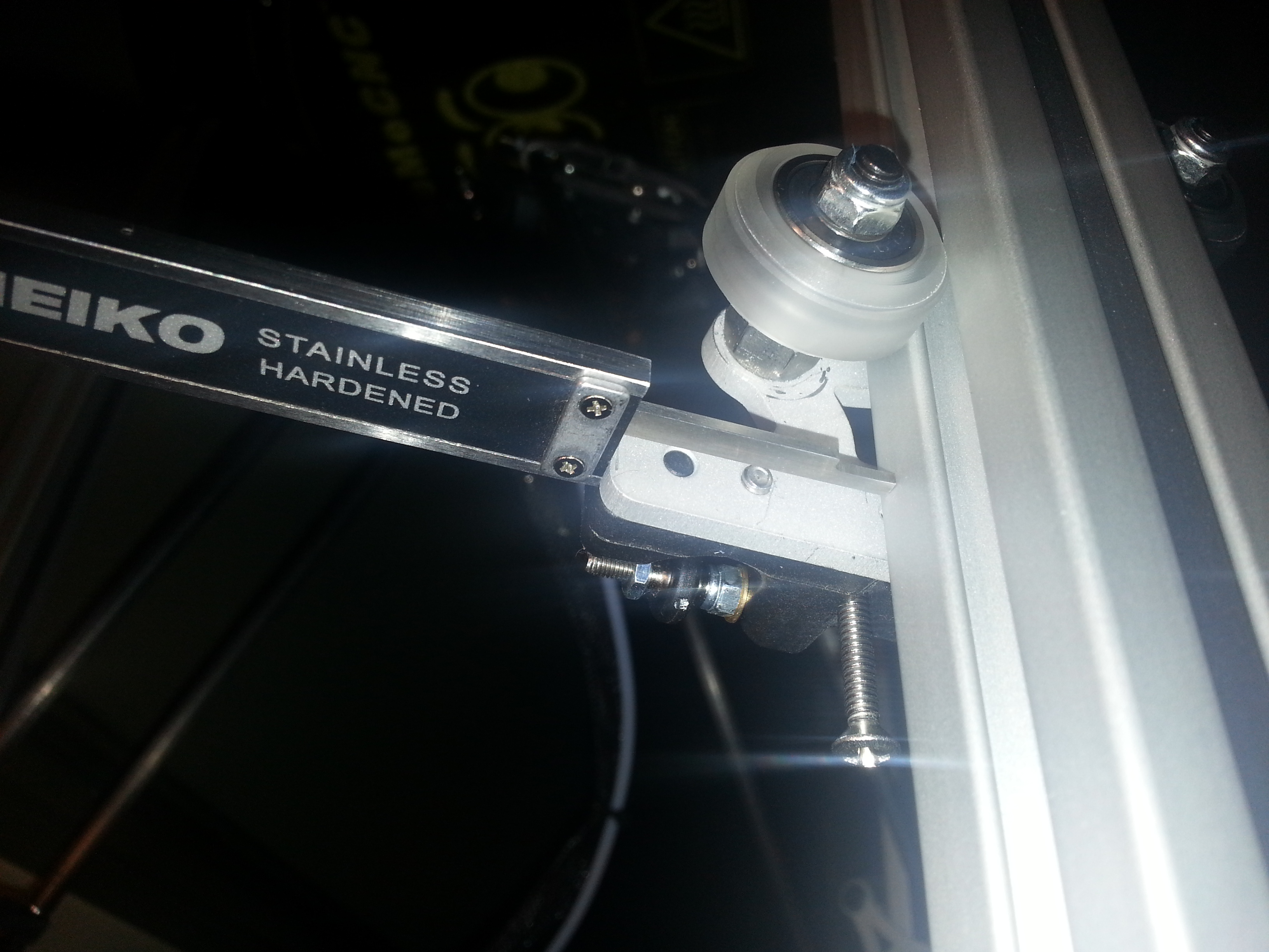

Re: Will Trick Trucks work on 25 mm T Slots?
The truck is designed such that the centerline of the pivot matches the center line of the extrusion, since the wheels on one side are fixed if you mount them on smaller extrusions that center line will move which introduces motion errors. The offset would be half the difference in the width of the extrusion, as noted above by cavanaugh.
You could design and fabricate a bracket that would shift the pivot points to account for the offset in which case they could be made to work.

No, ccavanaugh was right, the offset from center is only half the total adjustment required. After 0.2mm, the fixed wheels are in contact with extrusion and that's as far off-center you can go, although all the adjustment happens on one side.
Which does suggest a possible solution for a stock trick-truck. Drill out the fixed bolt-holes to the eccentric cam size and use cams for all three wheels. That gives you the ability to adjust from both sides and a lot more total adjustment. Of course, it also means adjusting everything properly will be significantly more annoying.

I measured my Trick Trucks from the flat section to the extrusion. Both sides of the extrusion are not equal: 27.05mm on the left, 27.30mm on the right
Each tower is about the same in regards to the difference from left to right.
Can someone else verify this? Just curious if the trucks are actually designed to offset the eccentric cam for a true center or not.

The Trick Trucks are designed so the arm mounts are centered on extrusions.
Measure from 1/8" pin holes to extrusion for a true measurement. Or take off arm mount and measure to hole in center, under the belt.
Even your current measurements are only .25 mm different, which is only .0049" off center. I honestly do not think that amount will affect anything. All 3 towers would have same amount of shift.
If this really bothers you it would be simple to shift the arm pairs by putting extra .125 MM (.0049") thick "shim washer" on one side of arm axle. That is about the thickness of two pieces of copy paper.
