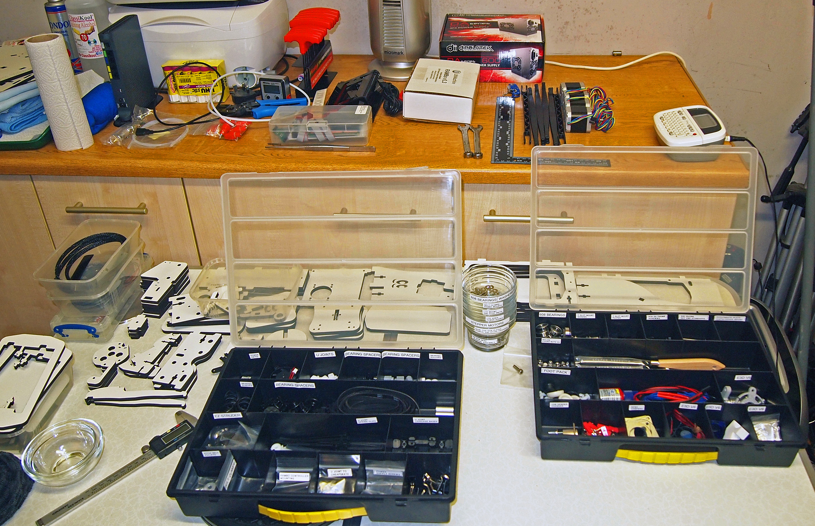

After weeks of research and now some spare time available I started my build.
I'm incorporating a E3D V6 from the outset along with some other small mods - also building stock head as a spare. Didn't currently have a printer so got a proper mount for the E3Dfrom sculpteo with some custom aluminium rods courtesy of my Bro's Lathe.
preparation:
I opted to label everything - it certainly made the job easier for me and I'd recommend it to other new builders :)
After 5 hours on day one of the build I go to this stage:
As I was fitting the nema astroysyn dampers from the outset there were no screws needed for the fitment in the kit - However I have kept all my PC bits and pieces from builds over the years and I can inform you that hard drive enclosure screws are perfect for the job of fitting the dampers to the motors ;)

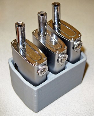

And here are just a few Of the resultant prints I've managed to download or design and print..
Single perimeter pen holder
Maintenance dock for Vaping Gear
