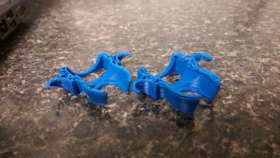

				Ok. I was looking around for what could cause what I was experiencing, and I saw some things about calibration of the horizontal axis and z-stop calibration. However, I think it is an extruder problem. This is a picture of the print that I was working on last night when I had to stop it.
-  Failed PEEK fan print
So I started looking at it again today and it seems like the extruder isn't pushing the filament down the bowden tube. I can sort of push it manually, but not really. This is at temperature (which MatterControl set to 228 for this ABS material). I'm not sure why it printing a good part of the part before it stopped working. Any thoughts?

				Re: New Rostock Troubles
				Posted: Thu May 07, 2015 9:19 pm
				by Tincho85
				clogged nozzle maybe?
I can't print Blue abs at 228ºc, min FOR ME it's 240ºc with that material, but each brand is different.
Before cleaning the nozzle, try raising the temp.

				Thermistor could be reading low.  Can verify with a thermocouple as as Eaglezsoar said.  Low temp would make the EZstruder struggle to push the ABS.  If the EZstruder is slipping, you should hear a sharp knocking sound when it slips.
If temp is ok...
In the setup process and calibration, did the nozzle hit the bed?  Could have an obstructed nozzle if the tip crushed down at all.  I killed a stock nozzle with a bed strike once.

				cyber.shifter wrote:...But then, how would it have print the first half of the object ok? I did see some slipping of the extruder, and when I pulled the filament out, it had wear marks showing it slipped. ...
There is a good clue.  It worked pretty well at first.  So it appears to have stopped extruding the correct amount after awhile.  Causes could be:
1. Hot end cooled off because heater stopped.
2. Nozzle clogged for some reason possibly because the temp was too low for that filament and your setup.
It can be helpful to measure the actual temp of the nozzle, however you also have a relative measure.  That is to raise/lower the temp until the filament extrudes properly.  Assuming you don't exceed the max temp range of your extruder if you can.

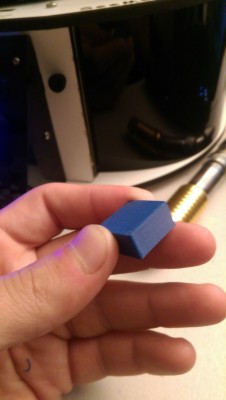

				Got the nozzle cleared by heating it up. Used a single strand of the 18 gauge wire to do it. Also, reflashed the firmware and re-calibrated, this time with less "grab" on the paper. Finally, did a test print with the extruder temp set to 235 and got much better results.
-  Calibration Cube!
It's only the calibration cube, but the layers look much better than before.

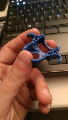

				Still having trouble with printing. Second time I'm trying to print the PEEK fan shroud. I'm not sure what's going now.. The second time looks much better on the layers, but they both ran into the issue at almost the same layer.
				Posted: Thu May 14, 2015 7:21 pm
				by Dale Eason
				My guess is that the hot end temp is too low.  It is just on the edge of being too low and eventually the hot end plugs.  I would try increasing the temp by 5 or 10 deg as an experiment.
