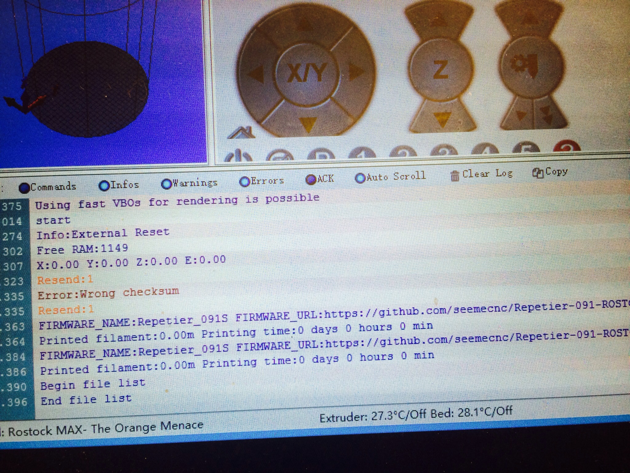

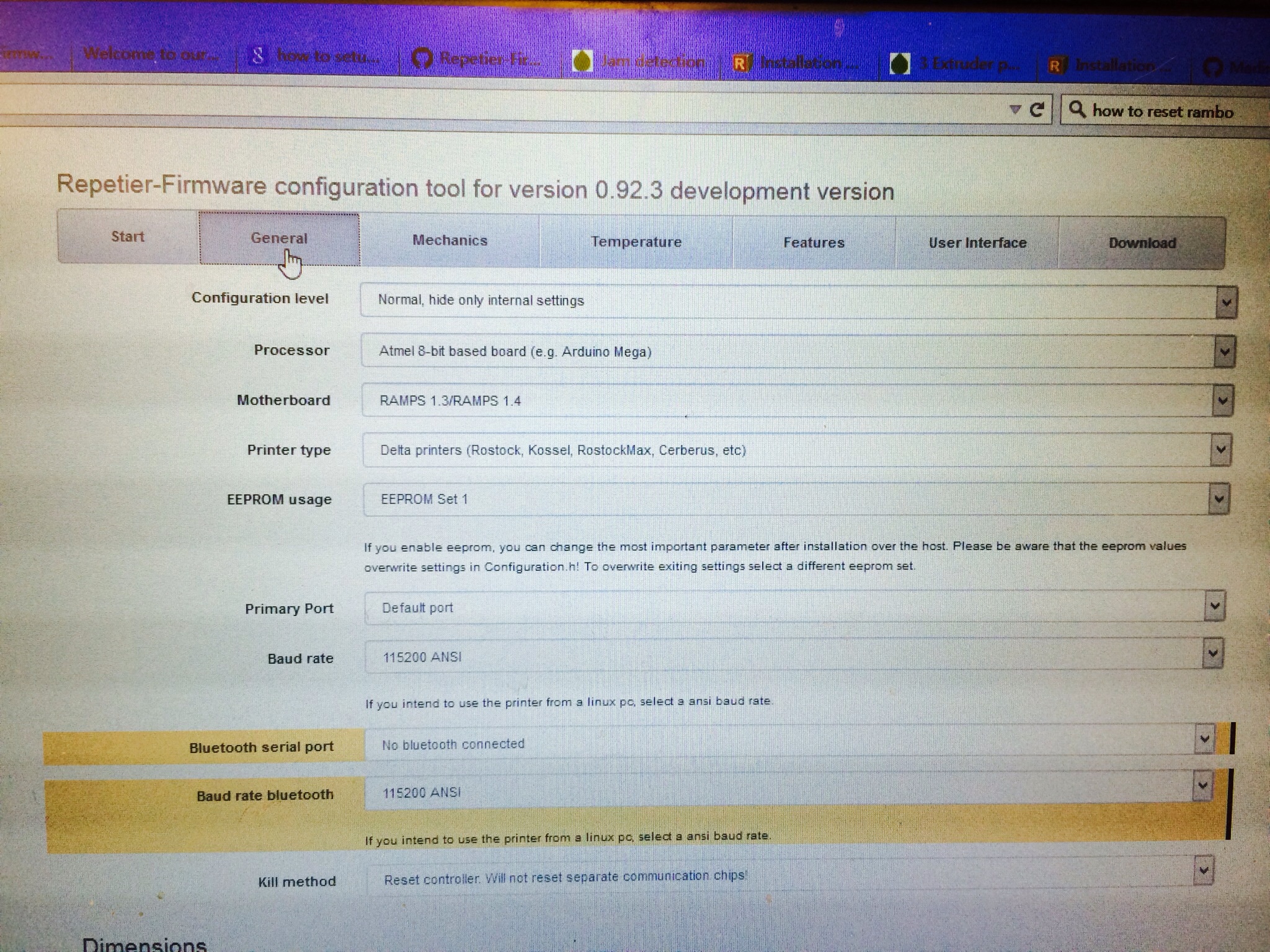

Hi guys, since we wrongly used firmware 0.91, our LCD and G-code do not work. We tried to upgrade the firmware but we do not know where to find informations of our Rostock V1.
And can anyone tell us how to fix the g-code part?
Thank you!
How to fill out the form of Firmware 0.92.3?

Hi, if you are new, don't download a development version, use the last stable.
And I think you should use the Repetier Firmware from seemeCNC, it's pre-configured for our printer.
https://github.com/seemecnc

Oh, and before uploading the firmware, clear the EEPROM first.
Open the Arduino IDE and load the example called "EEPROM Clear".

Hi, we have already upgraded to 0.92.3, but when calibrating the PID, the second one cannot be sent and every time we start the printer, it will tell us to resend
Re: How to fill out the form of Firmware 0.92.3?
You really should go get the 0.91 version
