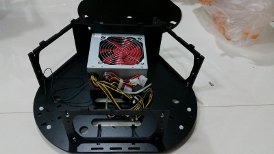

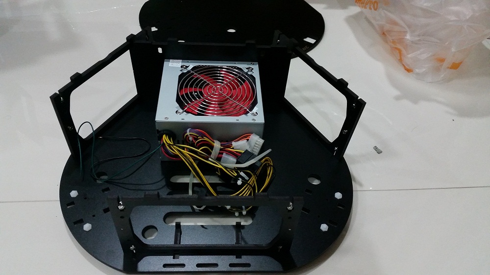

Power Supply Attached

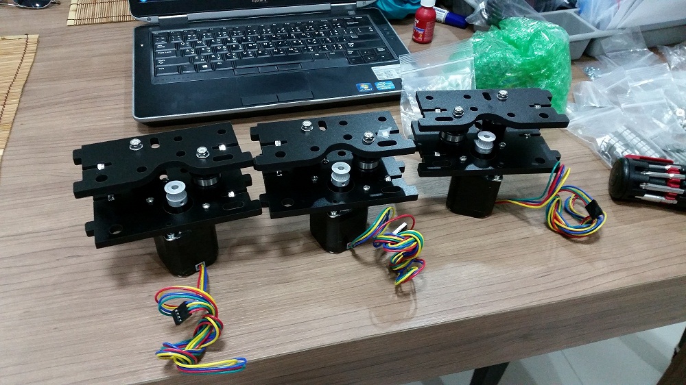

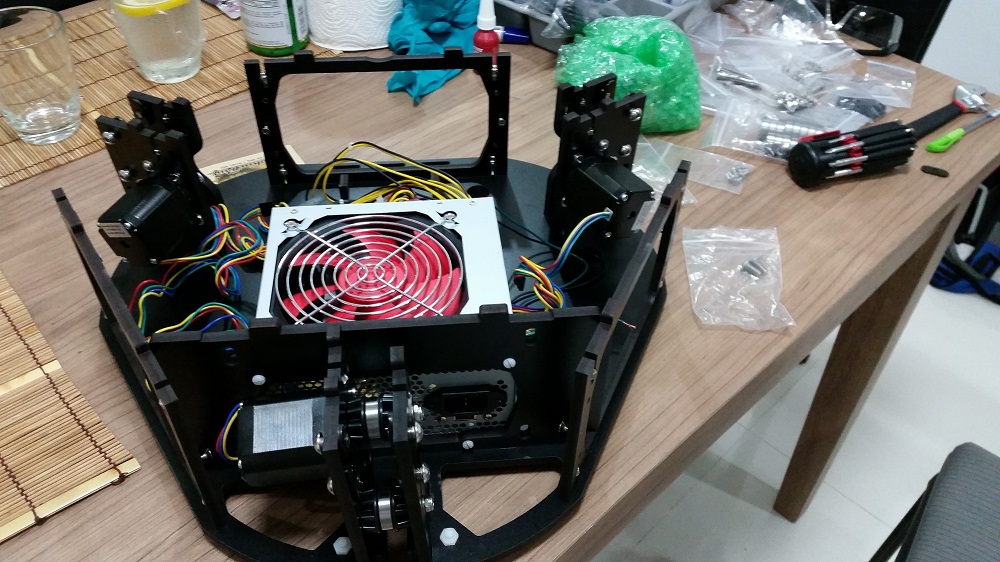

Motors attached to mounts

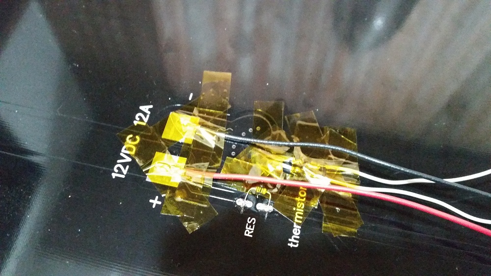

My first real soldering work. It didn't turn out too bad.

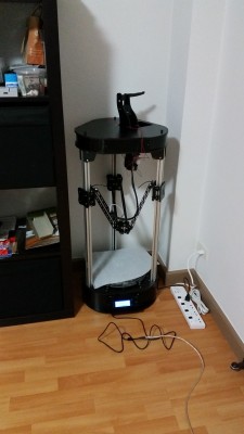

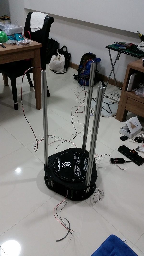

Here I've routed the wires and attached the towers.

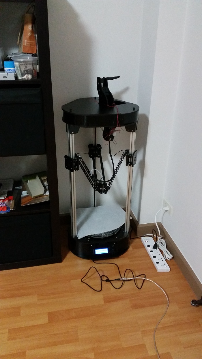

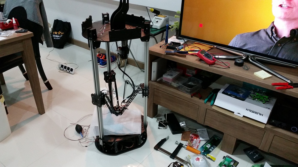

Finally got the hotend wired and the arms attached. If I hadn't scaled the picture down so far, you might be able to tell I inverted a couple of the arms. I already went back to fix those after my first calibration fail.
It actually turns on! Now if i could just figure out the calibration...

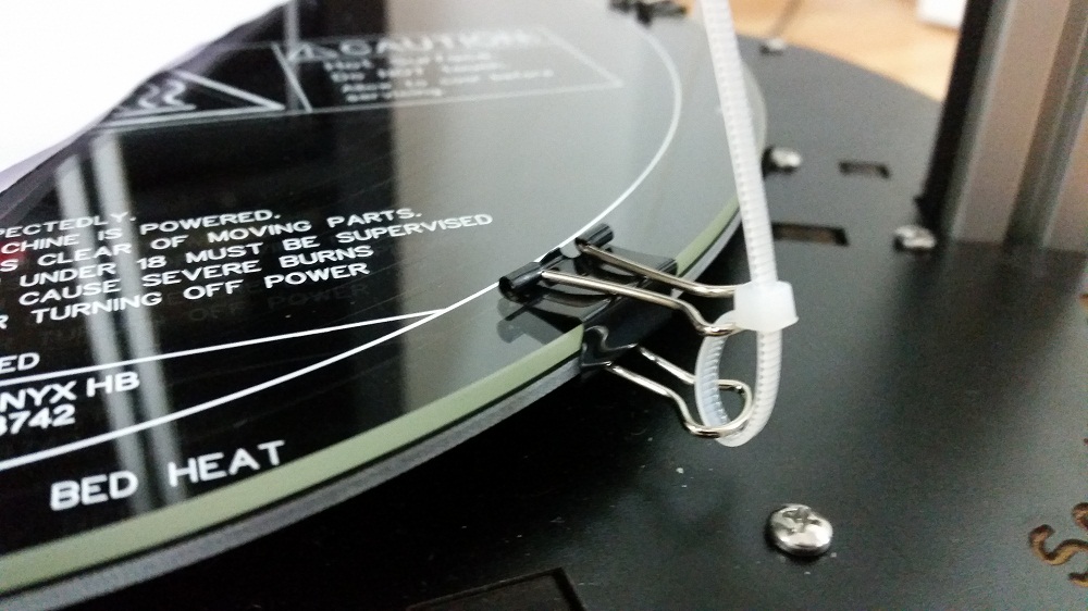

Well, I made my second mod to my printer to cut down on the noise. I added some zip ties to keep the binder clips from vibrating. What I'll probably do is wrap some silicon tape around the handles the next time I take the glass plate off.

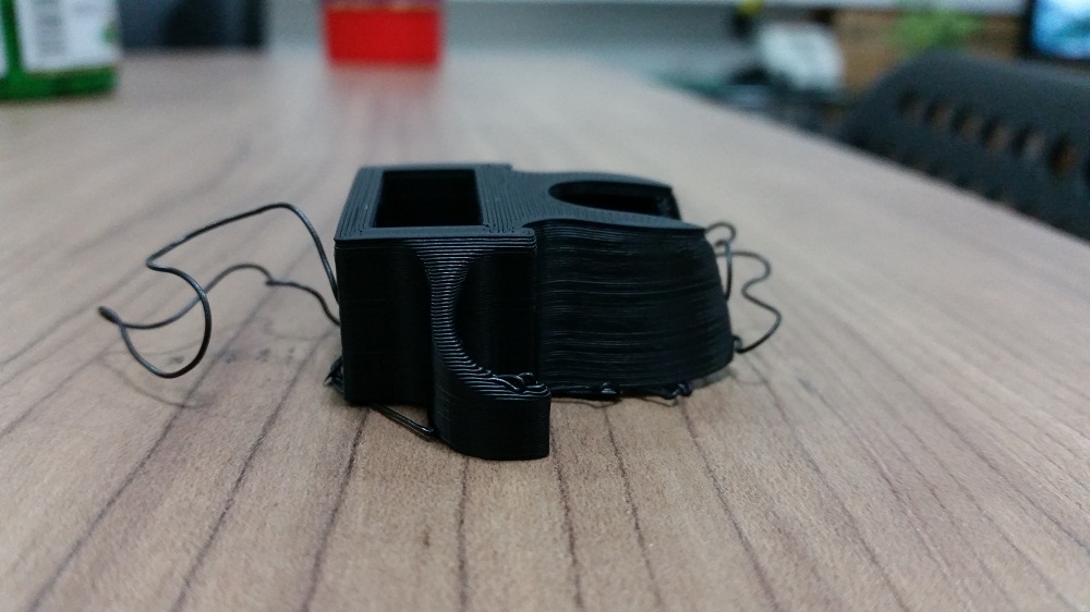

I also tried my first print. It didn't turn out like I'd hoped. I can't tell if the shroud was pulling up from the beginning, or if it is supposed to be slightly curled up near the front. Either way, I plan to calibrate my heated bed to see if I can get better adhesion on the second go round.
Here I've managed to stop the binder clips from vibrating by adding a tiny bit of tension.

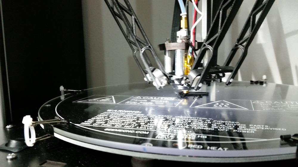

Here is the beginning of the first print. It looks good at first.

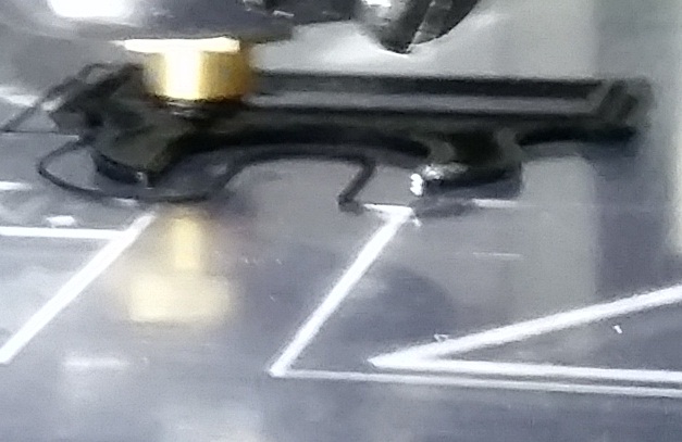

Here is the first print zoomed in. It looks like the front right edge is slightly off the bed. Should this be flat?

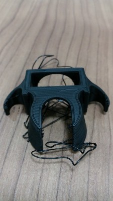

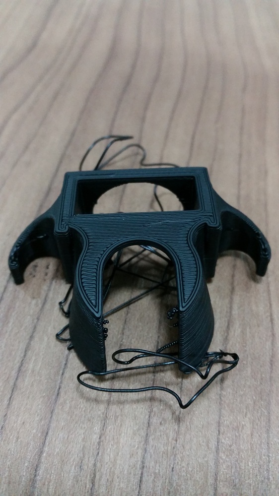

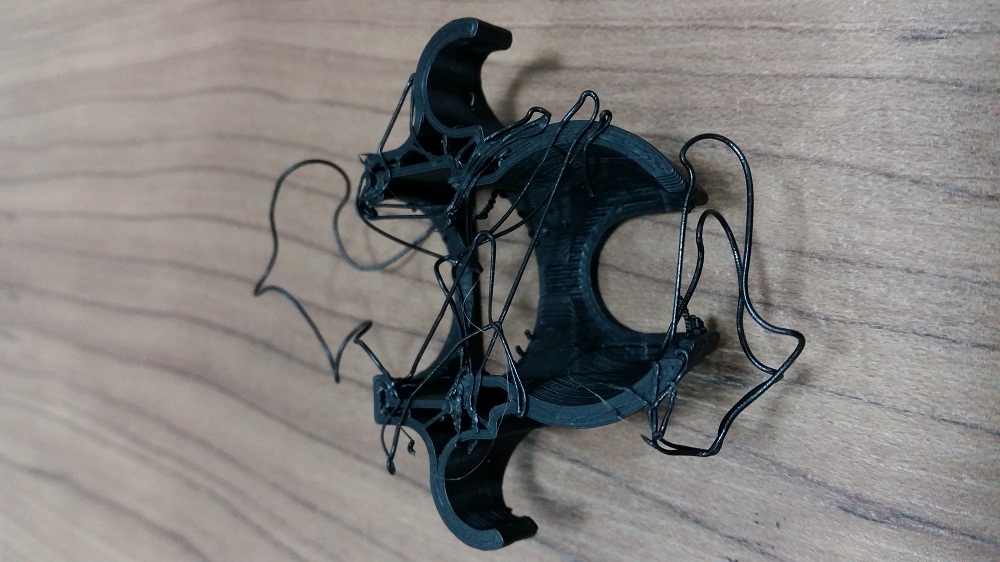

About 75% of the way through the first print I saw the print had rotated 90 degrees and I started getting spaghetti.
Here is a picture of the fail from a different angle.
I only see a slight problem with the first layer, but I don't have trained eyes. Feel free to give advice.

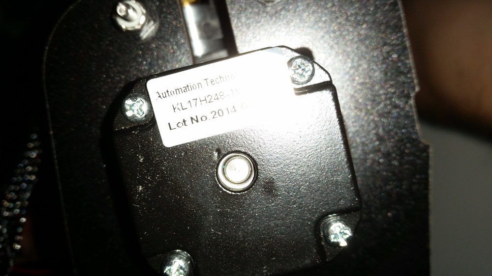

One last picture. This extruder motor got really hot. They would have been impossible to hold for more than a few seconds. I have already made the firmware changes suggested in the manual. Is there something else I can do to keep this extruder cooler?

DGBK wrote:Is there something else I can do to keep this extruder cooler?
I grabbed 40mm heatsinks from RobotDigg, 40mm PC fans, and 60mm screws from McMaster Carr. They cool down stepper motors dramatically. (At least to my less-burned fingers!)
I need to take before-and-after heat readings on the extruder motor with the cheap IR thermometer and measure the difference.
Do you unscrew the back screws from the motors to attach those? I bought some cheap heat sinks at a local shop, but I was planning on using glue or epoxy to attach them. A clean surface screwed on seems like it would work better than glue that isn't specifically designed to be thermally conductive.
