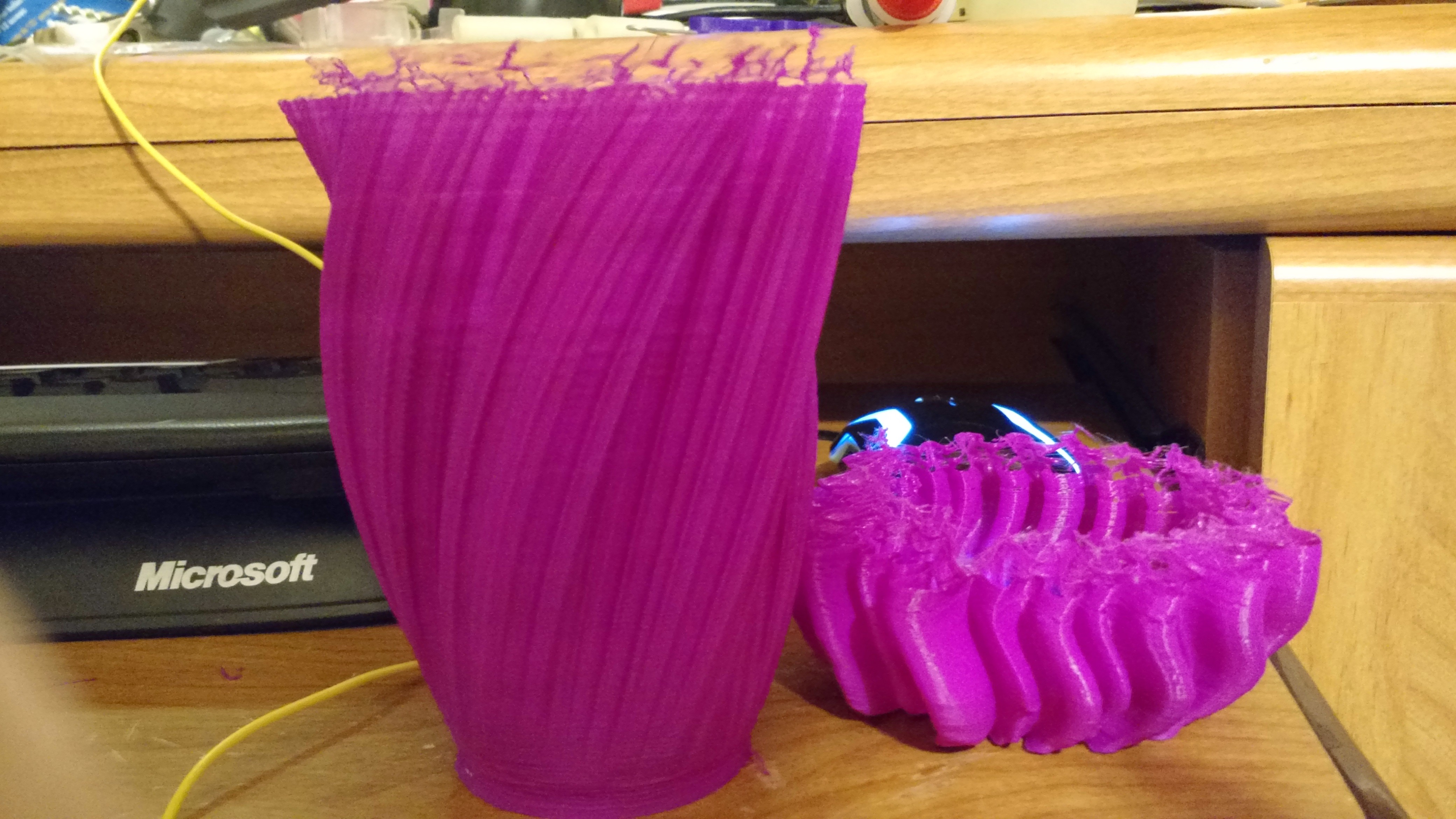

so printing again last night, I was able to finish the vase by uping the temp to 225 and lowering the speed to about 30. However the filament was still slipping on the drive gear causing some bands in the print. (the filament was definately slipping, I felt it by hand as it printed). So printing way slower and higher temp I was still having some issue. Theres gotta be something else wrong. any other ideas?

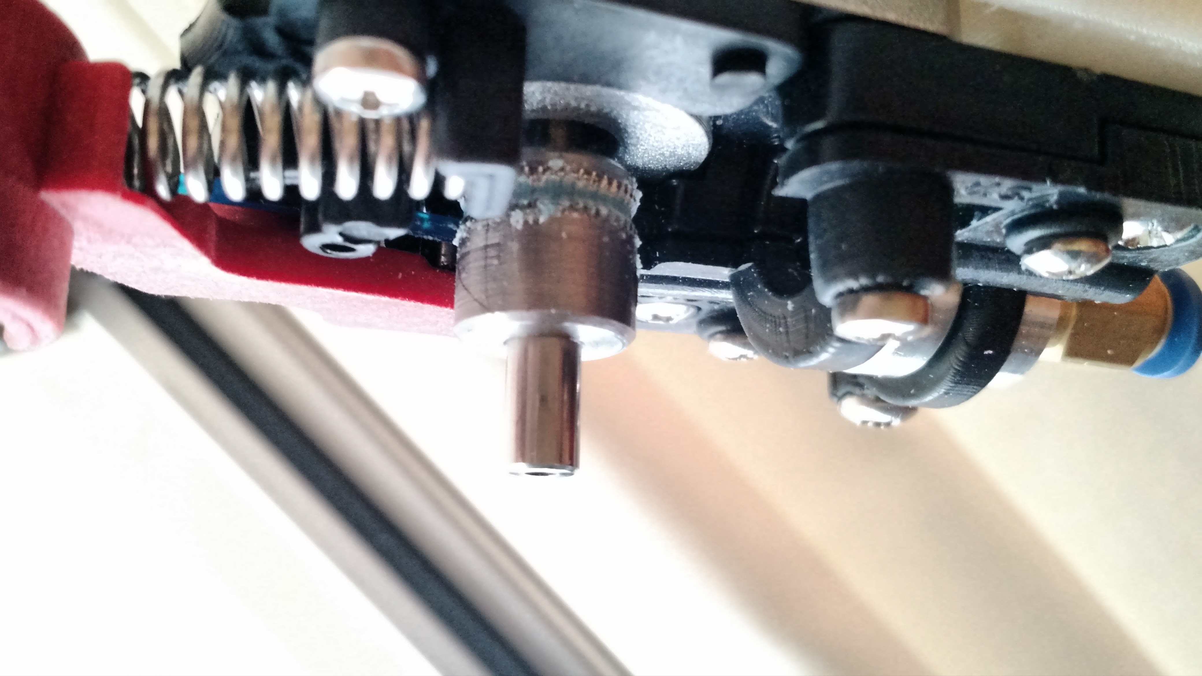

So after trying to recut the ptfe I am still having the same issues. on longer prints the drive gear starts getting all gummed up with filament bits. any other ideas?
dylantep
Posts: 83
Joined: Fri Jan 02, 2015 8:09 pm
Re: backpressure with e3d lite and ezstruder
Post by dylantep »
After some more experimenting I'm beginning to think the issue is with the ezstruder. This problem has occurred with e3d lite, e3d lite with volcano, and now e3d v6 with volcano hot end and with 0.4mm and 0.8mm nozzles.
I have reduced acceleration to 3250 for extrusion. my motor current (wantai motors) is set to 200 and I have tested with extrusion temperatures ranging from 185C-240C with PLA. Every time I print the filament slips and the ezstruder gear starts grinding it until it fills up.
is there anything else I could be missing? I'm really starting to get frustrated. I built this thing 6 months ago and still have not been able to successfully do a larger print.

Is your drive gear clean & free from debris?
my current retraction is at 3mm. I will try less but the grinding seems to occur during extrusion rather than retraction
This has happened with every filament I have tried, PLA, ABS, Woodfil
The extruder is not jamming so yes I can still push it through by hand
The drive gear is coverd in debris (see picture two posts above). It starts off clean but during printing the drive gear starts grinding away at the filament until the gear is too full of debris to extrude.

Tried a no retraction print. It failed even faster. I think the problem is coming from some sort of back pressure maybe? maybe in the hot end or the bowden tube?
