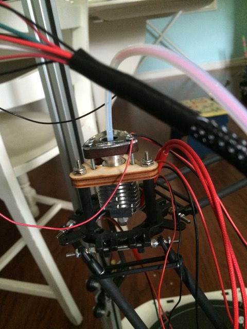

"Big things have small beginnings"
And here is the prometheus installed. This thing is slick. You don't need any ATV, there is a customizable heat zone, the PEEK fan bolts directly to it so you don't need a shroud, and it just looks awesome!
Also, I have here the carbon fiber standoffs. I'm thinking about nixing them though and dropping my hotend as low as it goes like all the cool kids are doing.

'Beware; for I am fearless, and therefore powerful.'
And behold, the thing is done. It took me a long time to do this, but just deciding how I was going to do it took the longest. I also piggy backed the LED light ring onto the peek fan wiring.
