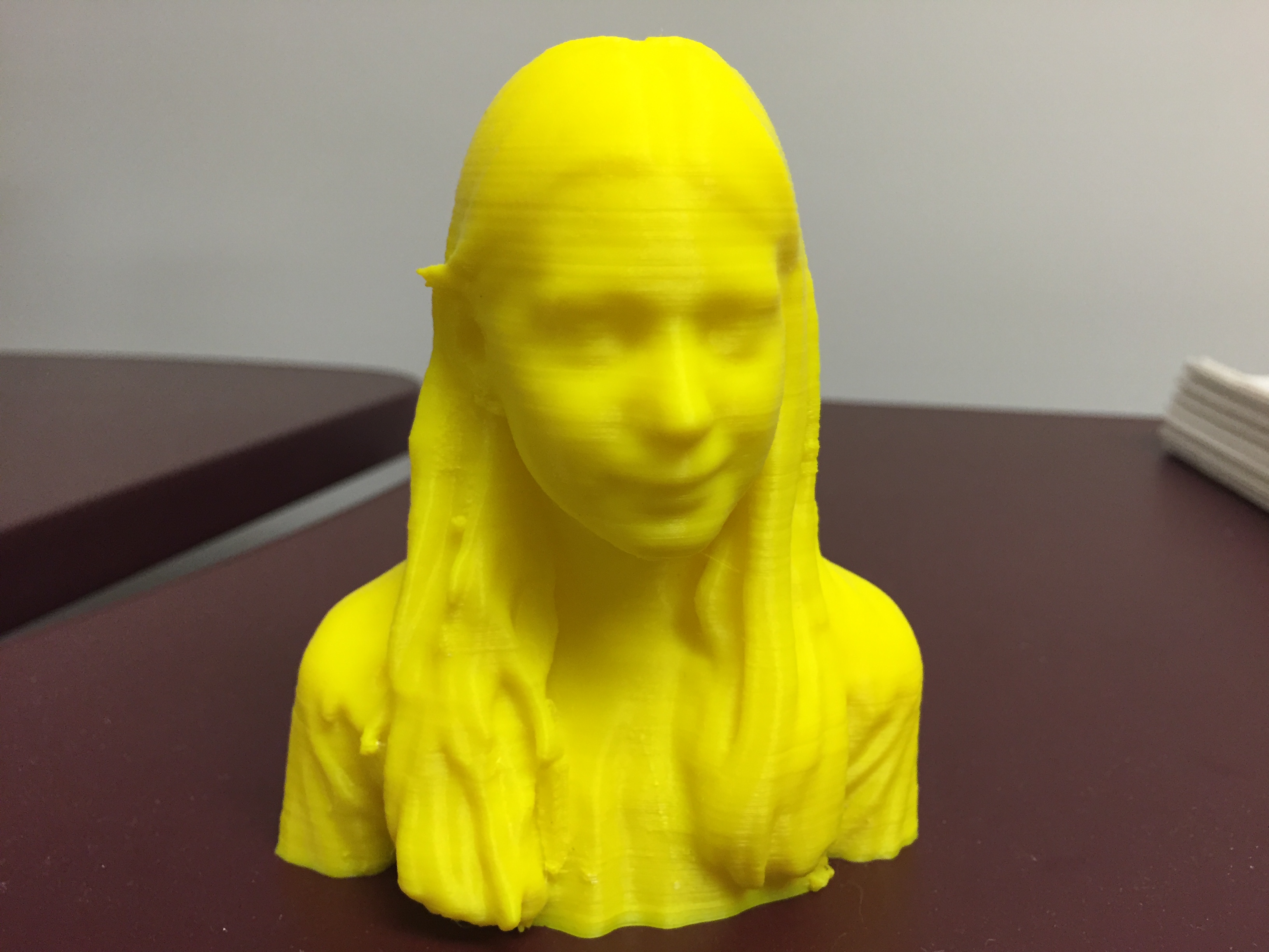

I have the structure sensor. It works fine as long as your expectations are reasonable. It helps if you have a pretty high power laptop to pair with it for better quality.
This is a scan of my daughter at about the best resolution I could get. Ignore the banding, was having printer issues.

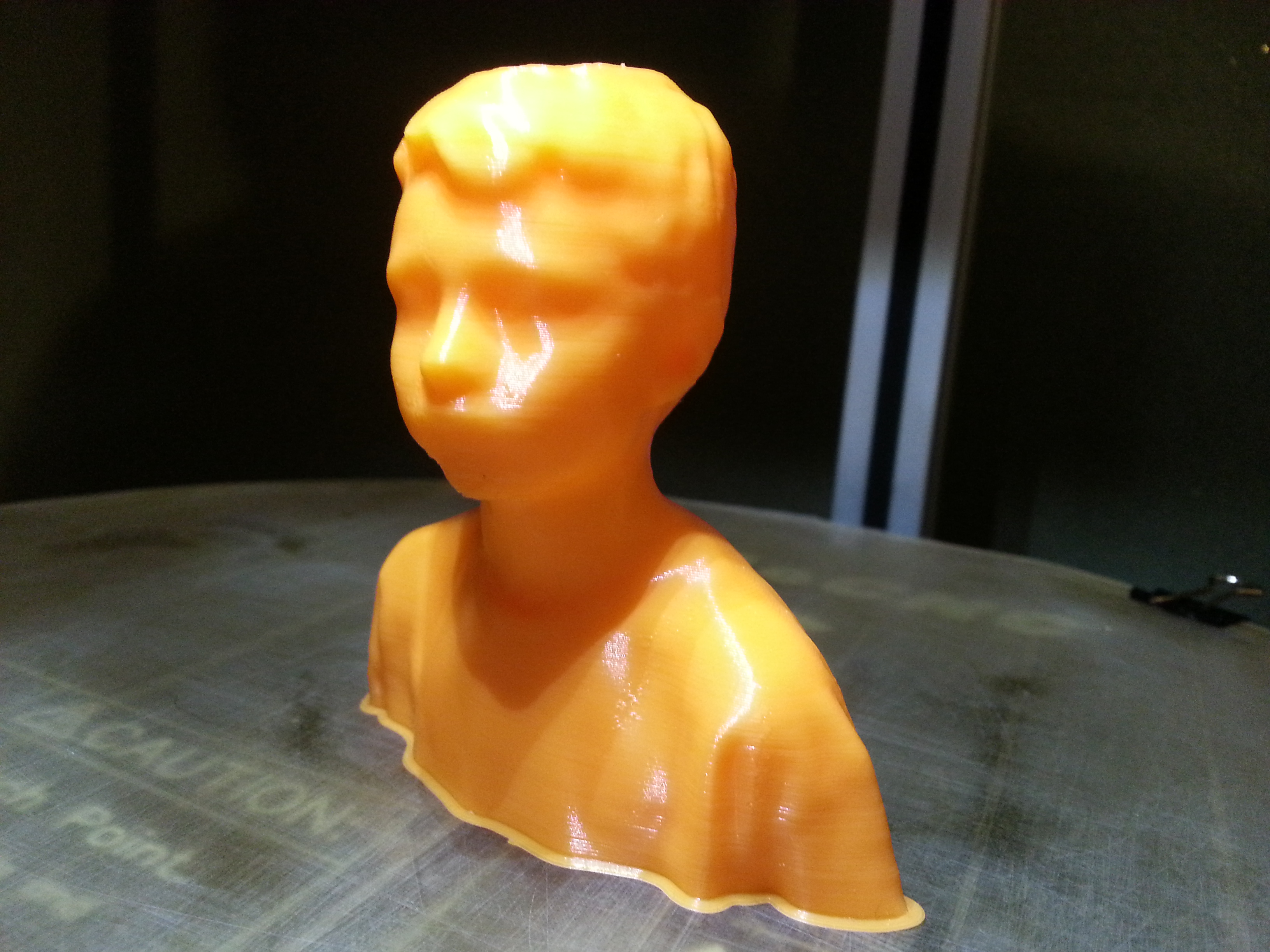

Thank you for the link. First time I've ever tried to scan anything. Seemed simple enough, just had to play around with the different settings.
Used Kinect v1 for the Xbox 360 and had my son do a 360 slow and steady. Performed better than expected to be honest.
