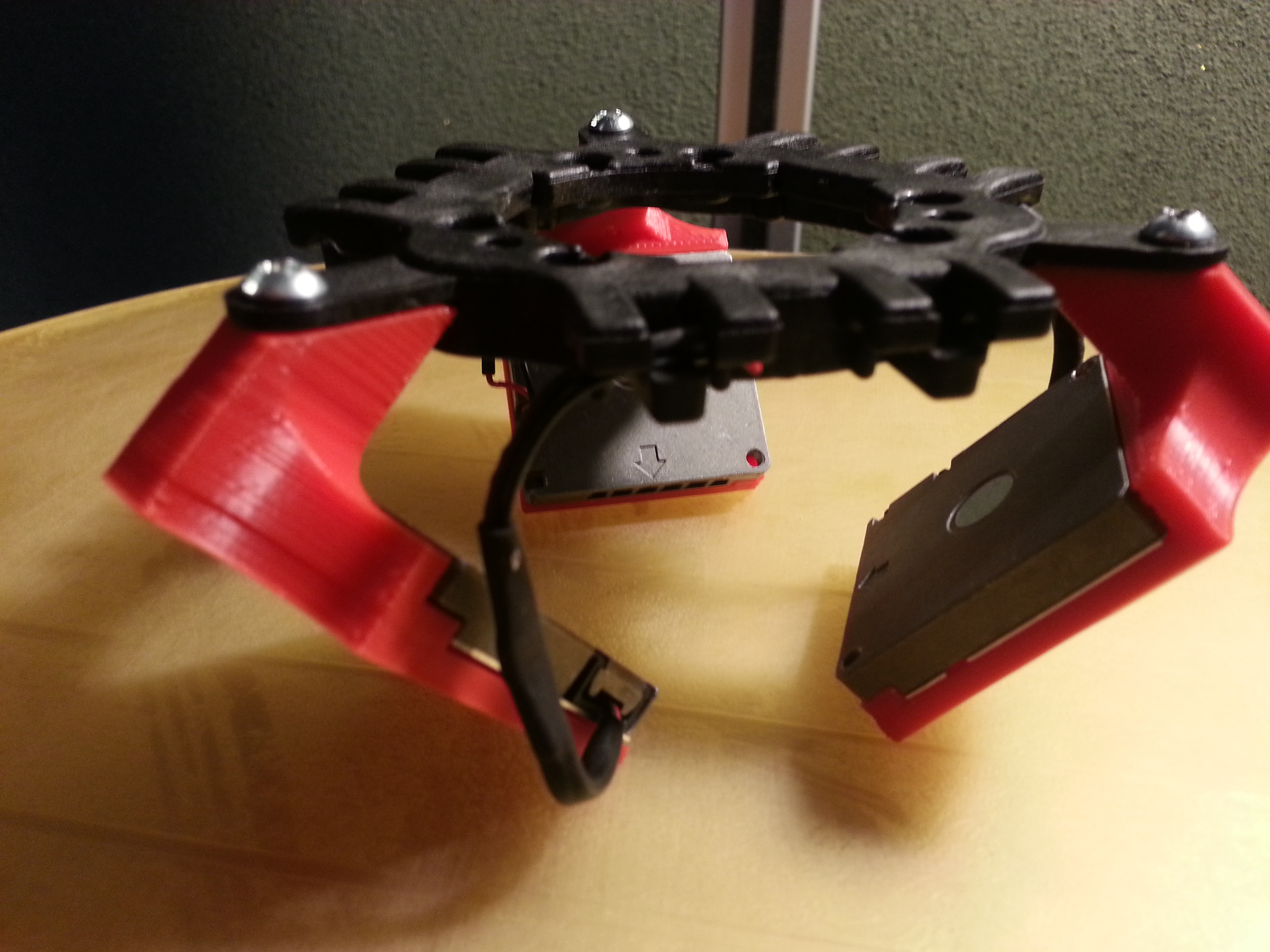

Just a quick & simple layer fan mount I'm trying. Looking for a solution that wouldn't interfere JFettig's enclosure. Inspiration came from the ATOM 2.0.
[img]http://i482.photobucket.com/albums/rr18 ... 133105.jpg[/img]
[img]http://i482.photobucket.com/albums/rr18 ... 133233.jpg[/img]
Panasonic Fan: http://www.mpja.com/5VDC-Mini-CPU-Fan/p ... 2166%20FN/
Fan Mount STL: http://repables.com/r/598#

Nice find on the fan but I have a question on the mounting.
It looks like you are using zip ties to hold the fans, is this correct?
KAS
Posts: 1157
Re: New Layer Fan design.
Post by KAS »
Eaglezsoar wrote:Nice find on the fan but I have a question on the mounting.
I guess that picture is deceiving. I used the zip ties to hold the wire from the fan out of the way. Each mount is held in place with a 1/2" screw through the top of the effector.

I didn't have much printing time on the setup above as I switched my effector to the metal one at trick laser. I have to redesign the mount to match the different tabs on that effector.
50% on the fan speed gives the +6v to the fan although I've been running one at +12v for a few weeks without issue. Three fans at +12v is a crazy amount of air, if you have the angle off a tad you can over-cool the hotend and never reach printing temps.
