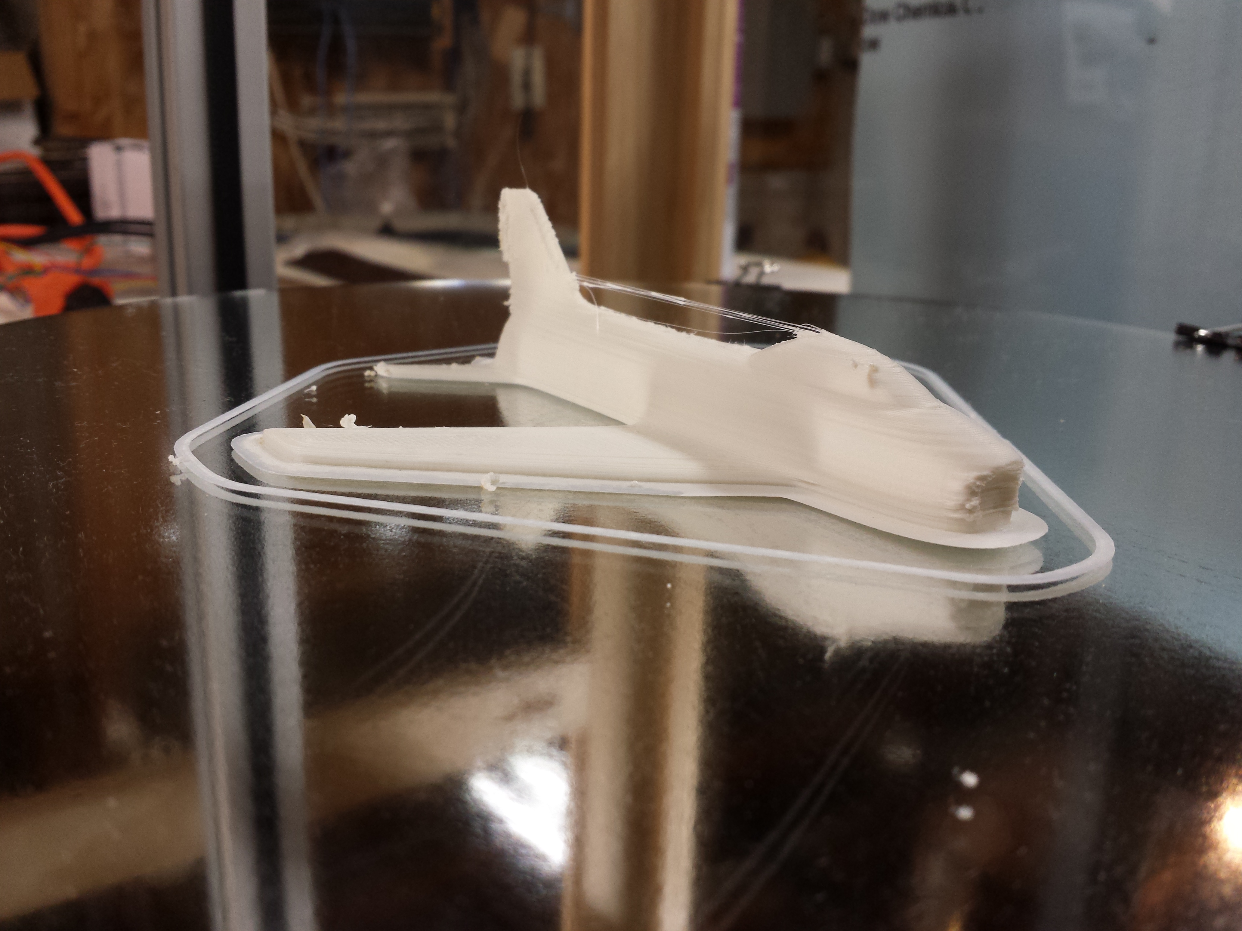

Man, I wish I knew what I was doing wrong. I got a couple of great prints, and a bunch of tolerable ones, off my first spool (black PLA from MatterHackers), but with the second spool (white ABS Pro from MatterHackers), I'm struggling.
The first big problem was bed adhesion. I tried glue stick. I tried hairspray. I tried Kapton. I added a copper heat spreader. I replaced the chipped borosilicate plate with a new mirror. I repeated the additives on the mirror. I raised the bed temperature (up to 100°C), but the prints seemed to stay soft/squishy for too long, so I lowered it. Lowering it enough to reduce squishyness (70°) lost adhesion, but 75° went back to squishy.
The hot-end temp's also been problematic. I seem to get decent consistency at around 180°, but the extruder skips. At 185°, the skipping stopped, but I'm back to drooling nozzle and squishy prints with distorted, gloppy seams.
The plane from the attached picture printed about as well as anything I've printed with the ABS, but it's clearly got issues: front-end curled off plate, gloppy distortion on the nose and tail, I had to set the print rate down to 25% for the last inch or so due to the squishy layer problem, and the raft peeled off the on the left side (relative to picture) during the first layer, almost screwing up the print.
What am I doing wrong???

You said you switched from PLA to ABS? 180C extruder temp seems way too low, I thought the standard print profile for ABS called for 235-238C?

Have you tried purple glue stick in combination with hair spray? An enclosure is also a huge help when printing with abs. Since getting an enclosure and printing and  the skirt 0.01 from the part, I haven't had a single problem. I usually do a 4 or 5 loop skirt
						Re: Printing in the trough of disillusionment
@gchristopher: my very first two prints (PEEK and layer fan shrouds) were essentially successful, and both were printed in ABS. I don't remember what temps I had set back then (January timeframe), but I suspect they were the defaults from the print profiles I loaded in the assembly manual. 180C seems WAY too low to me, but as I said, even at 180C, the filament drools out of the nozzle. At 225C, it's a goopy mess!
@jram: I've tried purple stick and hair spray, but not both yet. I've got 5 loops on the skirt 10mm from the object, and have a 5mm brim in my current Slic3r settings, which helped keep my test cube stuck down but was insufficient for a larger print. I did build an enclosure (clear acrylic in wooden frame), but actually have overheating problems, both with regards to having the electronics inside the enclosure and also with regards to PLA glass point, so there are now several vent holes in the top.

Have you calibrated your hot end against a thermocouple?
180º seems pretty low for it to be oozing, I don't see it until about 220º or more usually.
Also: have you got a fan running over your RAMBo electronics? Mine used to skip all the time, it was the stepper driver overheating and shutting down. Added a spare fan blowing edge-on to the PCB and that all just stopped.
Biggest killer I've found for bed adhesion has always been too much height off the bed at z=0.
I don't have a thermocouple, but I checked the temp using a digital meat thermometer that tested within 1°F for water boiling temp at my altitude and with a Harbor Freight infrared thermometer, and both showed similar temps in the 170°C range when the RAMBo was holding at 180°C, so it looks as if the thermistor's not WILDLY off.Captain Starfish wrote:Have you calibrated your hot end against a thermocouple?
I went through last night and re-zero'd Z height as well as recalibrated the towers. They're all now within roughly a half of a thickness of a sheet of printer paper of each other. I haven't printed anything, though, as I'm also going through and redoing the belt tension with my new tensioning devices (derived from this threadhttp://forum.seemecnc.com/viewtopic.php?f=35&t=1169). Once I'm done with tensioning, I'll re-check Z height and give it another go.Captain Starfish wrote:Biggest killer I've found for bed adhesion has always been too much height off the bed at z=0.

After spending a huge amount of time futzing around with calibrations, etc., I finally got everything set up as well as I think I can manage. Based on my dial indicator, the geometry's now flat to within 0.02mm across the build surface. The belt tensioners are working great. I re-zeroed the Z axis. I tried printing the test cube again, and the first layer STILL wouldn't stick!
Frustrated, I pulled the ABS spool off the printer and put the nearly-empty PLA spool on. Lo and behold, it printed almost perfectly!
Is it possible that the adhesion problems, the gloopy prints, etc. were all the result of a bad spool of ABS? It seems as if that could explain why the ABS was drooling from the nozzle at only 180°C.

A bad roll is indeed possible. This forum contains many stories from users who got a bad roll.hubrigant wrote:After spending a huge amount of time futzing around with calibrations, etc., I finally got everything set up as well as I think I can manage. Based on my dial indicator, the geometry's now flat to within 0.02mm across the build surface. The belt tensioners are working great. I re-zeroed the Z axis. I tried printing the test cube again, and the first layer STILL wouldn't stick!

So, I finally bit the bullet and got a new roll of filament (Hatchbox PLA), and it sticks just fine to the bed.
