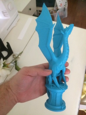

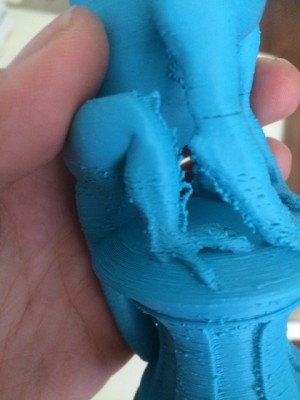

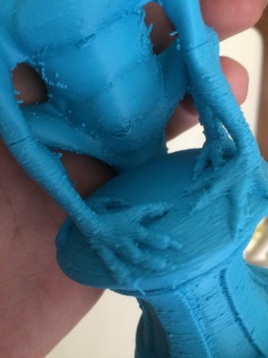

I've been printing PLA since day one. It's been good. Thought I'd try ABS. I printed something small, and it warped off the bed. Just curled right up and delaminated into pieces.
I decided maybe the roll maybe was to blame, so i started a large dragon print thinking it would fail epically. It did finish, but it's not nearly as nice as the PLA stuff I usually print. What's the trick to this stuff? Can you determine anything I am doing incorrectly by the photos? Thanks!
It's nice and big but it's messy

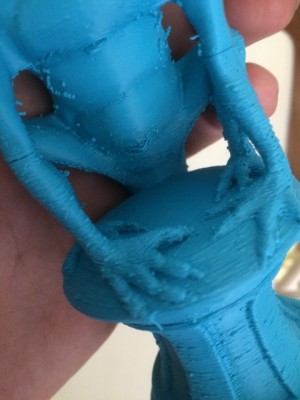

lots of little fragments and bits
looks like it skipped a layer on the arms

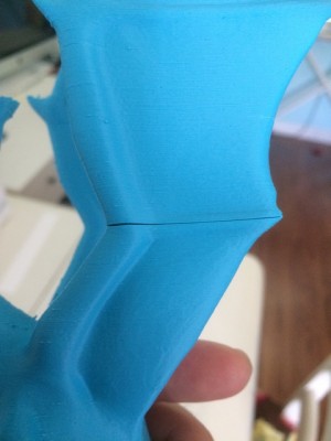

delaminated on the wing
Temperature 230, bed temp 80.
layer height .2, infill 30%

Temperature 280?! That is wayyyyy too hot for most designs. Try 260 at most, or 245 is probably more reasonable generally.
I think a lot of people that have success printing with ABS (myself included) have sealed enclosures for their printers. That really helps on the warping / delamination front.

Did you calibrate your extruder? So that when you extrude 100mm its 100mm. Check doodatdoes youtube channel for a simple tutorial.
Small perimeters and low infill helps a lot with big prints. The new 3D honeycomb infill from Slic3r works great at 10% or 5%.
Yes, an enclosure it's a must too.
Whats your speed and retraction settings?

It depends on the filament but I'd up the temp to 240ish and increase your retract. If memory serves, I think you can't retract PLA very var before it starts jamming; ABS doesn't have that issue so much. Maybe try retract in the 5-6mm range, that's what works for me.

I'd slow that retract back to around 45mm/sec and change the retract length to 5. My z-lift is set to .2.

Because it'll cause your parts to warp/split. ABS *HATES* being cooled during a print. That's why The Big Boys use heated build chambers for ABS. There _are_ certain circumstances were you would use a fan, but it's pretty rare.

Thanks for all of the tips, the changes suggested definitely have improved things. Printing at a higher temperature has definitely made a big difference I think. I still have issues with tall models splitting, but I think the main fix for that is enclosing the printer.

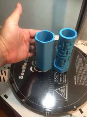

the classic labyrinth gift box, I love this thing

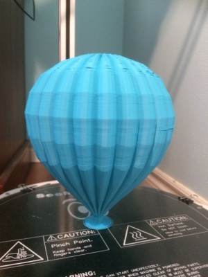

a hot air balloon to be used as a decoration at a baby shower. It split but definitely turned out useful still. This one was my own design.

if you have any splitting clear thin abs glue (tap plastics has it) will seal them up nicely. just need a bit of pressure on the joint after gluing. then an acetone brush will make your part shiny...

Best things I have done to improve splitting are print hotter (depending on brand/color I print ABS up to 255C, pretty much never below 235C), go slower (max speed for bigger objects is 30mm/s), and block airflow to the print area some how (just making a triangle out of 3 USPS medium flat rate boxes work for a long time for me).
