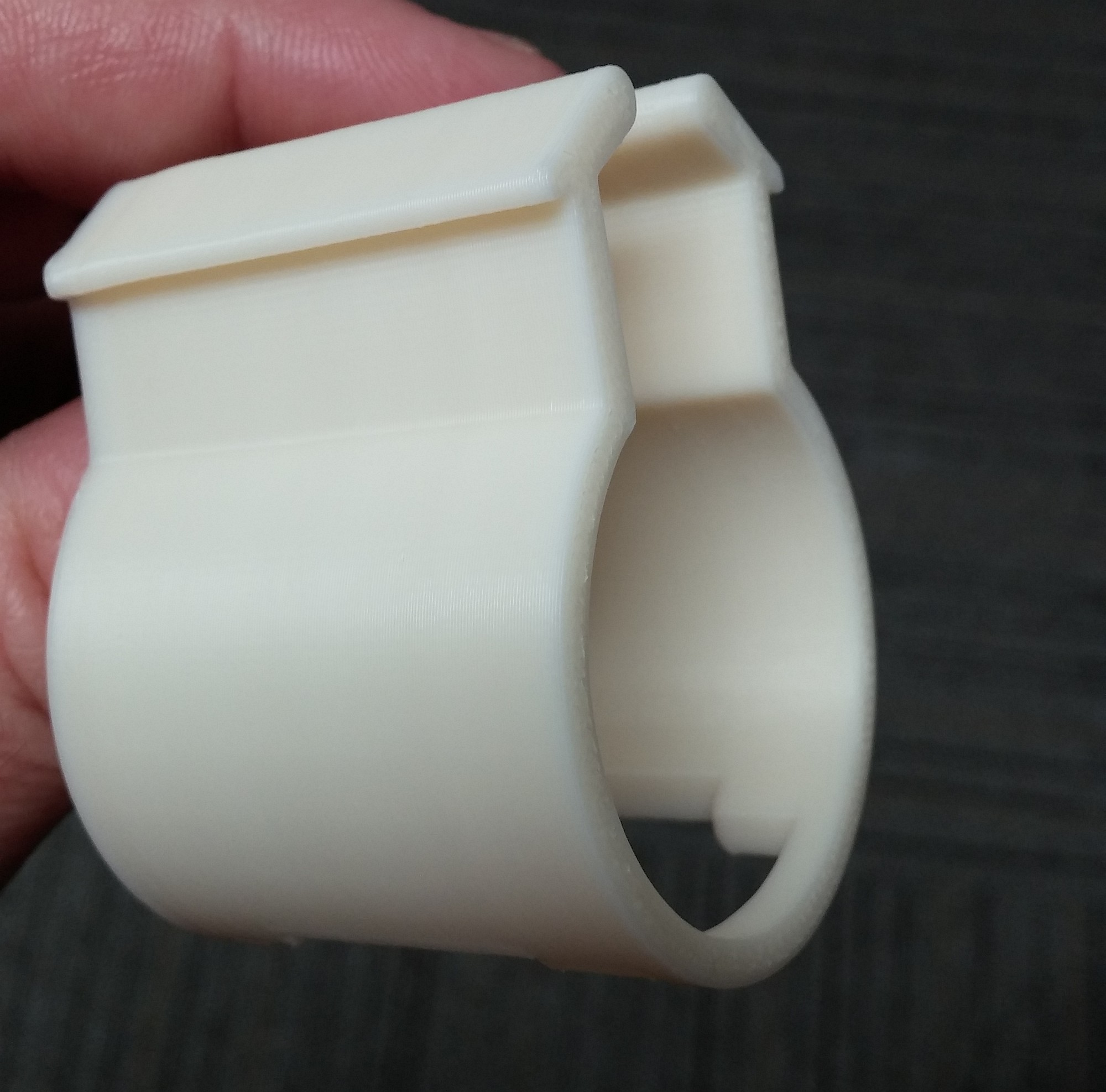

You got a hell of a deal on the one of the best printers on the market. I own a Creator Pro and a Creator Dual (Woody). As for my Creator Pro, I haven't leveled the bed since last March and every one of my prints has been outstanding. Combine that with S3D and you'll start to get cocky.
Here's my latest print today (ABS). Did my best to focus on a white part.

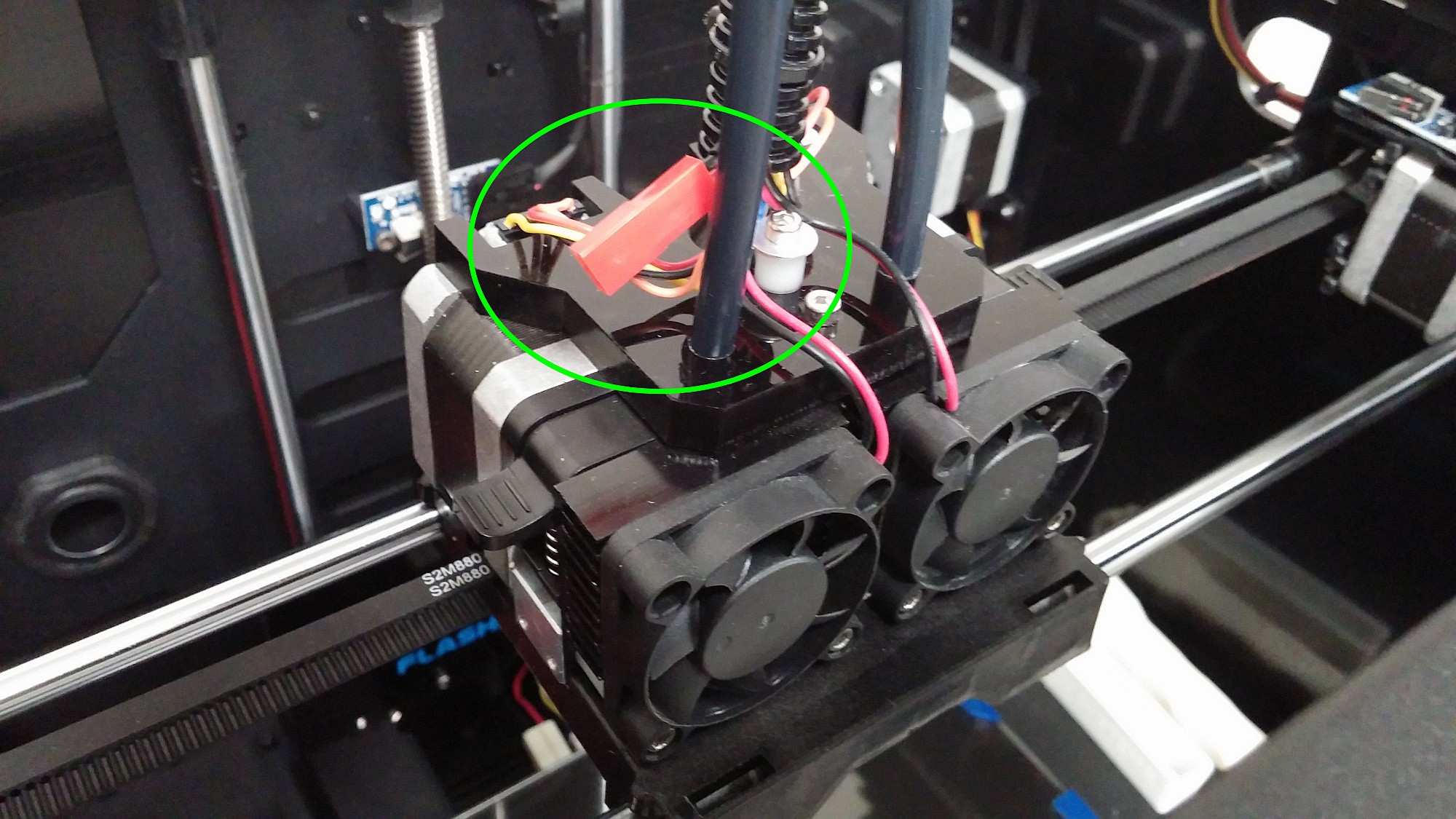

Just took the bottom off this machine last night to start wiring my layer fan so that I can print PLA "the right way" and thought I would share a picture.
I'm pretty impressed with the quality of this machine overall. Name brand power supply (Meanwell NES-350-24), heatsinked A4988 stepper drivers with a fan pointed directly at them, and the controller board that has some expansion options ready to go like the layer fan I am adding.

I wired up a layer fan to mine too (turbo fan option). I think I used the fan once and took it off. Anyway, I soldered in a JST connector so I can easily install or remove it.
Re: Flashforge Creator Pro - very unplanned purchase
Good idea. That is how I have my Rostock Max wired, but I didn't even think of doing the same on the FFCP for some reason.
