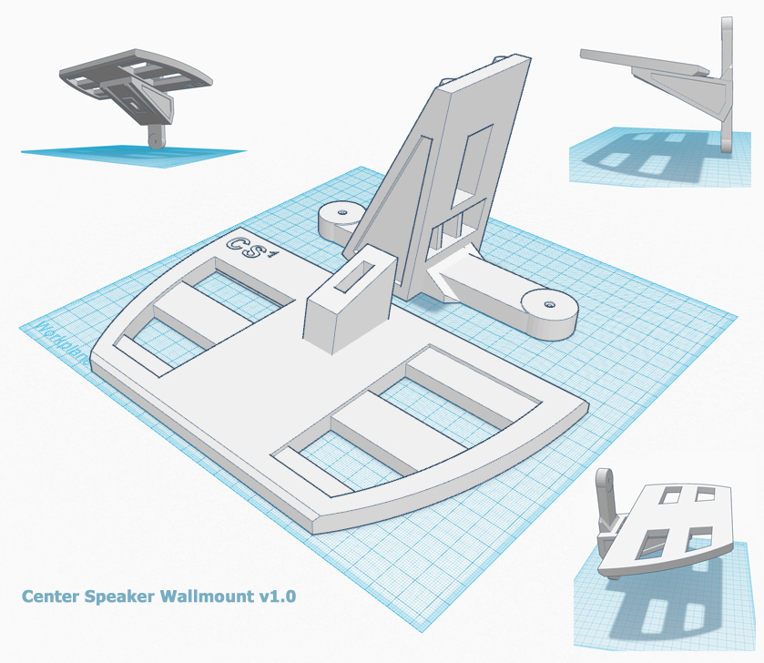

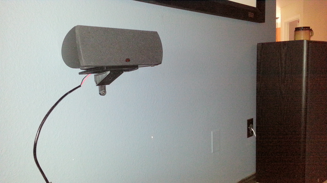

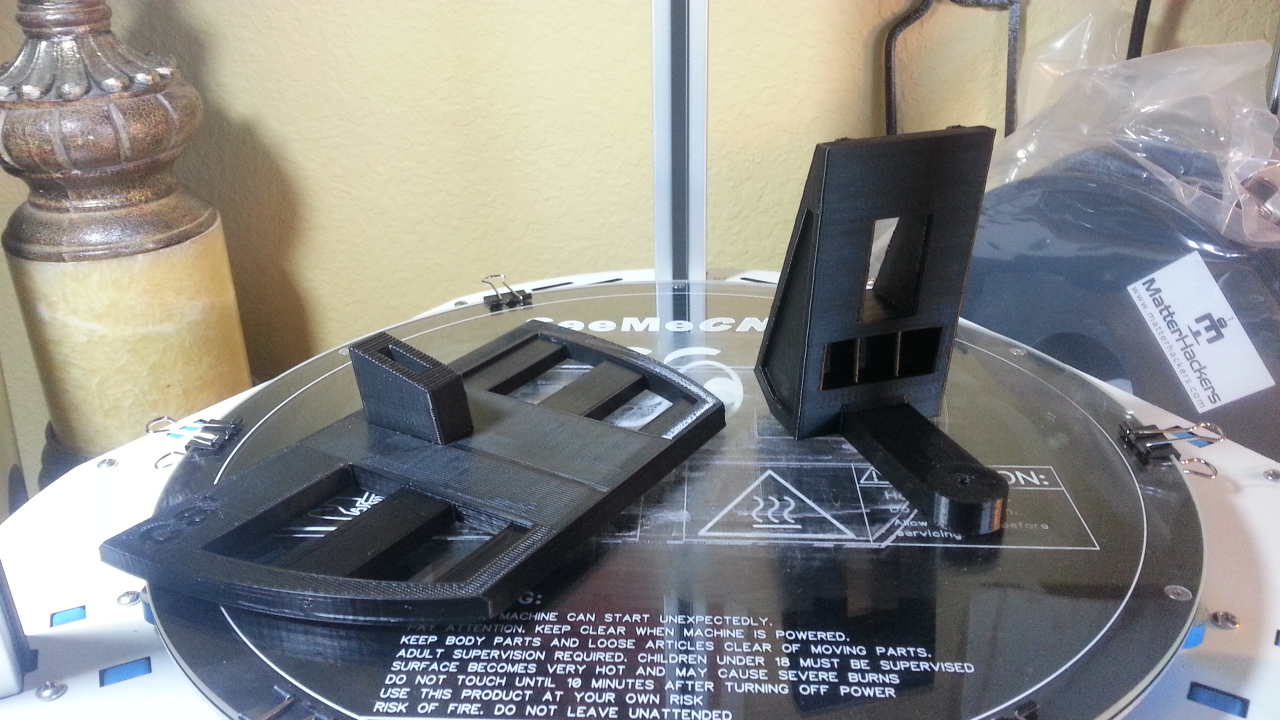

OK, so before my RSM-V2 came in, I needed a wall mount for a very heavy round-backed center speaker in our media room. The previous home owner simply placed it on the floor and I couldn't really find the right mount for it. I decided to design one in TinkerCad and then prompted waited months until I could afford to buy the RSM-V2 so I could print it. I was very happy with the print job RSM-V2 did on my first few prints so I got brave and printed the big pieces. I had heard lots of woes about ABS peeling & warping on large objects but I somehow avoided any problems. I did use a Coarse setting of 0.35mm per layer so maybe that is why? Even small wide prints don't seem to exhibit that though. I could just be lucky. Anyway, I didn't care about it being pretty, just functional and sturdy enough to hold up this 8 pound monstrosity. Below are the pics of the design and final mounting I did today. Enjoy!
Re: Front Speaker Wall Mount
now knock some holes in those walls and hide the wires!!
right? The guy spent all that money on building a movie room and then put the wires coming out through a hole near the floor. It's in the wall, just completely off-center. I don't want to put a new hole in the wall but may have to do exactly that and fish it up. I hope there isn't a stud. Meh. At least the sound will be correct finally. Baby steps.

Also, I have since discovered that I really just got lucky with that speaker mount print being as big as it was with ABS. I made a new print that was peeling to high heaven no matter what I did...and then I remembered to add "Mouse Ears" to the sharp corners. Viola'! Perfect corners again. When in doubt, mouse it out I guess. I'll be posting it here soon. I think I will start adding some of my stuff to Thingiverse. Kinda of nervous showing my lameness in modeling to the world, but you have to start somewhere. Those digital calipers I bought at the manuals recommendations are getting a lot of use!
