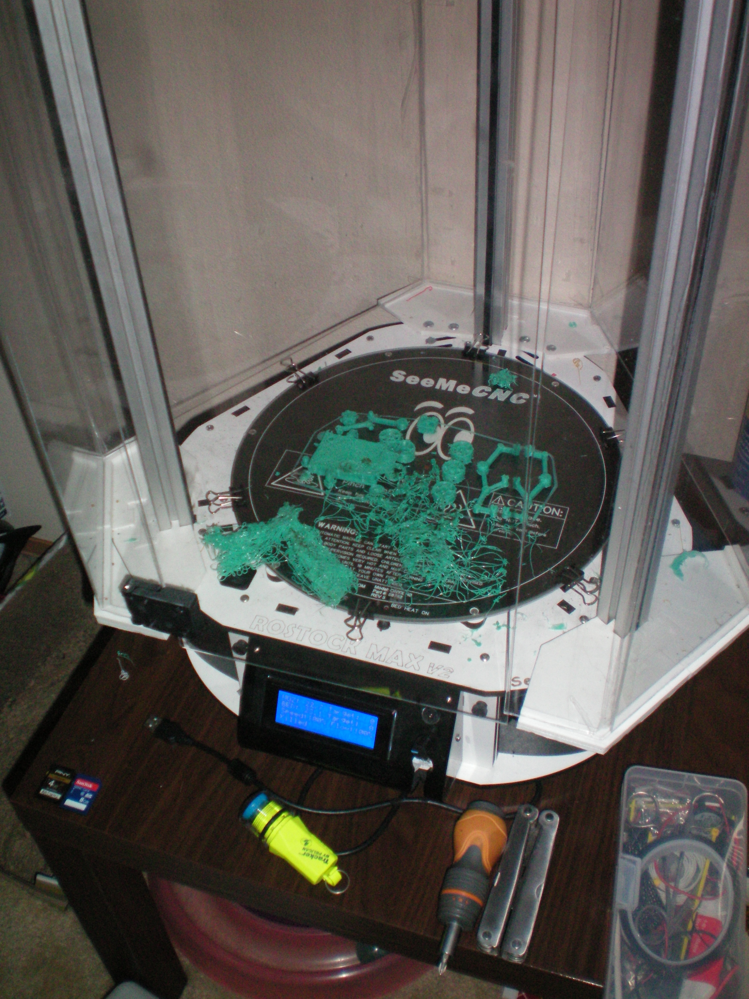

ok so i have been having a problem with my printer. so i will lay it out for you i spent 1 hour leveling the bed last night tried to get everything set perfect and did a simple test print, benchy the 3d printer test set. it ran perfect print cam out beautiful everything was great, then today i ran another program, same slicer setup, nothing different and the printer was left on until i started the curiosity rover this afternoon. then the print head runs right into the bed and runs against the print bed. i have changed nothing between one print and the next so i have no idea why every time i want to print anything i have to relevel the bed. and before you say tighten the belts and the gears on the steppers i checked all that this weekend, along with examing the belts for any problems or wear. so any other ideas would be great

Does the Z height in your host program (MatterControl, Repetier Host, etc) match the Z height that you store in EEPROM when you level the bed?

yes they both match to the very last digit I tried to do a benchy test this weekend and he came out sloped. is it possible to over tighent the belts on the rostock? also do the belts just wear from normal use, should I just replace all 3??

Belt tension wouldn't cause a dimensional disparity like that. It's possible that one of your pulleys is loose. Also check your u-joints and oil them, move them around and make sure that there aren't tight spots in their movement.

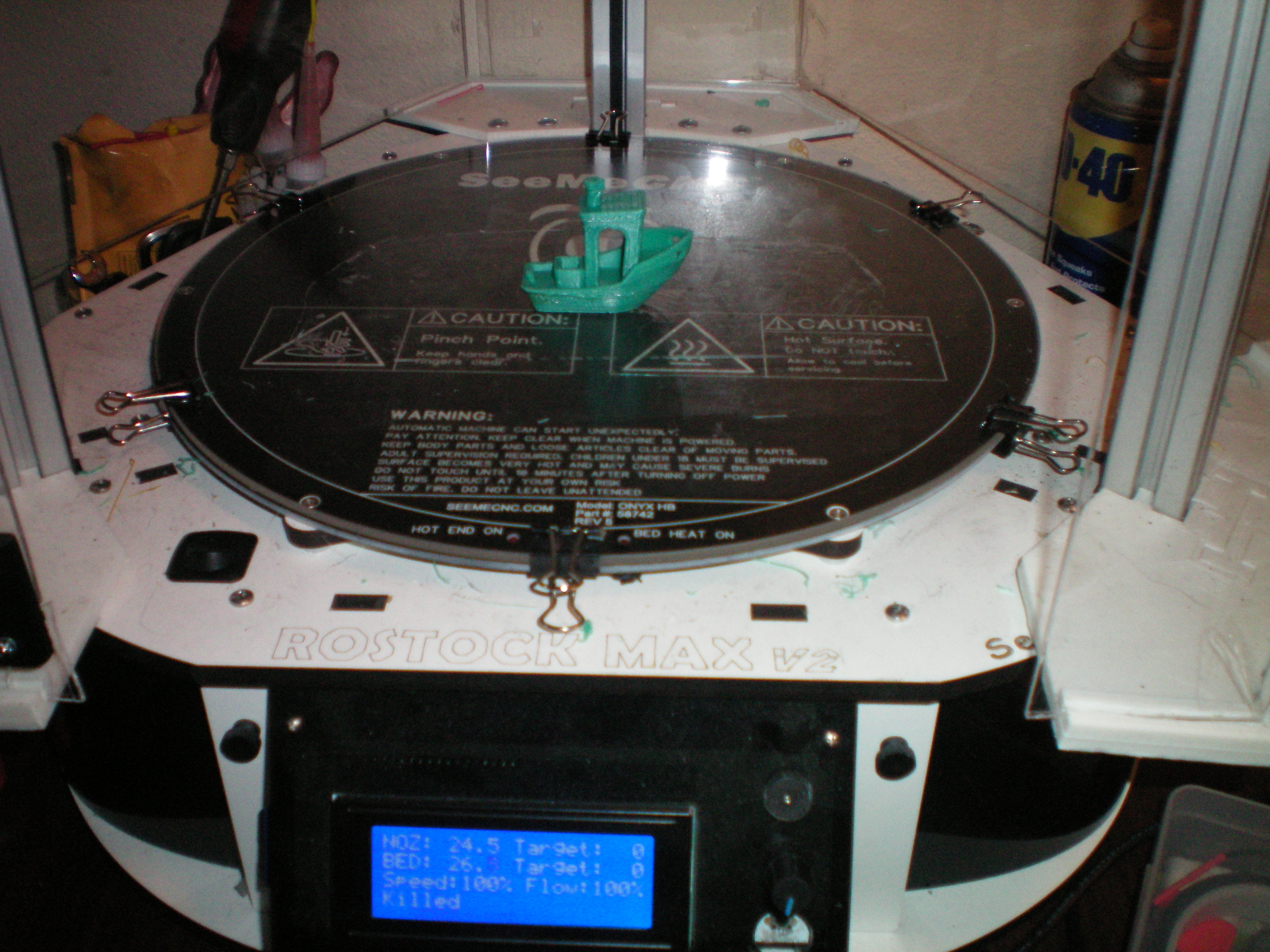

ok so i cleaned and checked all of the arms smoothed everything out and releveled the bed so i was able to run benchy so here is the result. as you can see if the pictures attached right the boat is tipped in the direction of the z tower. i double checked to make sure the towers were free and there was no binding so once again i am stuck on this one. i posted the g code just in case anybody wants to try see if i have a programming error but i have made several of these in different colors as a test so any other ideas??

ok so i tried to print benchy the printer bench test a couple of times with no luck again and again after a few hours it turns off. completely shuts down with no voltage anywhere, i cruised the forums and found this problem has already happened to others so i am assuming now i need a new power supply. could somebody verify this just for my reference before i spend some more hundreds and still cannot print what i want.

Re: printer leveling
You may want to check the switch on the rostock. I found it wanting to come loose once.
Or excessive heat down below might also cause it to ahut down.

I have added a fan to the case to remove heat and the room is cold so heat is not a problem here and so far no loose connections

ok another extensive week of testing, work and failure. i am pretty sure the power supply is not up to snuff as the components wear it cuts out to protect itself as it is too close to the power supply limits when everything is running for as many hours as i have run so i give up. for sale one rostock max v2 with several spools of filament in need of a power supply 1200. no shipping unless you are willing to pay for packing and shipping the bloody thing. i live in washington state. i will get a printer that is simplier and of a more proven design because this is not working and has not been working for far too long. it has been a pain in my backside and now i can get two others for the price of this one. good luck with yours
