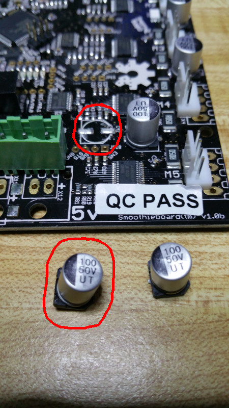

I'm posting this thread to notify the community of a serious problem I've had with Uberclock, and a more serious problem with Smoothieboards in general. In time, I hope to discover whether this problem was just a forgivable technical issue, or something else.
I ordered two Smoothieboard 5XCs and two of the beefier 5V regulators from Uberclock.com on 7/31/15. I received them in the mail, and discovered that the first one wouldn't home correctly. You can see why in the attached photo:
That "QC PASS" sticker seems ironic to me. :lol: I was scratching my head at why it wouldn't home, when I looked down at the board and saw one of its own capacitors sitting on the table next to it. It had fallen off during assembly, without even being touched. I then tested the rest of the caps, and found that another peeled off as though it was held in place with a weak adhesive. The rest of the capacitors had no give at all, indicating that they had been soldered properly. I went on the Smoothie IRC channel and wolfmanjm (pretty sure it was him) said that this was a known issue - the caps aren't always soldered properly. They know this is going on - not just in my case, but in general.
On 8/11/15, I sent this email to [email protected], which is published on their store page:
This was an order for two Smoothieboards. One is okay. The other is DOA. Wired up the board and discovered that two axes wouldn't move. Looked next to the board and saw a cap just sitting on the table next to it. It had come off because it wasn't soldered properly. I tested the rest and found another one peeled off with very little effort. The rest were in there solidly.
I'd like this to be replaced. Please send me a shipping label.
On 8/24/15, I hadn't heard back. I sent another email asking for an answer within two days, and stating that I would take action to recover my losses if it was not answered.
It's 8/26/15, after the close of business everywhere in the continental US. There has been no answer. I have filed a dispute with my credit card issuer in order to recover the cost of one of the boards.
I don't know whether Mark's email is busted/full/etc. Maybe that's the problem, and getting dinged by his bank will be what wakes him up to the issue. On the other hand, maybe it's something else. I can't know because I have no information about the man, or any contact from him concerning this issue.
The Smoothie team has acknowledged in public (the IRC channel) that this is a known issue. Because it's not a freak accident, and because they have been unable to get their QA process good enough to catch these duds before they're sent out, my recommendation is that no one buy a Smoothieboard of any kind unless and until they have this issue fixed "for real". Based on what I've seen and been told, if you buy one of these, you're rolling the dice for over a hundred and fifty bucks - and if you roll wrong, you'll have to go after them through whatever bank or credit card issuer you used to pay for the transaction.
The Azteeg X5 is one alternative. I went through two of those in less than half a year (one has CPU "stuttering", the other has a blown bed heater FET), so I can't say my own experience has been very good. However, if I don't see some immediate improvement in communication and QA process from the Smoothieboard camp, I just can't recommend that anyone allow their business (or even leisure) to rely on the Smoothieboard. If I wasn't so heavily invested in improving the firmware, this would be the event that sent me back to the dinky Arduino controllers.

Re: Smoothieboard capacitors falling off, can't contact merc
It's not a through-hole component that you could repair yourself? That sucks.
They ought to revise their capacitors anyway. After reading up on this thread: http://makerhive.proboards.com/thread/1 ... n-steppers one of our MakerHive members who's a really sharp retired EE had a hunch and looked up the TI whitepaper for that stepper driver. It appeared to him that the power supply capacitor for that driver is severely undersized and might be causing the voltage issue in the blog post.
I hope there's a real issue with their email and that this isn't just business as usual for them. I know that I've contacted them multiple times about being a beta for their LCD panels and never received a response or acknowledgement.

Board production issue. Either there's too big a groundplane under the pads or there's enough conductivity up into the lead of the caps. Either way, the joint ain't getting hot enough and the solder pad's not taking to the cap. These things happen, they should be sorting it out for you. Or by the looks you could probably hand solder the caps back on, just get them the right way around.

Yes, anyone with a good iron and some practice hand-soldering surface mount could fix the caps pretty quick. Not that customers should need those skills to get a working board.
But that's beside the point of this thread...it's more about quality control and customer service, and the future reputation of the supplier. 626 is playing hardball now. Hope it has the desired effect.

KAS wrote:Same issue with one of mine, but I was able to solder it back on. http://forum.seemecnc.com/viewtopic.php ... 249#p69342
Yesterday I fried one of the mosfets that control the layer fan. I was able to get a part number fairly quickly from Cecil on IRC.
Your cap has legs on it, so I think I could fix something like that - but in this case, the capacitor sits directly on top of the pads. It might take a reflow oven to fix this. I don't know. SMD is less than a percent of my soldering experience. I feel a bit lost.
In any case, I'd rather they replace the board, and fix their broken quality control process. "You're an engineer, fix it yourself" is not the level of service I want to see coming from my preferred hardware vendor. (Not that that's necessarily their attitude, but right now, how can I tell what their attitude is? They don't respond to email.)

Absolutely, I'd be chasing a new board.
Because you don't know what those caps are there for, just looking at them. Probably supply filtering, but it's anyone's guess. And in the process of being disconnected from a live circuit, was any damage done to the processor or drivers? You don't know.

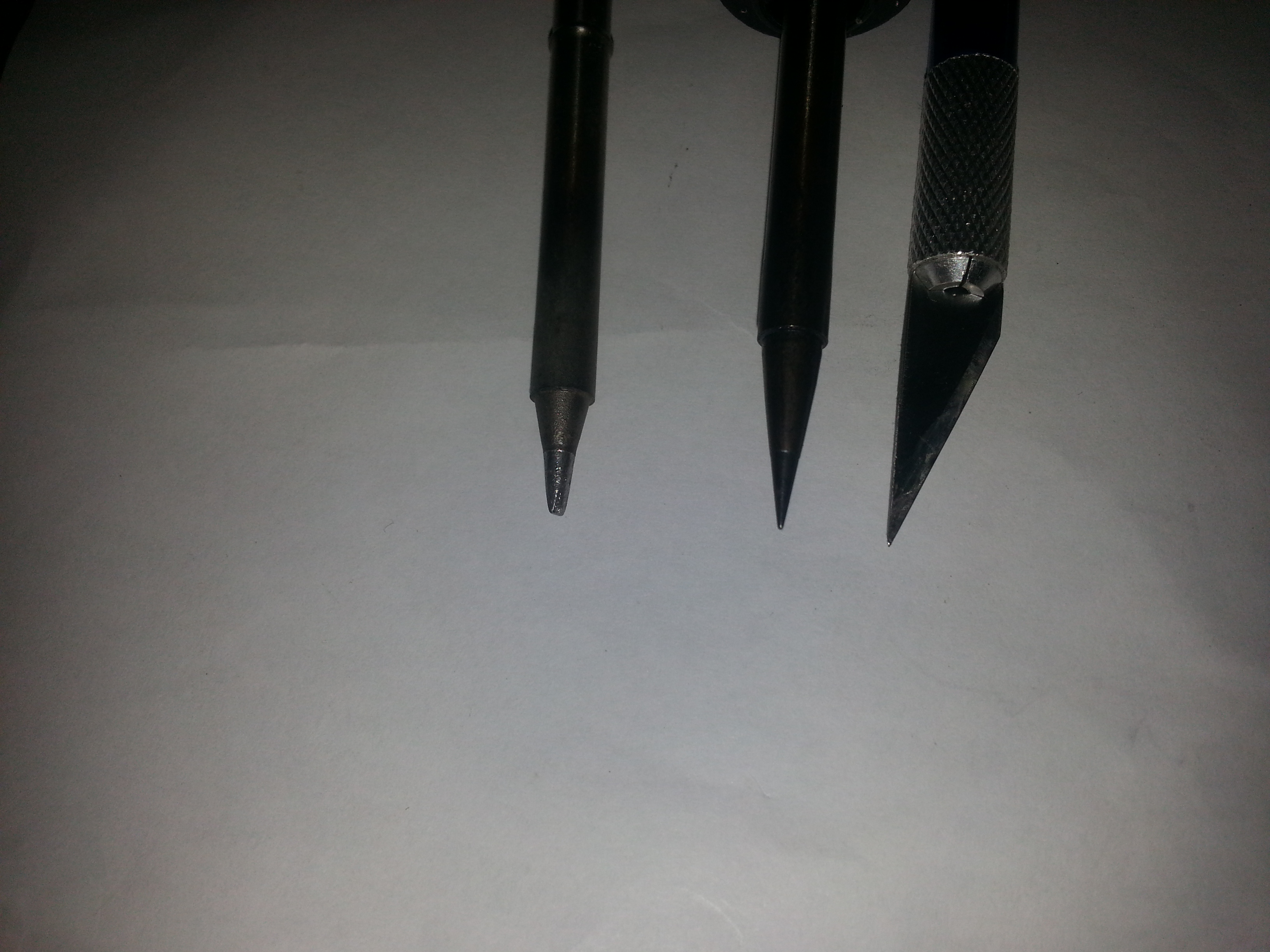

It's the same cap, I was able to heat the pad and flow it back without issue. But I used an extremely small tip.
I purchased two boards with one being defective and replaced. The replacement was received with the cap rattling in the box. Decided to repair it myself and never do business with them again.
Exacto for comparison.
