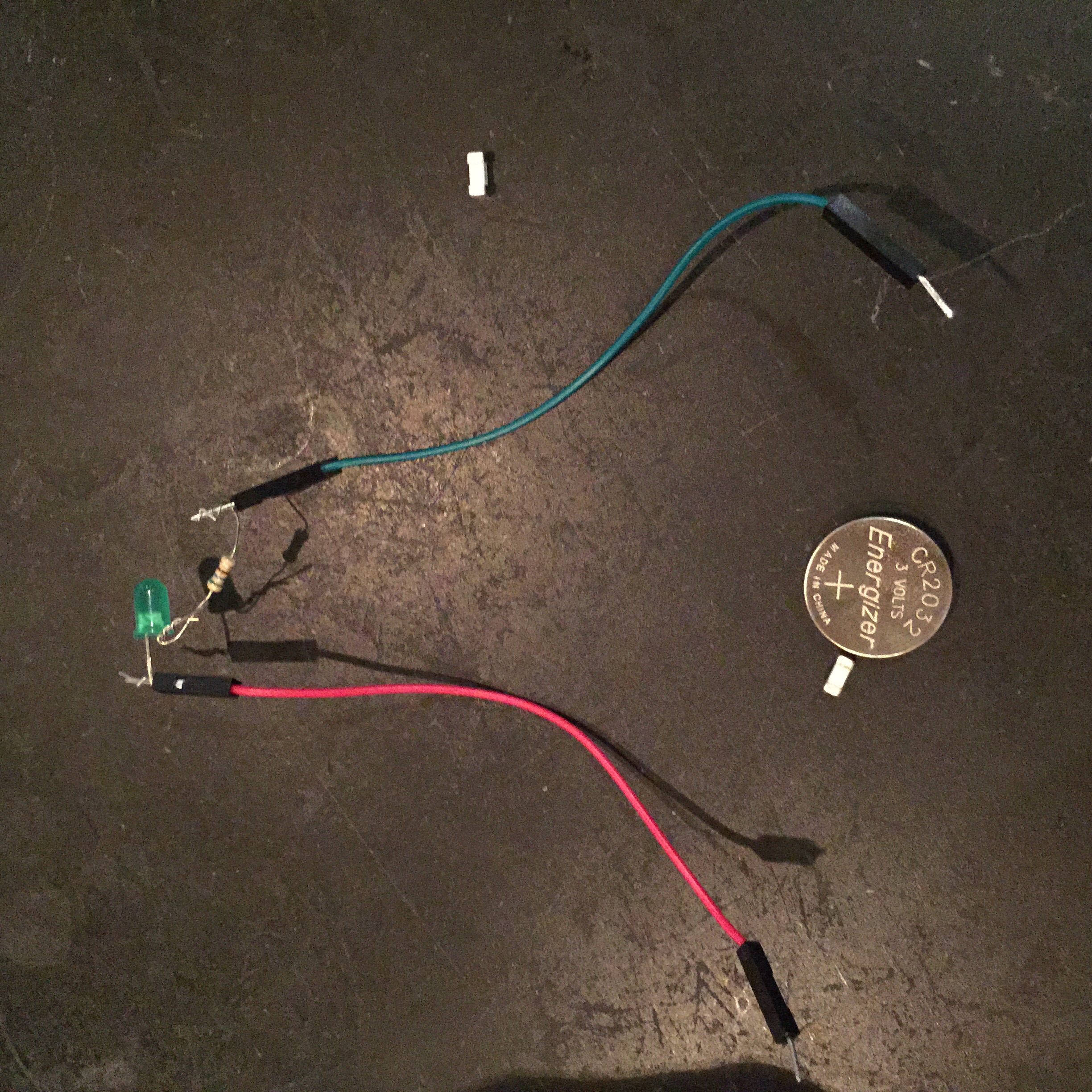

Thank you. That's exactly what it was. Swapped it for f2 to verify. Tested it with impromptu continuity tester. Jeff bezos is hustling to send me some more littlefuses tomorrow. Apparently he's got a bunch of stuff and is real dead set of getting me everything I need asap.
