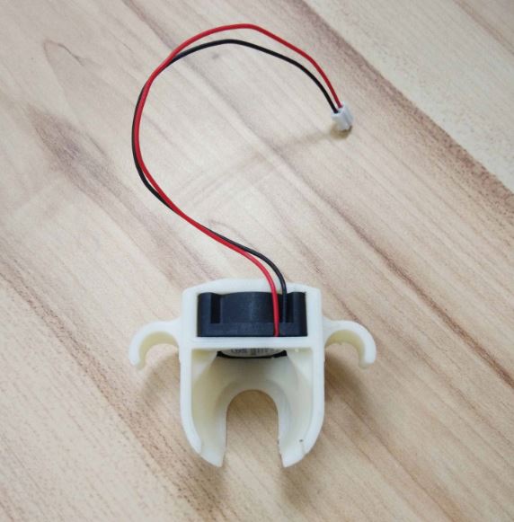

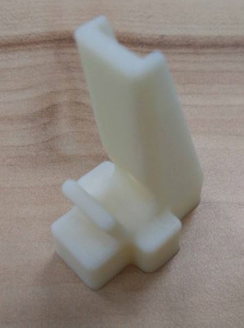

It's 3 weeks already and finally the build is completed. Managed to print the peek and layer fan holders. Glitches along the way.

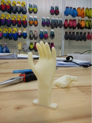

The completed build First print Second Third
Re: Hi from Malaysia
Looks great!  The layer fan shroud you printed was the wrong one - that one is for the older v1 effector platform.  You want this one: http://repables.com/r/212/
OK, but will not fix the layer fans, most likely will run only ABS material for now. I did not try to install it so I was not aware it was the wrong one. TQ
