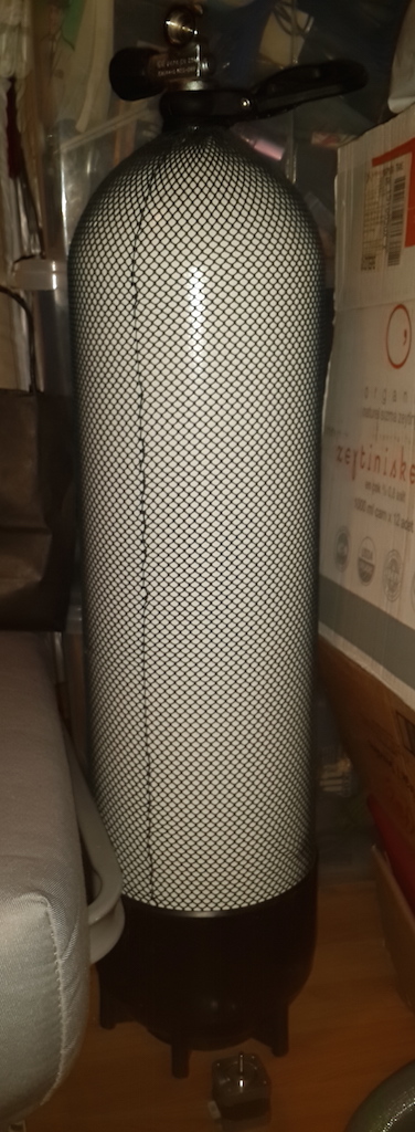

I also have a bit of experience with scuba diving.
If you already have the tanks etc and dive regularly, it can be done. With a small needle valve you can adjust the flowrate.
A normal scuba tank holds about 2000l of air. My biggest tank holds 4000 and my twinset holds 7200 liter of air.
The pump claims to be rated at 2l/minute.
So 1000 - 2000 and 7200 hours of print time depending on which tank or tanks i use.
Ps anything but the small ome is not fun to haul around.
teoman
Posts: 1770
Re: BerdAir comeing soon From Yellow Jacket Concepts
Post by teoman »
Here is a picture of the large tank, it has a water capacity of 20L, when pumped up to 200bars that makes 4000L of air. I put a stepper motor on the floor for size comparison.
What would be awesome is, if you made a small adapter on the bowden tube close to the nozzle and some kind of seal or gasket on top for the filament and then used the bowden tube to transfer down the air.
