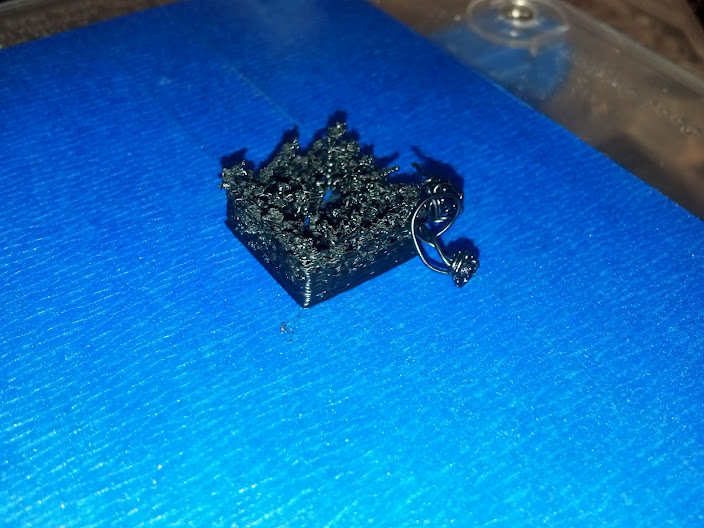

First ever print looked like this:
After that I figured out that the extruder pinch rollers weren't tight enough and they were slipping.

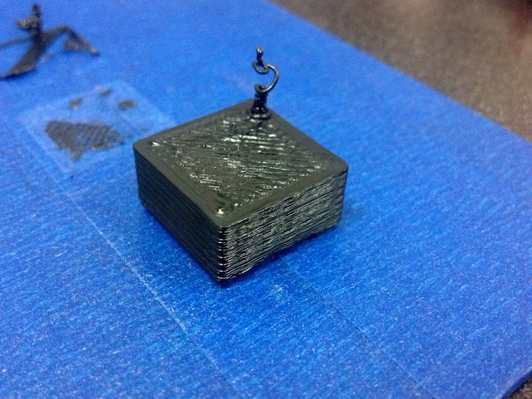

I tightened them up and ran it again.
Not bad. Not bad at all.
But wait... That was supposed to be a 20mm cube.
It came out 20x20x10. I'm assuming I have my steps/mm wrong for the Z-axis.

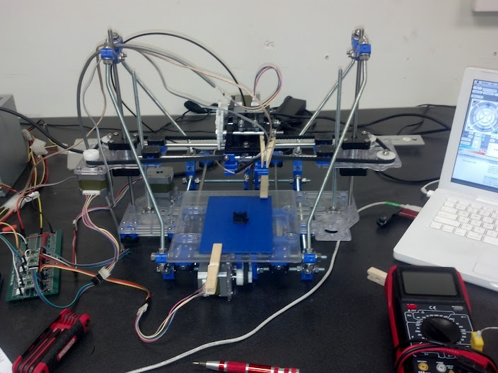

And here's the machine:
Wiring is hanging all over, electronics aren't enclosed, no endstops...
Lots to do yet, but IT PRINTS!

Its beautiful! Yes, your z steps per need doubled if it only came out half scale. Double check the file to be sure it is 20mm not 10.
Posts: 2417
Location: Redmond WA
Re: First Prints
Post by Polygonhell »
The "standard" 20mm test cube is 20x20x10.

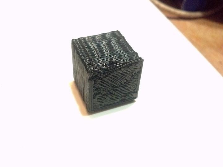

The waviness in the face I have on top in this photo bothers me. I have no idea where thats coming from.
That was the front face, as it was printing. The sides and rear faces do not show that same wavy pattern.
This print has terrible skew in the +X direction, but it's not every layer. It looks like every other layer got skewed.
Stepper current too low? Feed rate too high?
The weird thing is, after I printed this, I printed the cube without changing any settings.
Posts: 2417
Re: First Prints
Waviness is usually a pulley or idlers that's off center, so the length of the belt is effectively changing as it moves along the axis.
It can also be caused by depositing too much filament, though that's generally less regular than your picture.

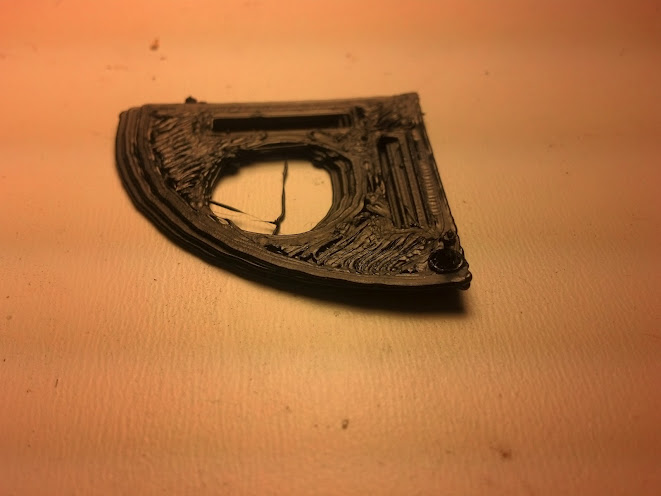

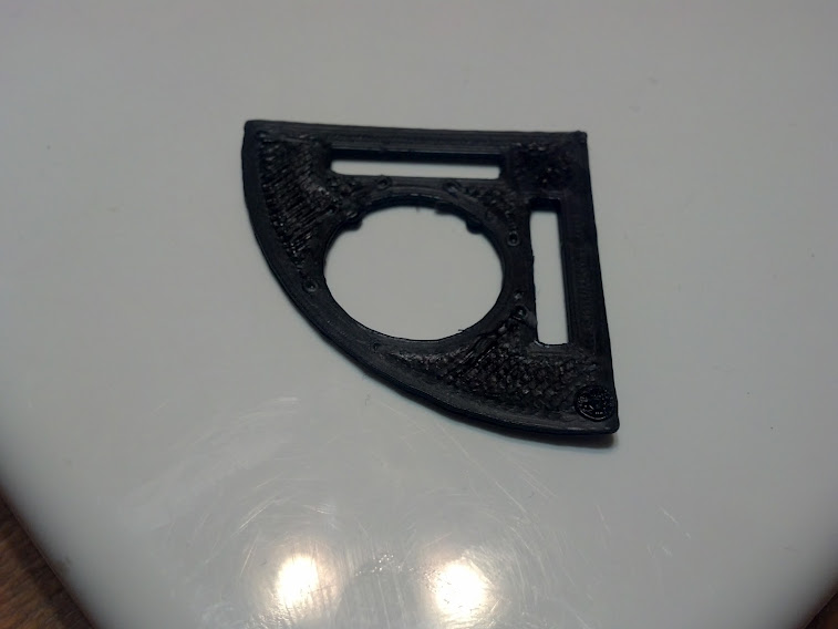

I finally measured my motor drive current. I was only driving about 100 mA per phase. Knowing that, I'm surprised it worked as well as it did. I turned the current up and printed the nickel calibration again. It looks much better now, but the nickel doesn't fit and there's some extra blobbies. I don't have my extruder calibrated properly, yet. I'm pretty sure I'm over-extruding. I also need to play with my retract settings in Slic3r.
